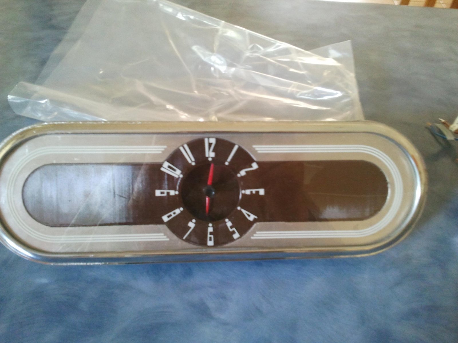

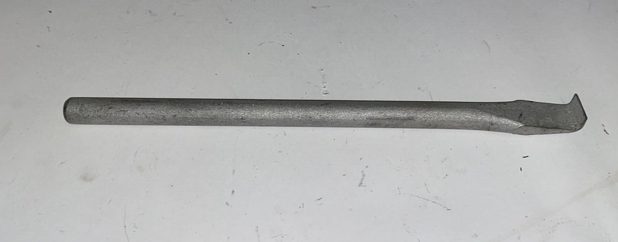

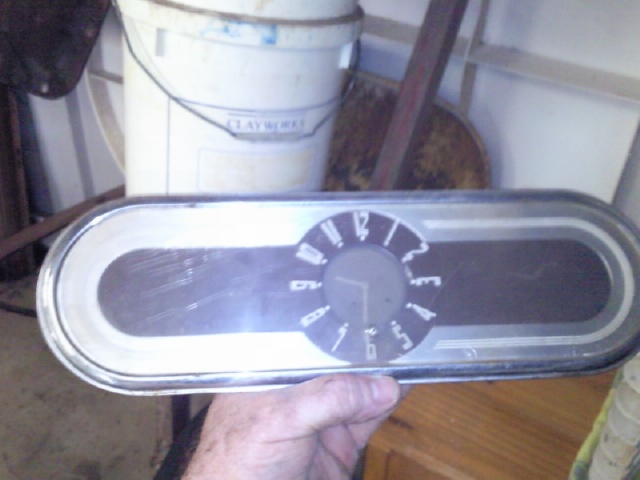

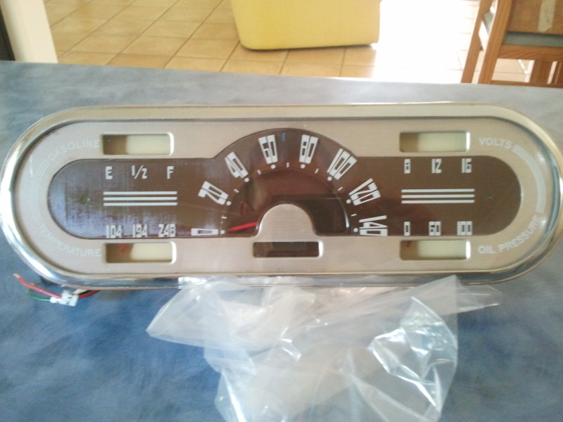

    I haven't done this to hubcaps however I did the instrument cluster and glove box lid on my 46 Olds as the chrome outside trim on the face is rolled over in a similar fashion. I used an old narrow hubcap removal tool (1/2" diameter rod) and wedged it slowly in between the inner and outer layer, tapping it around the entire cir***ference with a soft mallet slowly opening up an even gap as I went. The parts were laid up on a thick soft blanket, eventually separating the inner and outer. I then hammered the edge to remove any imperfections allowing it to slip back over inner core with some minor effort. After outside trims were rechromed they were fitted over the modified cores with lip slowly worked down using wooden dowel along the lip compressing it and pinching the inner and outer together as per OEM. From memory I may have used a soft wooden pine block on the face and finished the lip with a soft mallet. I worked the lip and didn't damage the rechromed trims. Patience and not a lot of force is the key
