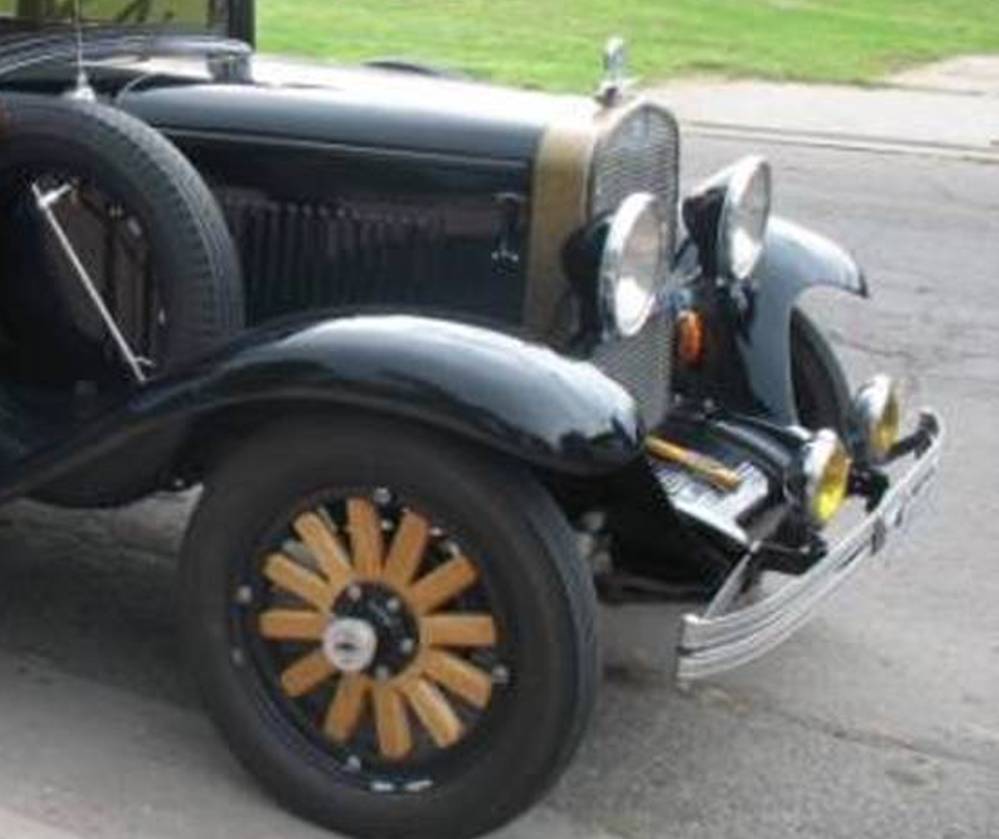

    My wheels flex, but I don't have the problem with my caps coming loose, they thread on. :D
