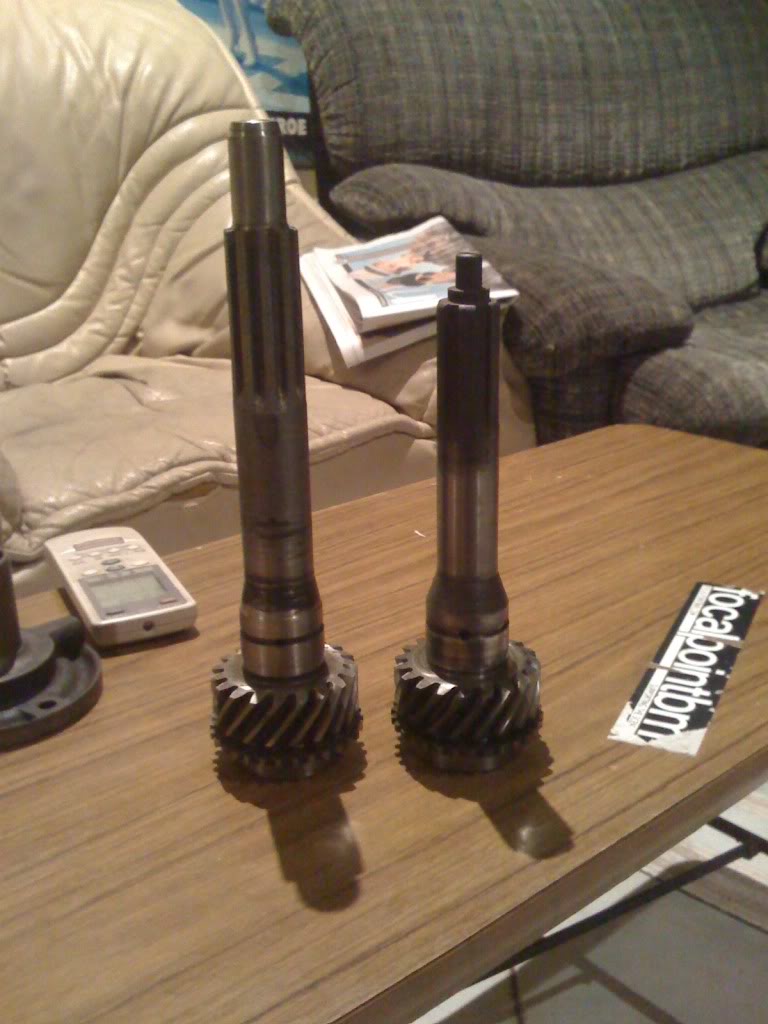

  3. i have gone to the effort of getting a 55-56 input shaft machined to suit the stepdown bellhousing length into a 55-56 crank. the stepdown shafts are much shorter due to the pilot bearing being set in the flywheel rather than a bush in the cranks like 55-56. i am yet to find out if all the effort was worth it yet, my engine is yet to be completed.
    also here is a photo of the deeper relief used on the 55-56 blocks. the stock 308 head on these is much closer in chamber size to a 262 or 232 chamber from 51-54. i have the oversized valves and a bit of extra work in the reliefs to open up the transfer slot allowing better flow with an iron 232 head.
