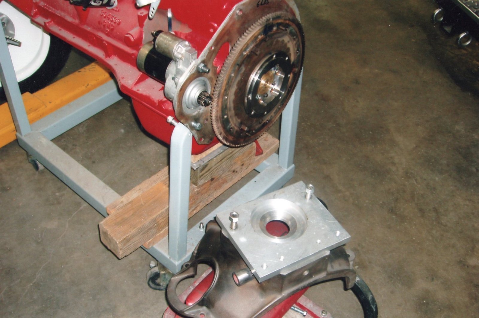

    308 bored .060. Edmunds head and intake. Vertex magnet img199.jpg img198.jpg img197.jpg img196.jpg o. Isky cam. Quartermaster 2 disc clutch, 37 Packard trans. 48 Ford front susp. 16-1 Corvette steering. Landrum 125 lbs leaf springs. My own custom built quckchange. 9" mini spool. F1oo axles. Aluminum grille shell. Aluminum radiator. *** FOR SALE*** I just turned 89 years old. I have 25 vehicles in my collection. So much time spent collecting and building some really GREAT parts. I am giving this car away. $25,000.00. Cheaper if it goes to a good home. Not some retard that has ideas of his own what to change.

    we want to see LOTS more about that quickchange!!

    Using a a 35-48 Ford car banjo turned backwards and up side down. I made a fixture off a Halibrand 201 Trans sprint 032.jpg Trans sprint 033.jpg Trans sprint 034.jpg to install the front bearing retainer. Wood pattern to cast the extension. I built 5. Sold 2. Have 3 in my cars. Sold fixtures. He is in over his head. Never built any.
