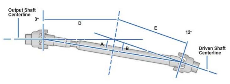

  14. Almostdone
    Joined: Dec 19, 2019
    Posts: 992
    Almostdone
    Unless I’m missing something, I believe driveshaft angle is important, because it plays into overall u-joint angle at each end. For example, look at the difference in figures 6 and 7 of the the Inland Empire link posted earlier. Here is another link I find useful, but beware it lists all angles as positive https://****erparts.com/calculators/driveline-operating-angle-calculator
    T
    here was a thread about this not too long ago that got everyone all frothed up. Not looking for that here, just making sure I’ve got it right and the OP will too.

  20. Ebbsspeed
    Joined: Nov 11, 2005
    Posts: 6,498
    Ebbsspeed
    In a "W" configuration you can have two "down" angles. In a vehicle with a very low mounted engine/transmission this is sometimes necessary.
