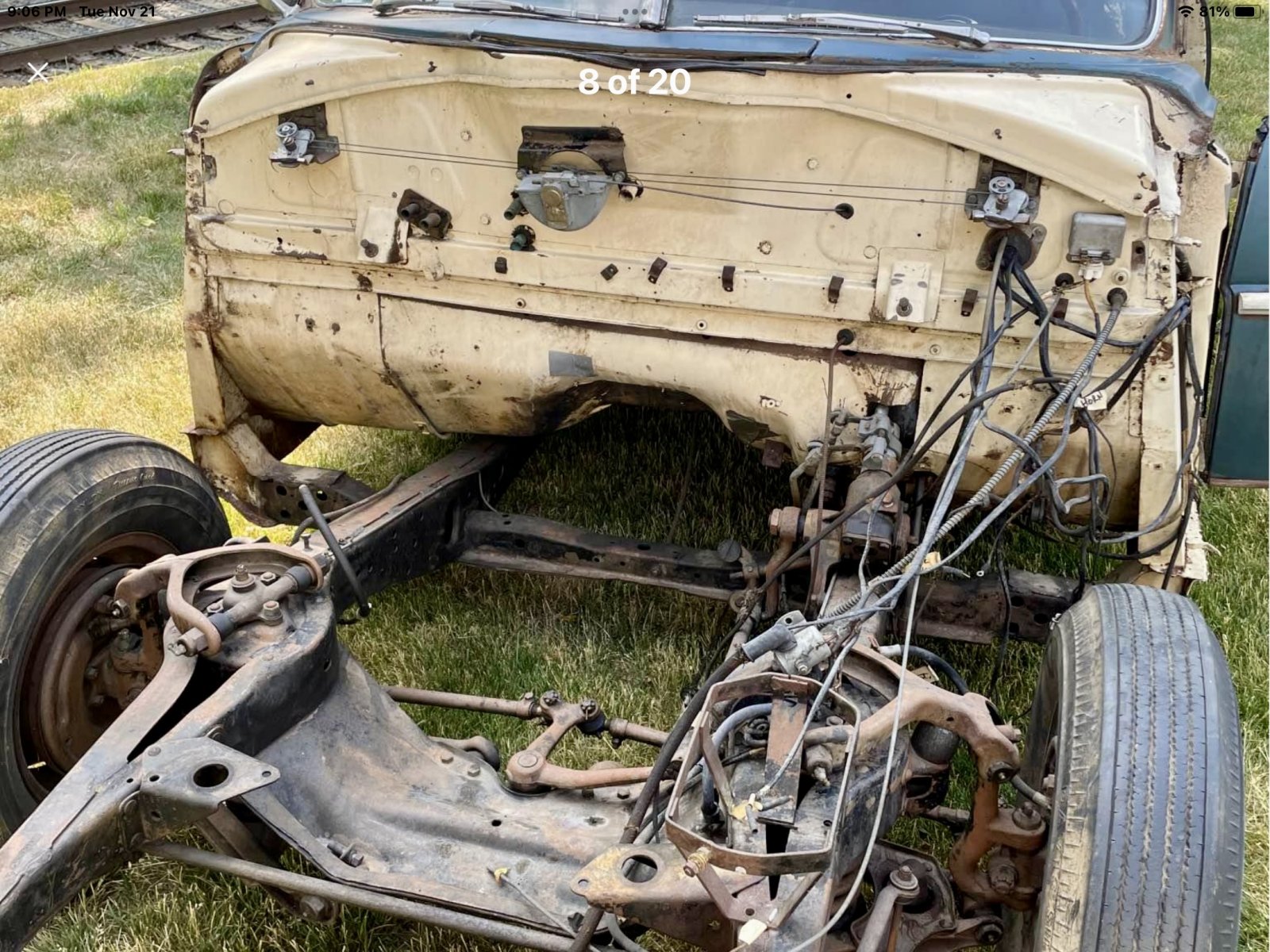

    I'm having my Hudson 308 inline six rebuilt and in the meantime I'm looking for a motor that will fit. My brother has a Clifford products built Ford 200 inline six that I'm wondering if it will clear the steering mechanism of the Hudson. I've read in previous posts that guys have had success dropping in the Ford 300 inline six, would this 200 have a similarly configured oil pan-

    Pan sump is sorta in the middle, pics would show diff.
