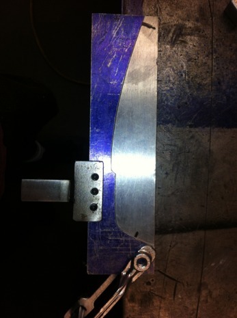

    So with less than two weeks to Santa Maria I thought I would bust out some new rocker panels and skirts. The stock rockers and all the trim are **** ugly for a Kustom. So here's the start of me making some dies for the pullmax.

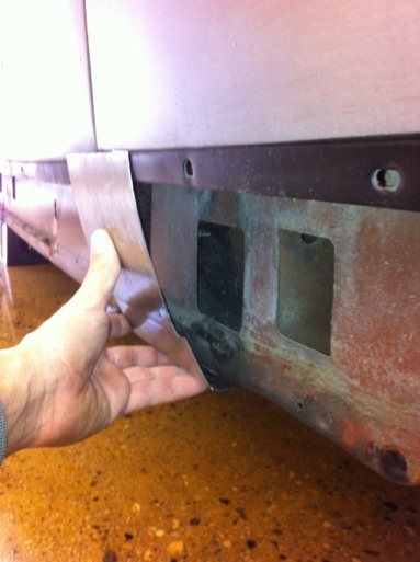

    Here's the ****py looking profile of the stock rockers and all the clip retainers for the three trims that went on it. See ya *****es

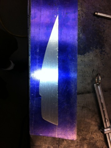

    Pic on the left is a sample I ran through the pullmax and the others show the new profile and fit to the frame. Yup that's the frame it's gunna attach to on the bottom.

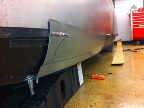

    Well I got the dies fine tuned this afternoon down at Bluecollar. I also made patterns off the stock skirts and off the stock rocker panel "see pics" ran both skirts thru the pullmax so they're roughed out. Gotta go home and fine tune the rocker pattern on the car to limit the amount of s**** metal I make. So far I made three skirts to get one-learning curve!!

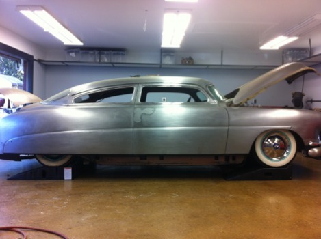

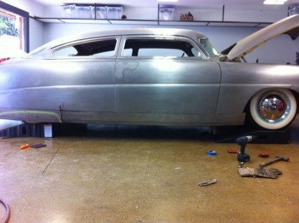

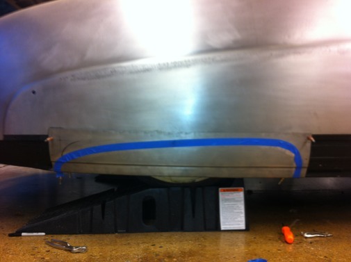

    Ok so I got some work done. I got some card stock attached it to the frame put the old rocker over it then marked both the rocker side and the frame side. This allowed me to fine tune the radius of the bottom of the rocker. This pattern was cut and will lay on a 4x10 sheet of 18 gauge AKDQ. I will make two off the pattern cutting then as close to the radius as possible clico them together and sand the sand the edges to make a perfect match. This is key because the pullmax die is made like a fence on table saw the radius of the rocker follows the edge of the panel.
    I got the pattern done and off I also put the skirt I made today on with some clico's and stood back. I moved the rear bumper back a while ago so this affects the length and radius the rocker panel in the back. This also gave me a chance to "really" look at the skirt opening. So I tweaked out on blue tape I think this looks way better than the box looking old opening. It matches the style line of the quarter panel. Matching lines always work.
    Weigh in on this wheel opening-I am looking for some input!!
    Check out the pics.

  20. hudsoncustom
    Joined: Oct 26, 2001
    Posts: 4,129
    hudsoncustom
    Nice progress. I also agree that the stock "box" rear wheel opening doesn't work...it just doesn't have a finished look.
    I do like the shape you're putting in the wheel opening, slanting it to match the fender body line works.
    Are you planning on running a skirt, or are you running skirtless with re-shaped openings?
    I think the only thing you might want to play with is the wheel opening height. Am I looking at the top edge of the tape, or the bottom edge? It almost looks a bit too low in these pics, but I'm looking at the bottom edge of the tape I guess. The *** end is pretty visually heavy on these cars, and lowering the wheel opening might make it look a bit heavier.
    I think the shape is spot on, perhaps play with the height a bit?
  21. hudsoncustom
    Posts: 4,129
    hudsoncustom
    Ok, looked at the pics again...you're obviously looking at the top edge of the tape. I think that looks great!
    So, fender skirts or no fender skirts?
  22. studhud
    Joined: Jan 6, 2006
    Posts: 1,403
    studhud
    Skirts! And I might cheat the tape up a 1/4" keep in mind thats about where the stock opening and subframe are and I'm not interested in cutting into that subframe box section.

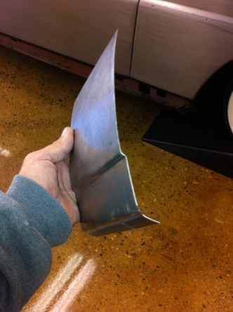

  30. studhud
    Joined: Jan 6, 2006
    Posts: 1,403
    studhud
    Got the loonnnggg parts made up in the process of making them fit using the shrinker.
