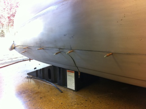

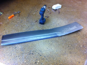

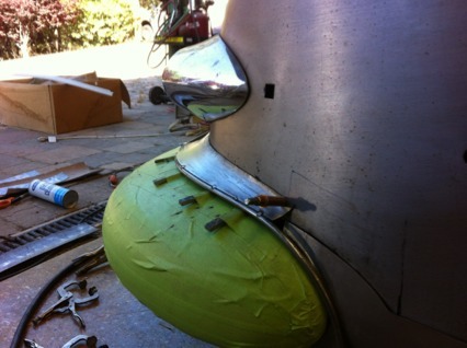

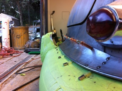

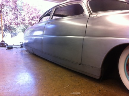

    First two pics kinda show how they come out of the pullmax because of the curve on the bottom edge they come out curved the wrong way see the first two pics. Using the shrinker I got it curving the right way see the fender skirt in the second pic. The last pic shows what the door will be like I'm going to add two inches to the bottom of door.

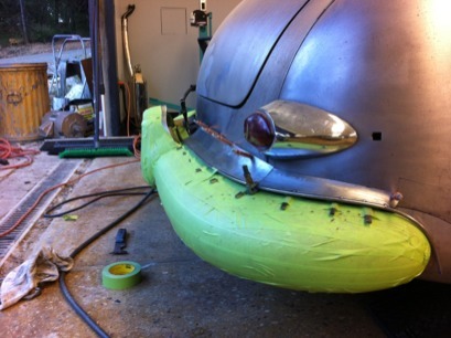

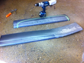

    Ok what a *****!

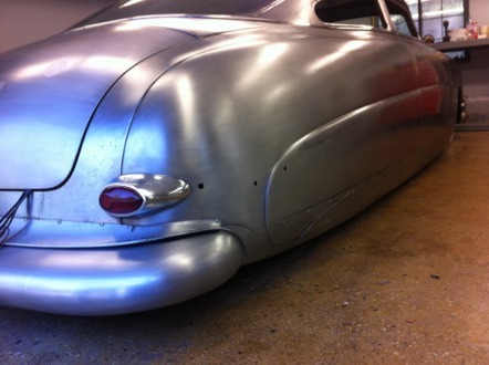

    I got the rear panel made it was combination pullmax as seen the other pics ten a bead roller to taper out the body line (it gets smaller as it comes around the corner and ties to the stock body line). Then e wheel to get an increasing radius part way thru the skirt to the back. Got the skirt rough cut to shape now time to do the other side:(

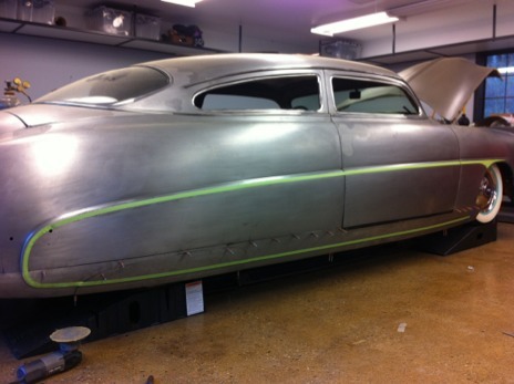

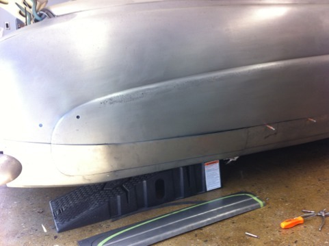

    Hey James remember that photo shop you did for me??? These pics show some mock up tape of the trim I think I might go thinner than the tape but this is my refined version!

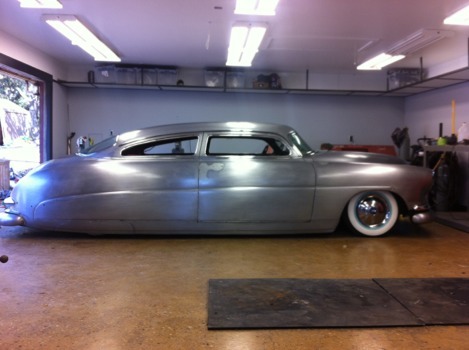

    Got done what I could time to head to Santa Maria
