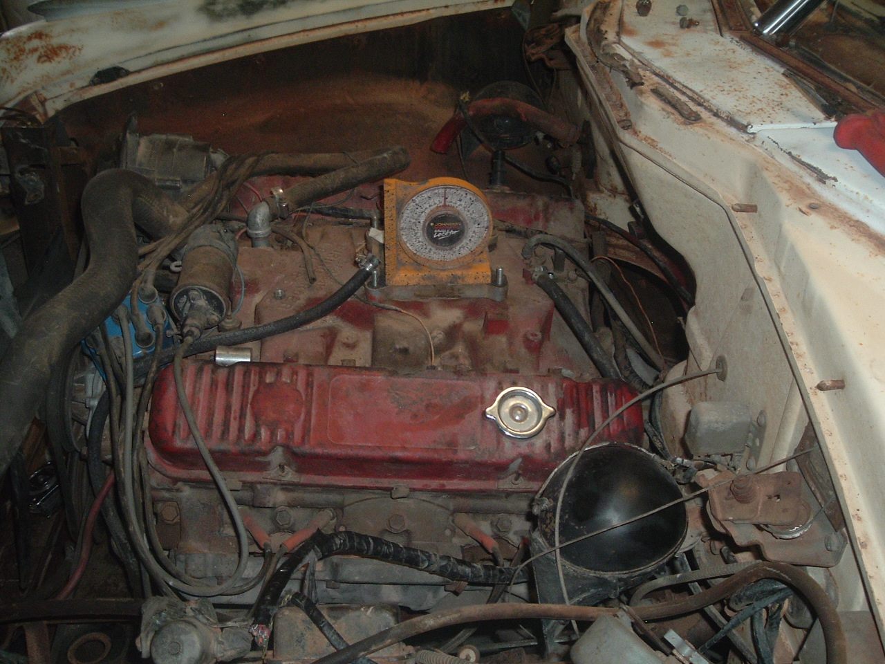

  5. Here's a few pictures of the buick 430 I am putting in my wasp, I say do it!

    How is the fitment around the steering? Do you have any pics of that area?
  7. I will take a few for you tomorrow and post them, I offset the engine to the p***enger side just a bit.

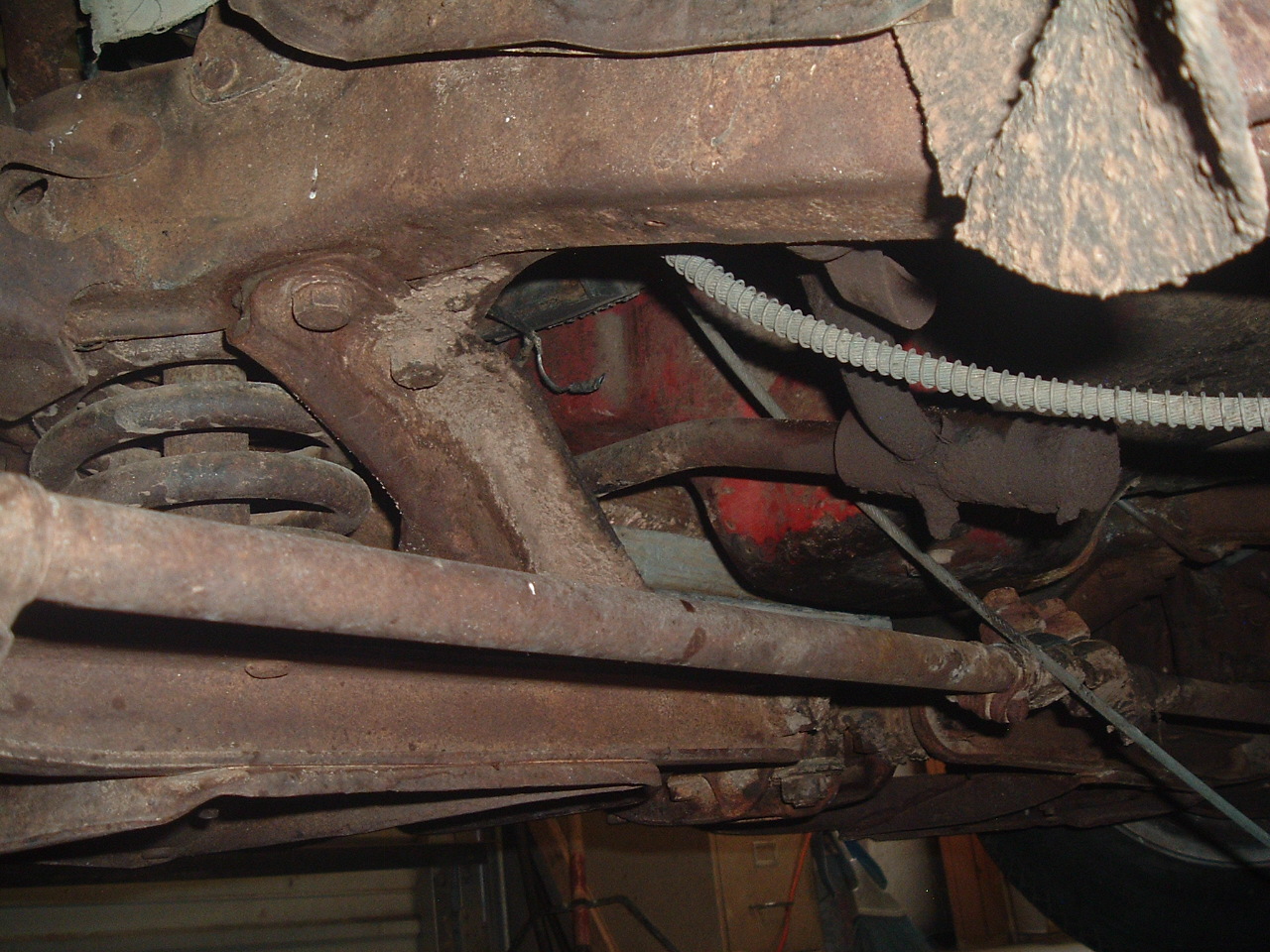

  13. raidmagic
    Joined: Dec 10, 2007
    Posts: 1,440
    raidmagic
    Damaged Duck, that is one area of concern but not much. Nothing a custom oil pan won't take care of. It appears to have more room in the steering box area than I thought or than it look like looking at the car. Thanks for those pics. Can you take some measurements for me? I'd like to have some baselines to do some figuring before I pull the car apart. This way I can still drive and enjoy it while I'm plotting and planning. Thanks.

  14. gimpyshotrods
    Joined: May 20, 2009
    Posts: 24,585
    gimpyshotrods
    Center steer Cavalier rack? Its tie rod attachments are about as far apart as the current tie rod.
    With an offset plate, to correct geometry:
    You can hold the pump that drives them (Saginaw TC, aka Type II), in one hand, minus the reservoir. Easy to mount.
    Just a thought.

  15. raidmagic
    Posts: 1,440
    raidmagic
    Well that's interesting, is that your car? What year Cavalier? Did you make all the mounts?
  16. gimpyshotrods
    Posts: 24,585
    gimpyshotrods
    Not my car, but I have done a few for customers. The geometry issues in most cars make for some bump-steer issues, but, in your case, it appears to be a better application for this rack than most. The offset plate can be made to correct the geometry (put the new tie-rod pivots exactly where the old ones were), and adapt conventional tie rod ends, as the stock Cavalier inner ones are weird.
    The only thing I can't confirm for you, are any oil pan clearance issues.
    The rack is circa 1989.

  18. raidmagic
    Posts: 1,440
    raidmagic
    Yes that was my concern but seeing these picks plus another site there is a guy with a big block in his so I'm not as concerned now. I'm going to video mine running so I can sell the current engine if I so chose and pull it apart so I can get on with my project. Thanks for the input

    Looks good. How did this work out for you? I'm looking at a 430 myself for my Hudson hack. How was your exhaust clearance? The pan looks like it wasn't too bad. Those 430s really put out.
