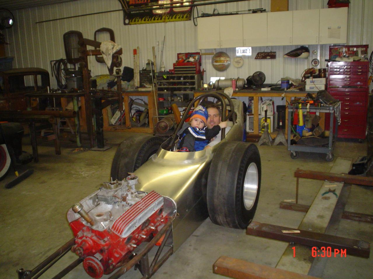

  2. Wow ! That is a pretty nice car! RE steering. TIs mostly for in the pits and staging lanes. My own belief is too fast a steering wil get you in trouble. Minor corrections is really all you make on a p***. Point & shoot is how I do it.

    If you have an SPE/Strange/Flaming River steering box with the stock pitman arm (5") and SPE/Strange/Stiletto spindles with the 5" arms, a 1 to 1 ratio bellcrank should work OK. The McKinney bellcrank that he used to use in his funny cars is actually 6" on the drag link side and 5" where the tie rods attach so it has a bit of ratio built in to slow the steering down some. I used to use a bellcrank but now I just go straight to the spindle. If you are running more than 20 degrees caster the bellcrank does help although Brendan Murry's NT/F car runs 30 degrees without a bellcrank.

    Yep. It was my first chute pack body, not really as hard as you would think. I learned alot and look forward to doing another sometime. I drew alot of inspiration from the Ghost, love that car. I made the chute opening quite a bit higher than the Ghost's to try and make my 5 point cage appear a little smaller.
