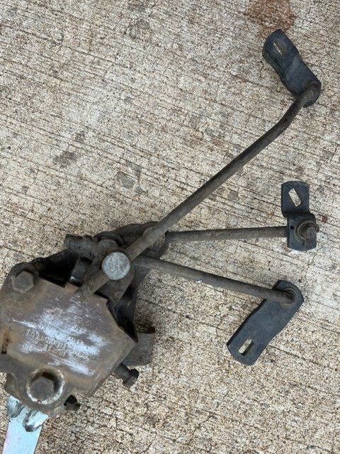

    Hurst Competition Plus Shifter # 587501 and #2083 Identification , Can anyone help me ID the application for this shifter? i am been pounding around and cant seem to come up with anything.. Numbers on the brackets mounting to the transmission are 2442 & 2440 & 1052441. Mounting plate is 5257

    Older for sure attaches to the case at the tailshaft housing. Might be for a 62-up Ford…

    The 2083 # is the case part #. The application numbers are 7 number's, starting with 391. Try to find those numbers and go to shifterdoc.com. I just went thru this recently and was able to Identify mine. The levers are the stud and nut style, pre '68.

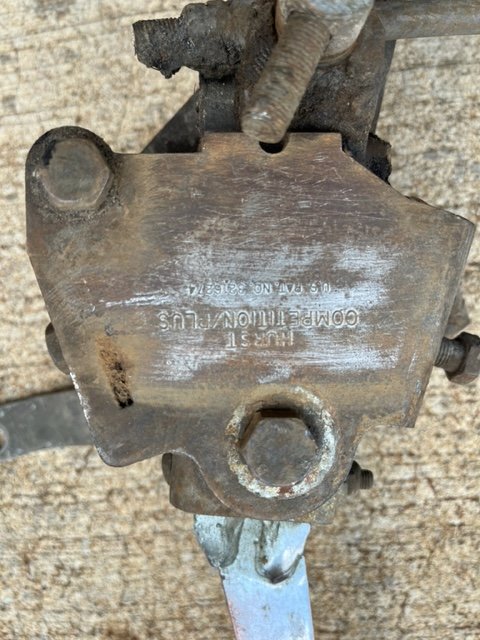

  5. That patent # was issued 11-9-65.

    So, making my memory go back a few months- The 2083 is the basic comp plus shifter with the stop adjuster bolts. The mount has the part numbers for the specific trans mounting and car application. If its a hurst mount it should have a part number. It would definitely be for a trans with no mounting holes on the tailshaft.

    Best guess would be a toploader ford. The rods and levers are close together like the old ford. Weird mount, really far forward. maybe someone made it for a custom application?

    There SHOULD be a number on the shifter housing between upper mount bolt hole and the lower mount bolt hole. That number should tell you the application of the shifter. It is at least 4 digits lon if you can't decode it, I have an old 1995 Hurst and can possibly decode it for you.

    # 587501 and #2083 are the numbers on the shifter housing

    The shifter, rods and levers look early top loader Falcon (could be T10) to me, but I don't recognize the mounting parts at all.

    Its not Falcon T10, I dug mine out, it looks like the same shifter but the rods and arms are different. Still could be top loader. My top loader mounting bracket looks nothing like what you have though.

    Have you tried lining up the linkage and measuring it? Put a 1/4” rod, or even a drill bit in the shifter to set the levers at neutral and post what you find, you might get an answer that way. Part numbers aren’t helping, maybe measurements will.
