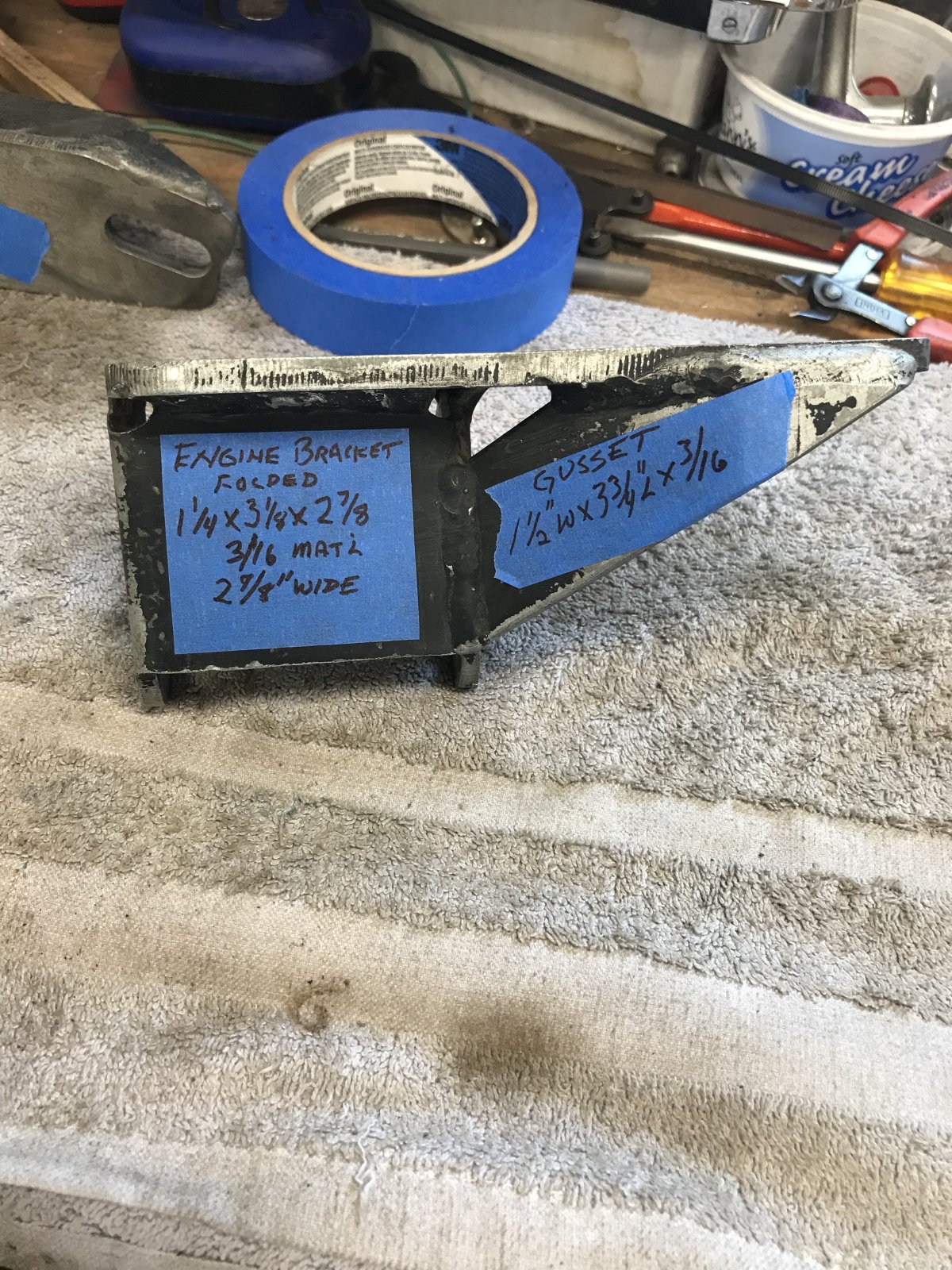

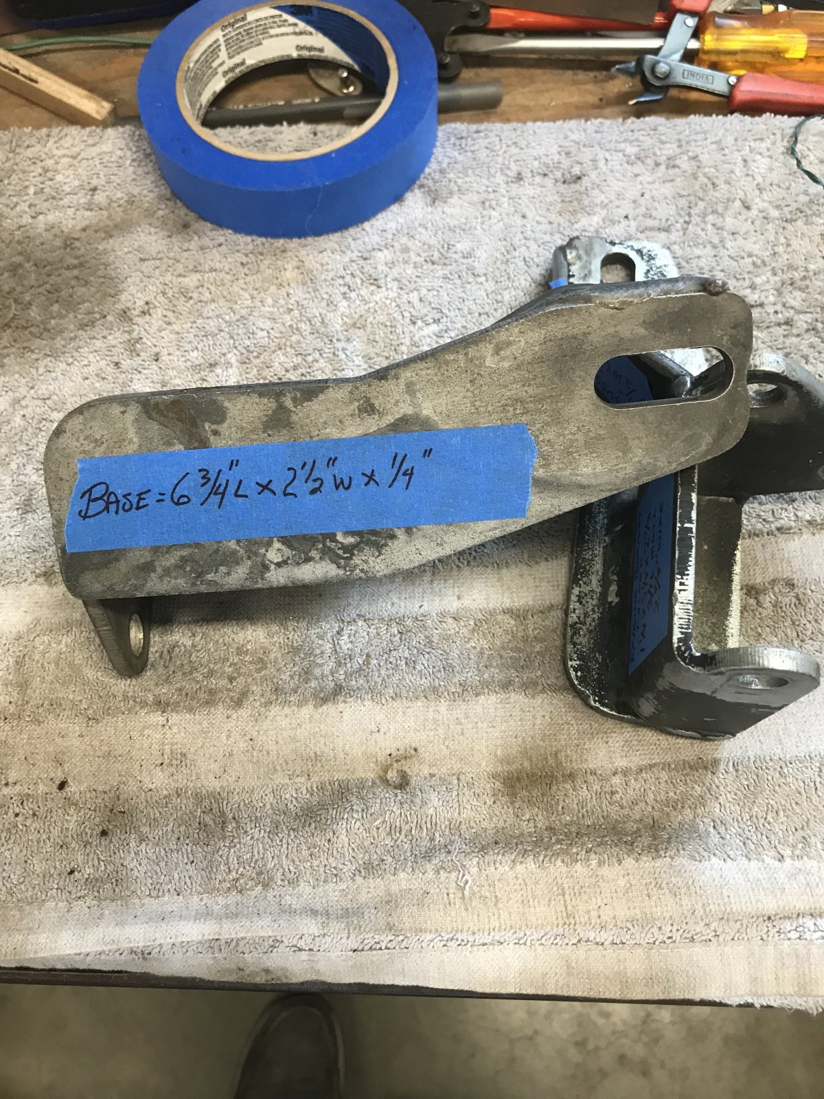

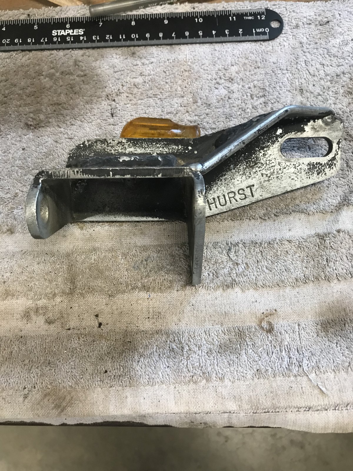

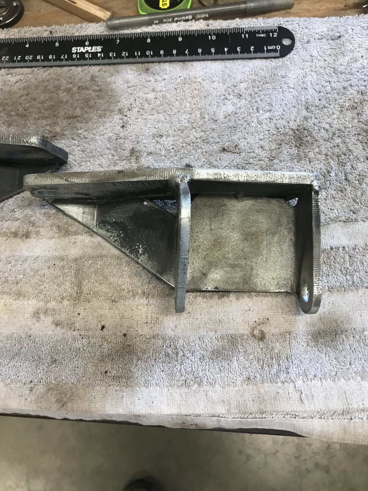

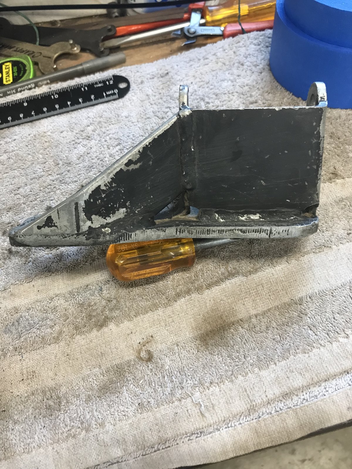

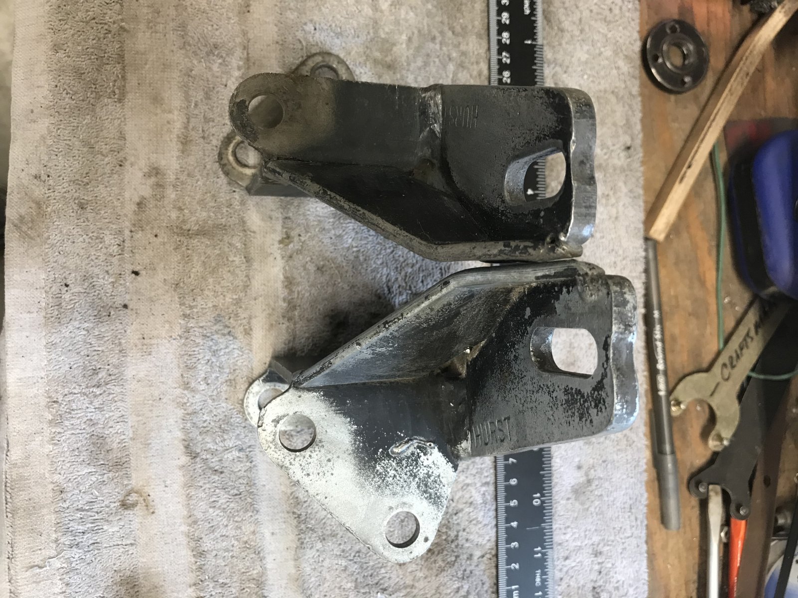

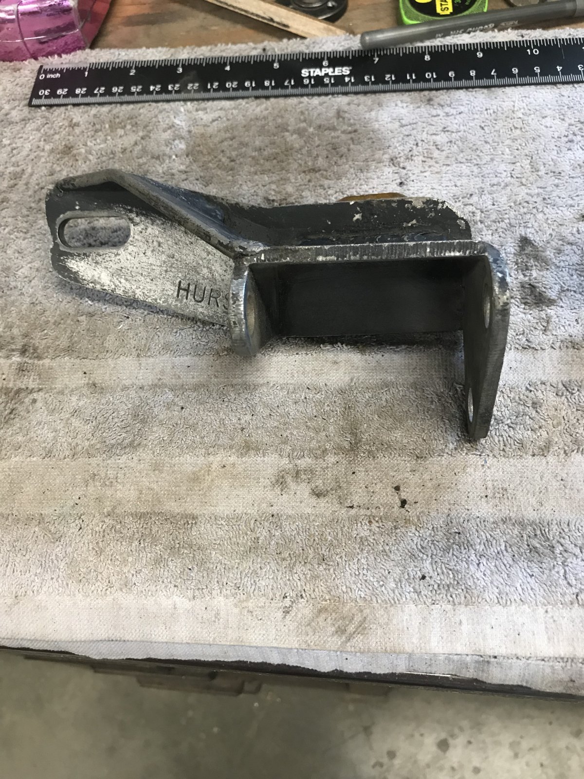

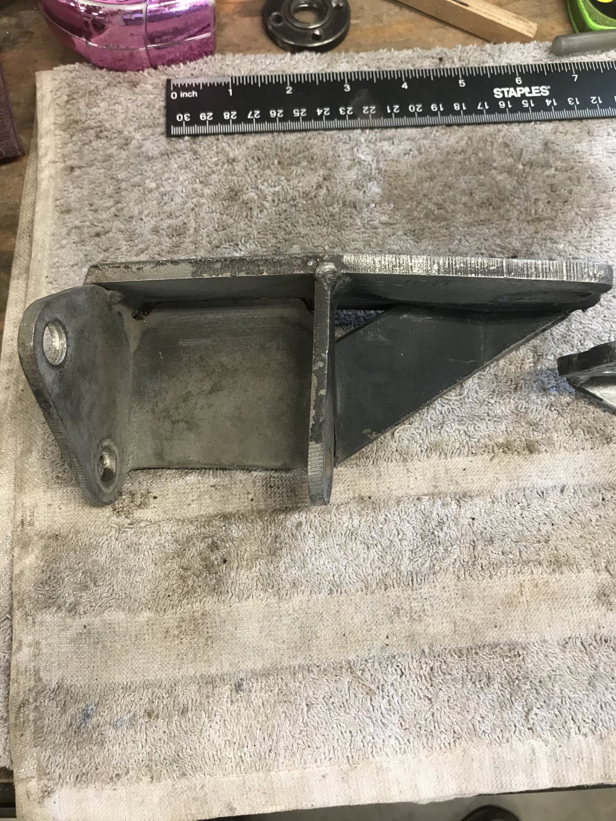

    Here’s some photos to get you started. I’m posting them here instead of PM in case others need to see them.
    C8B5E6B4-3E5D-4B91-BBDA-9A18F6586011.jpeg C524C38A-3631-4791-A43B-DDA918ECDF07.jpeg FE723F40-8CD0-4168-A564-557C5CA98923.jpeg 3A383899-4373-4AE7-BA0C-DB7C09F0DD29.jpeg 94C005E6-76B2-498D-B41E-8D693E102C36.jpeg A10573EF-7C48-4EE6-A99D-736E50DA77C5.jpeg 4D0ADEDE-9DE6-4614-A3D7-F45174E8ACCF.jpeg
    Jeff Norwell likes this.

    And here’s the material cut sizes.
    5B858F9B-6E33-49B9-94F5-6AAD030A2CE8.jpeg 97914397-2F35-4C92-A04D-EB33749021FF.jpeg

    WOW! That's all I could ask for and more!:cool: The only thing I will do differently is not drill the holes for the front mounts until I drop the completed ***embly on the frame. I think a single properly located hole would be better than the long slots. I never liked those and this is a way to do away with them.
    Thanks again. I owe you big time!:)
