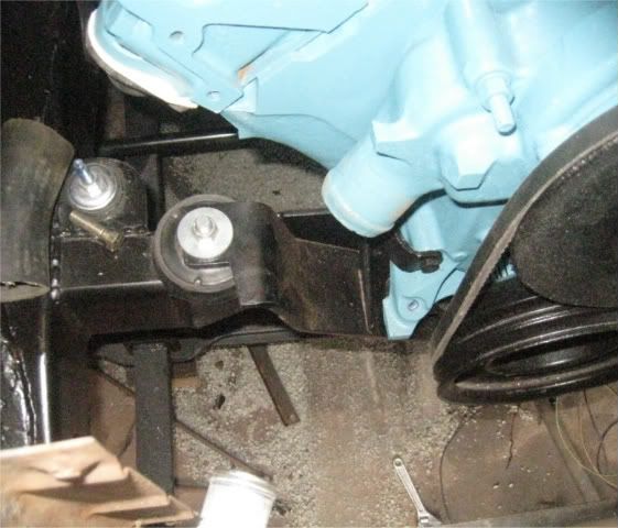

    I've having some issues trying to find a hose to fit what I need. The mount is right in the way for a normal looking hose. What type of pipe would be suited to get a couple of the hard bends done ? I could run some exhuast pipe for now but that really doesn't sound like a long term deal. Maybe some thicker tubing or sweat some copper together?

    It's not just the bend at the pump , the other 2 sharp (90 degree) bends needed once it clears the mount. It has to drop after the mount than bend back again to the radiator. I thought putting a pipe in would make the plumbing in easier? Maybe my pics don't really show how awkward the bends need to be

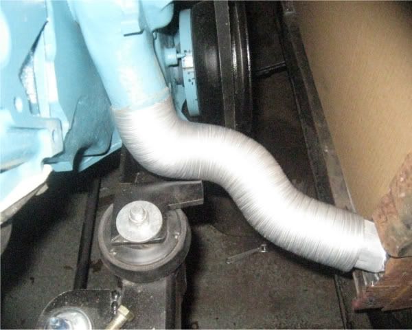

    Well i'm trying a little differant approach instead of guessing what I need, I had some preheater tube and fitted it and we'll see if I have any luck at the parts store again, it's not as bad as I thought. Maybe 1 piece or find 2 pieces and join them together with some pipe?
