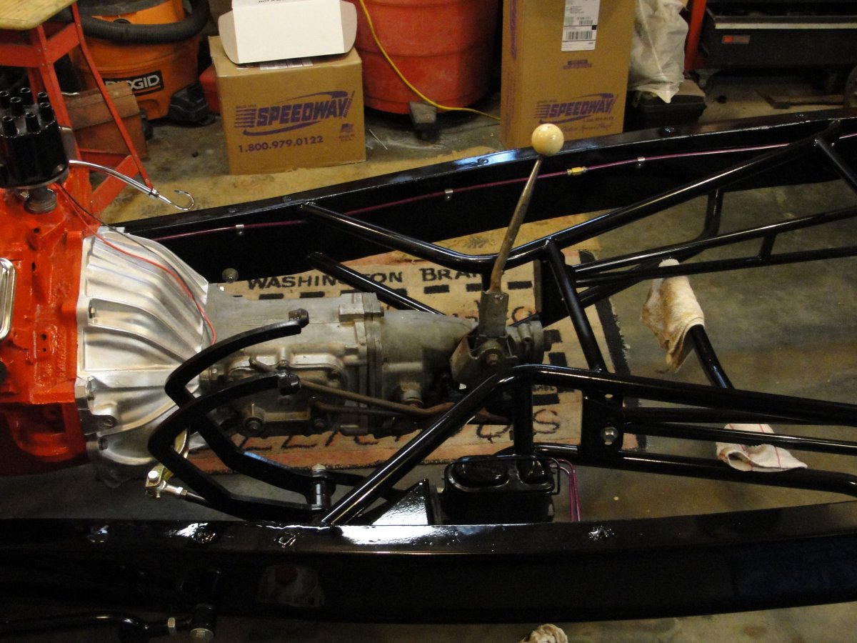

    Like this?[​IMG]
    WB69, Just Gary and vtx1800 like this.

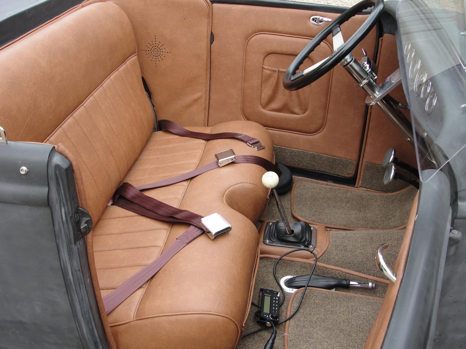

    I used one designated for a '65 Chevelle. It was the one the put it as far forward and close to the center that I could find. I did have to heat and bend the arm down below the boot area to bend it more towards the center. I have bucket seats, but they touch so it's basically the same as having a bench. This is the only pic I have of it offhand.

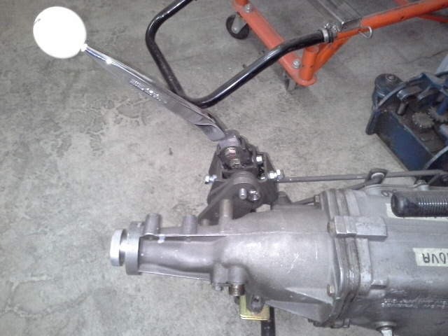

    Here is a little trick a friend showed me, it may work on your deuce if required.
    I did a fair amount of fiddling with the Hurst shifter stick and mount on my Nova.
    I didn't like the handle that is normally used and because of the limited space in the console I needed it to be perfectly centered.
    The newer Hurst Compe***ion Plus/ Street Super Shifter mount is somewhat different than the early ones, this allowed me to rotate it forward on one bolt then locate a new second bolt location, seen in this photo, there was just enough adjustment in the rods to work.
    Ultimately it was slightly too much so I used the original mount hole then "persuaded" the Hurst handle a bit more.

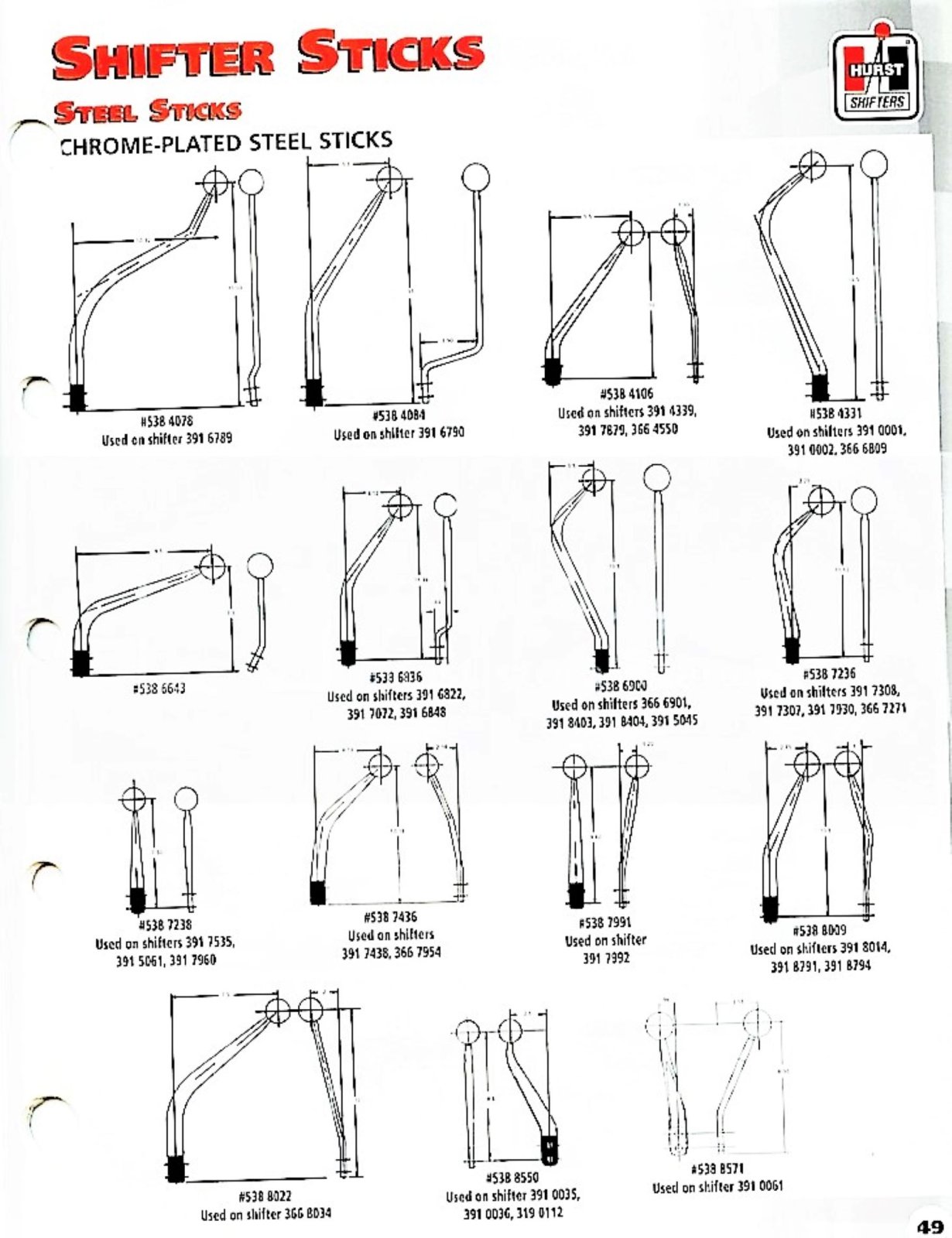

    Here is a quick reference guide for handle. shapes. Hurst site will show dimensions, too. You will have to
    expand this picture to see the part numbers....
