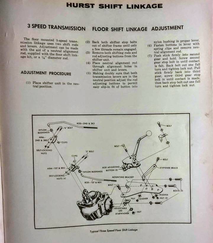

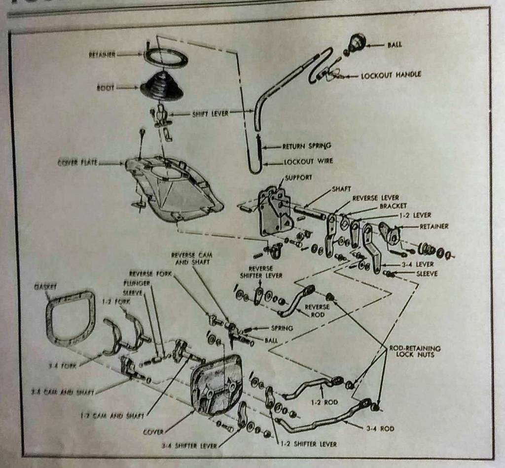

    Here's some shots of the seperate parts, but these I believe are 4spds. 1561885477909~2.jpeg 1561885508165~2.jpeg

    Thanks for your patience. It has Hurst embossed on the box like structure on the left side. Its fairly thin gauge with 3 sides broke over to make a top and 2 sides. The bottom side is open for the levers to come out the bottom. The bottom edge is curved and the box tapers outward at the bottom making it 4 1/4inches wide at the top and 5 1/4 inches at the bottom. It had 3 large rivets holding it all together. It also has Hurst embossed on the shaft of the shifter. I haven't seen a picture of it yet but it's close to a synchro-lock but doesn't have the adjustable stops for the throws. Glynn.
