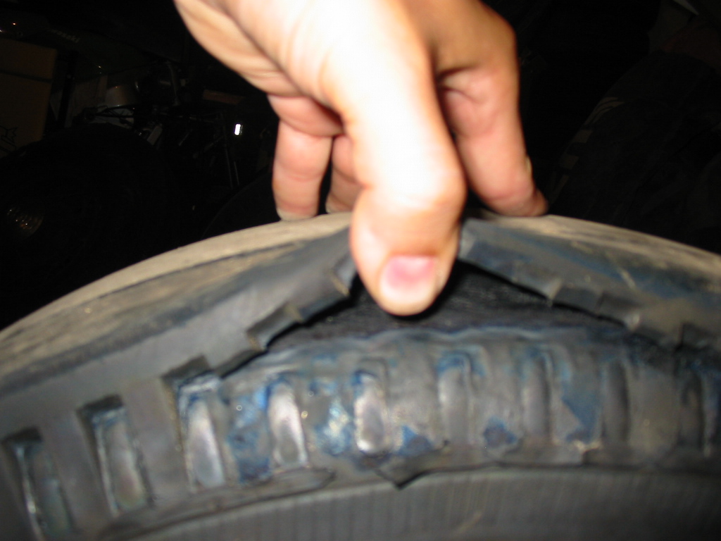

    Uh, so I need not worry about the issue that prompted me to start this thread?
    Is anyone running Hurst tires whereby the cap seems to be separating (peeling away) from the carc*** on the inside, almost all the way around? (On both tires, which have never been on the road).
    Just wondering, because I would like to avoid having them removed from my wheels, and shipping them back, etc. if this is something you guys have seen and is a non- issue.
    dve

    Wait a minute.............Why not call the Manufacture:eek: Or better yet take a picture or two and email some pic's to get an idea of what you are describing.
    Help me Help you:D
    Cody Adams
    Hurst Racing Tires
    ahrrubber@qwestoffice.net 503-656-1572

    So its only a bad thing if the cap COMES COMPLETLY OFF THE TIRE?
    It it just seperates from the tire like he is asking thats not bad?
  8. gasserjohn
    Joined: Nov 9, 2008
    Posts: 1,218
    gasserjohn
    most recaps have a feather edge left after the ***embly
    the fact that this is only on the in side on both makes me think that the outside was cleaned [buffed] up during inspection ?
    POST PHOTOS HE WHATS TO HELP YOU!!!
    all tires are make the same way out of multiable parts put in a mold indivualy &cured with heat each tire depends on a human to control this
    look at a nascar race if the PERSON building the tire goofs the tire comes apart

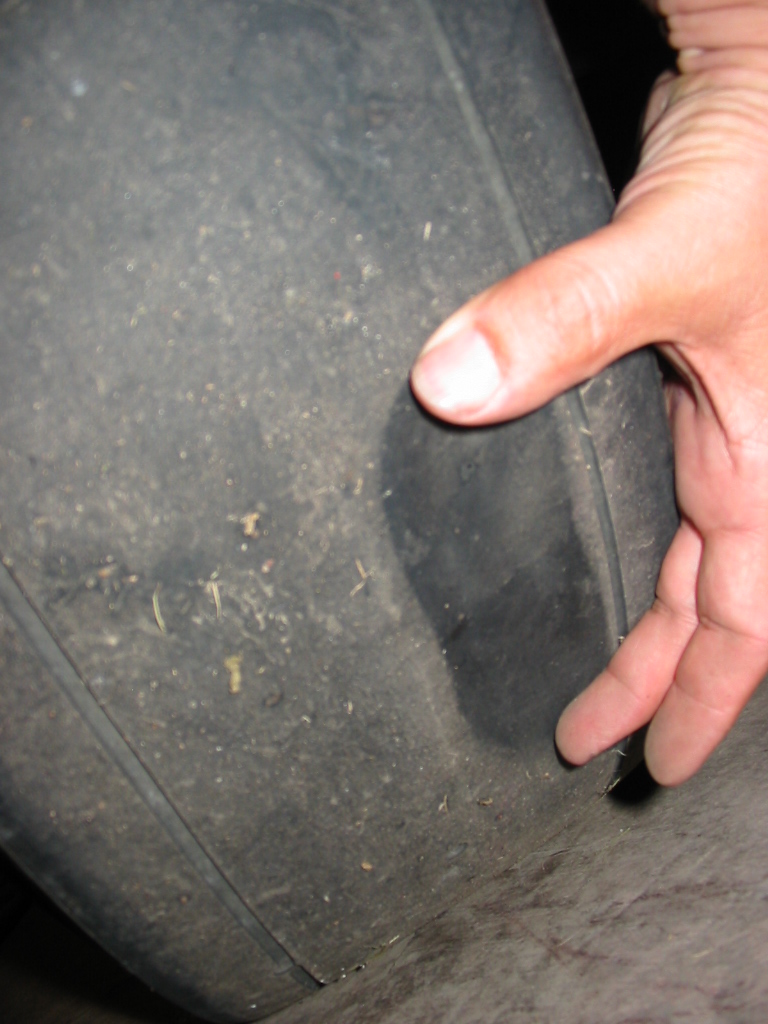

    HELLBILLY
    You guys asked for pics? Heres pics.
    These are what i call the bubble tires, these are the tires i had to buy back myself, bubble comes up, one popped the others didnt.
    These are the two sets of tires i got from Speeday late last year.
    I DIDNT KNOW I WASNT SUPPOSED TO BUY TIRES FROM SPEEDWAY... that is what you are saying right?
    Hurst tires made by some other tire company?
    I have bought TENS OF THOUSANDS of dollars in parts from SPEEDWAY over the years and so has my family, so they will take care of their customers.
    Like i said, i have 3 other sets that are fine, love em, BUT i cant sit here and say i have never had a problem when somebody asks if anybody has had a problem.
    Is it wrong for me to speak up when the guy asked?
    Or should i sit back and say nothing with several sets of unusable tires sitting in the shop?
