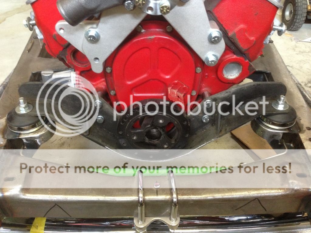

    Hi guys
    I'm wanting to get a Hurst style mount drawn up and cut out but I want to access the timing cover and run a Mechanical pump. Running in 32 rails
    Pics or advice or a drawing would be sensational
    Thanks in advance

  5. there supposed to be a spacer between the mount and the block that allows room for a pump
    OLSKOOL32 likes this.
  6. pitman
    Joined: May 14, 2006
    Posts: 5,148
    pitman
    ~1/4 inch (6+mm) of steel

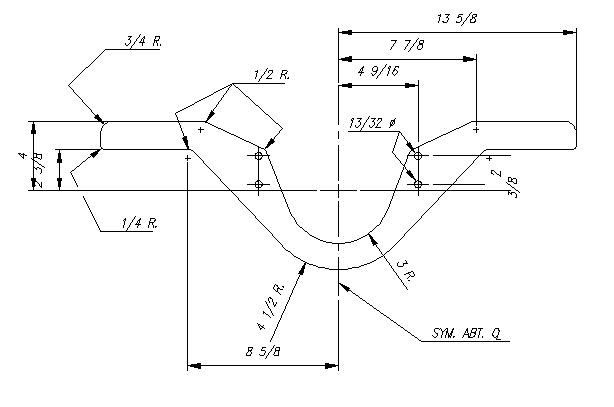

  8. Aussie Chev
    Joined: Dec 21, 2011
    Posts: 26
    Aussie Chev
    Another pic found on here

  9. Jmountainjr
    Joined: Dec 29, 2006
    Posts: 1,902
    Jmountainjr
    Build your frame mounts, set your engine height, and make a template. I cut this one from 3/8" plate on a band saw. You will need a 1/4" spacer between the block and the plate for a stock fuel pump.

    I have a Hurst saddle mount in my Deuce. I have 3/4" spacers to enable me to run a manual fuel pump.
