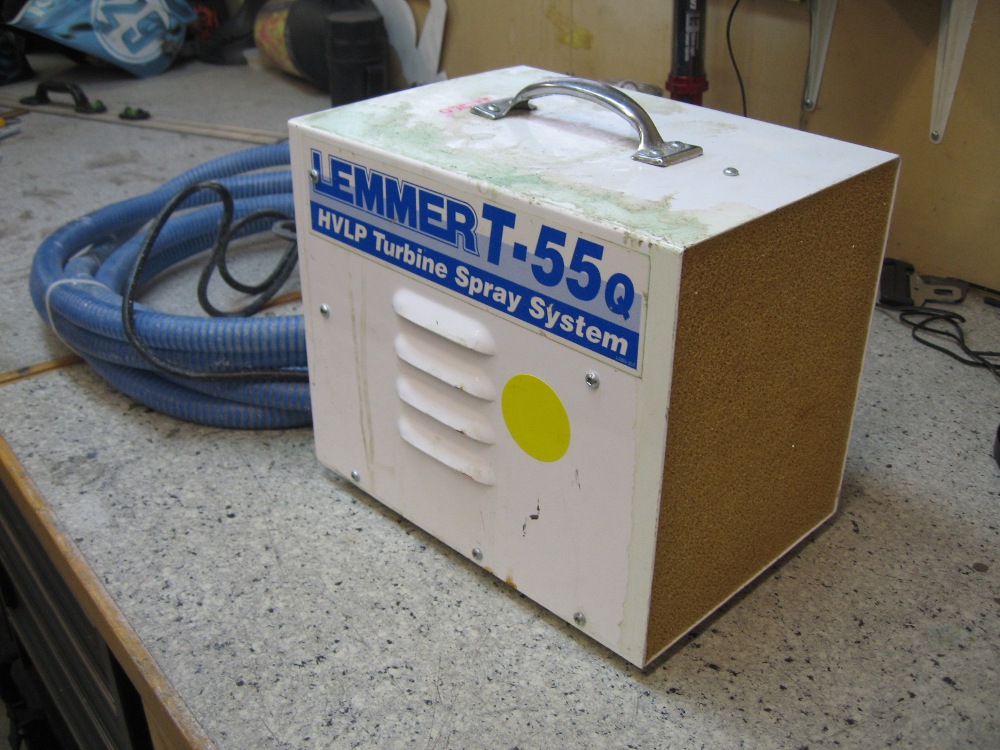

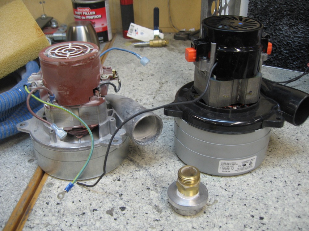

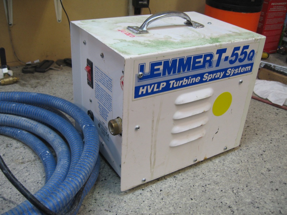

    I found this in a local pawn shop today for $200. :)

    It's a 2 stage, but I have a brand new 3 stage Ametek turbine that I will slip into the case.
    I got it for nothing ,new in the box from a guy who went out of business repairing vacuums.
    I believe the 3 stage turbine will be more than enough.
    A 4 stage turbine can be expensive and for the most part is overkill.

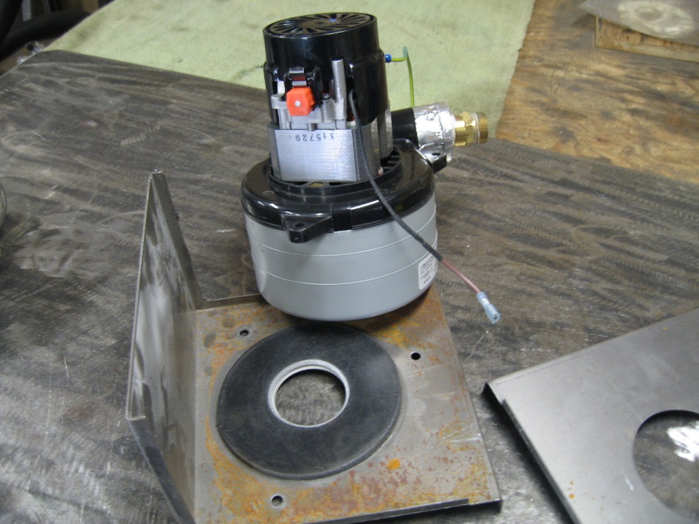

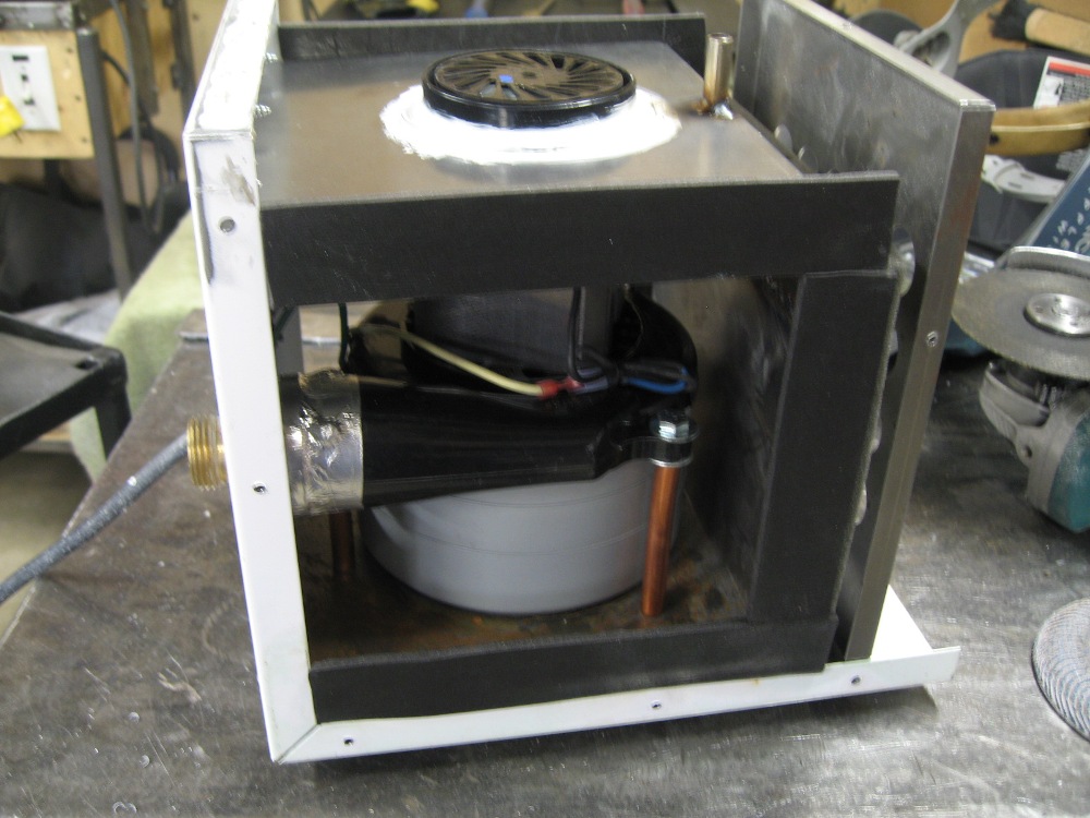

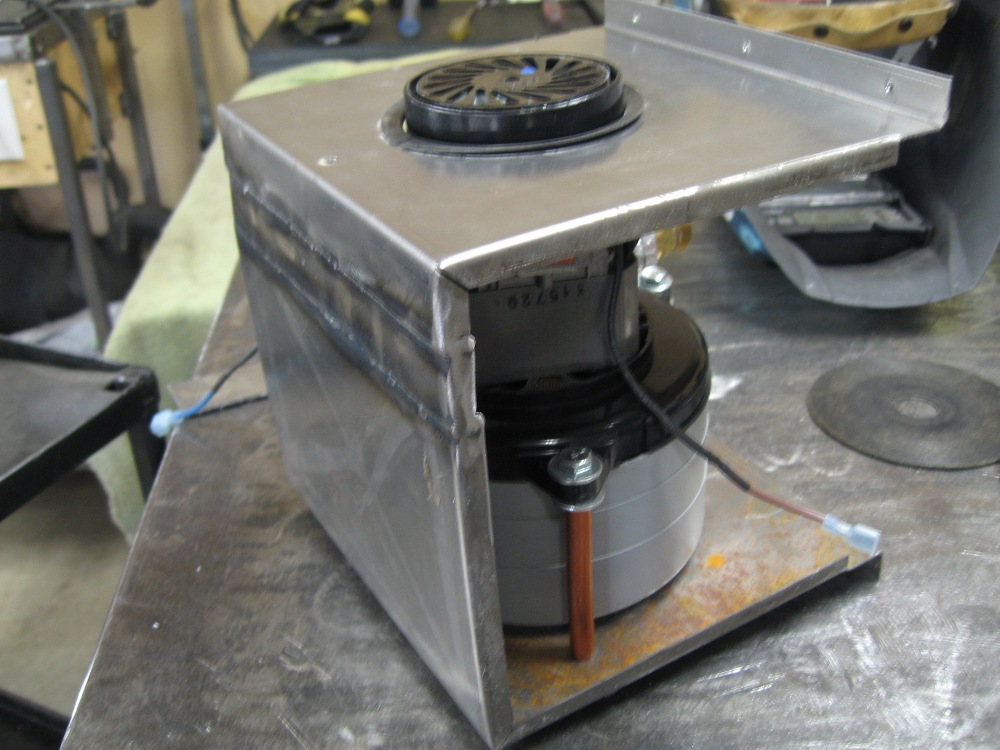

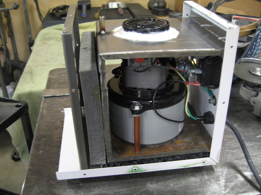

    Got the new 3 stage turbine installed and it's ready to run. Should be a good upgrade in performance.
    The cooling air for the motor and turbine housing is separate within a sealed compartment that vents through the louvers on the sides.
    The intake air for the turbine comes through the filter on the back.

    The 3 stage should be just fine. How did you attach the outlet fitting to the volute housing of the turbine? It can get a tad toasty there. What gun did you get with it? Lemmer ususally used a Sicmo clone.
  23. Blue One
    Joined: Feb 6, 2010
    Posts: 11,509
    Blue One
    from Alberta
    The housing on the 2 stage turbine was aluminum as you can see. The outlet fitting was siliconed in and held with 2 screws.
    On the Ametek the housing is plastic so I just drilled the holes for the screws and then generously applied some red RTV high temp silicone to help seal and secure it.
    I probably didn't need to but after it was screwed and glued I wrapped a little aluminum foil duct tape around it.
    It isn't going anywhere :)

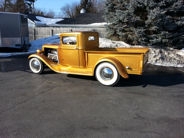

  27. Shot using an Apollo gun and a Sprayfine 4 stage turbine.
    Some panels painted with the turbine and some with an HVLP. You cannot tell the difference.

  30. .
    I used the Apollo 7500 gun with the B air cap and 1.0 needle. Medium reducer shot at about 68 degrees.
    It was shot in the dead of winter and to maintain temp I couldn't ventilate properly. I didn't so much as crack a window. Try that with a standard HVLP.
    I picked up the turbine, gun and 50' of hose brand new off eBay for about $800.
