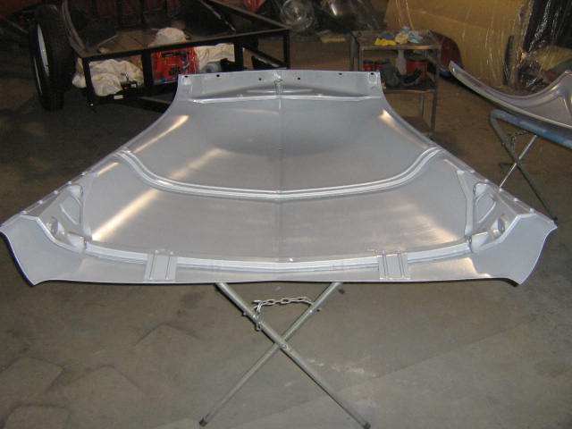

    One thing nobody has talked about is how is how far the paint goes with a HLVP turbine. I used ONE galon on this car--inside -outside-wheels-under hood--everything ONE GALLON I couldn't believe it.
