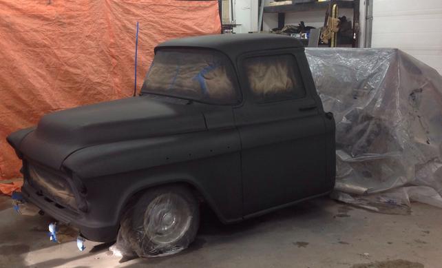

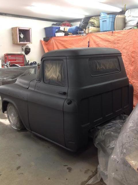

    I just finished spraying some black epoxy prime ron my 56 with my TP Tools HVLP turbine set up this past weekend. Anyone sitting on the fence about picking one up to paint at home, should be picking one of these up. I've sprayed smaller parts with it but never an entire truck. There was literally next to no over spray. I used my exhaust fan just to exhaust the fumes. To do do 2 wet coats on the cab and front end of my truck took less than 1/4 of a gallon of primer, that's pretty damn good!!
    With a system like this, anyone could paint their car in their own home shop with quality results

    Just to reiterate how easy it is to achieve a nice finish with this system. I had my 15 year old son spray the 2 coats of epoxy primer on my 56 truck bed this weekend. He's never even picked up a spray gun before, let alone shot and entire half of a truck. There was only 1 run in the entire thing

    Looks like he painted where it sits in the picture. That right?
  27. dubie
    Joined: Aug 17, 2004
    Posts: 698
    dubie
    yup he shot it just where it sits. We wet the floor down 1 hour previous to spraying so any over spray there was, sits on the damp floor and is later swept up as dust.
