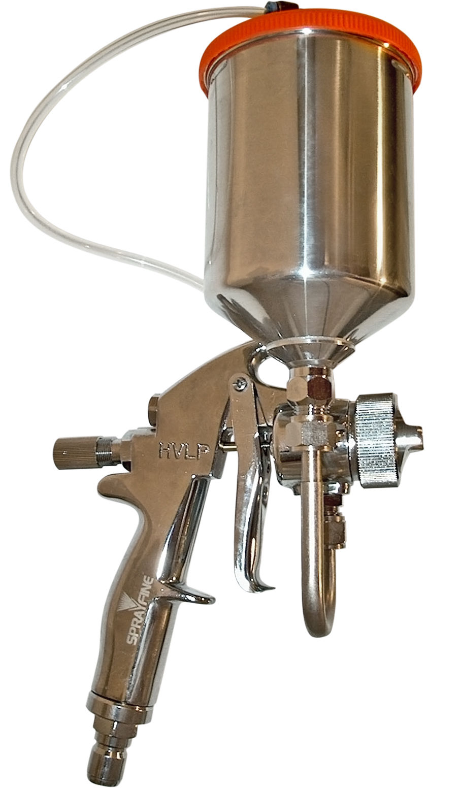

    I found a Sprayfine gravity feed gun listed on flea bay for $139.00.

    Ok so the guns on the list so far:
    1-Apollo 7500T Atomizer
    2-Sicmo (American Turbine etc)
    3-Sprayfine
    4-Accuspray 10
    5-Graco Edge
    6-Fuji T series (in the works)
    As for turbines.....they all use either a Ametek or Electromotor multistage pump that's more commonly used in the central vac industry, and in themselves are quite inexpensive (under $100). Personally I see no reason to spend a big wad of cash for a metal box and some filters. In fact if you have any woodworking skills, a nice plywood enclousure can be built on the cheap. The Turbine Products turbine is probably the best value out there. Hoses can be kind of expensive too, and some are better than others. The best kept secret a****st the turbine guys is Tuff-Guard garden hose for use as the air hose. Its about 1/2 the price and holds up fine ( in fact its the same hose as some HVLP's). So say $325 for a turbine, $30 for a hose.....just need the best bang for the buck gun now. Stay tuned for the side by side gun review!
