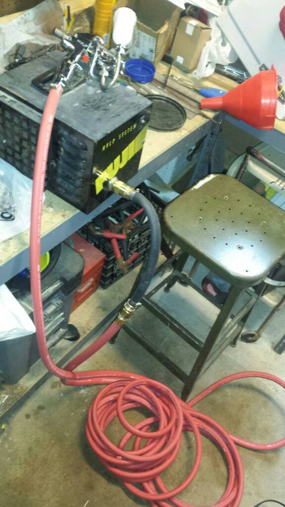

    Here is my setup now that I have added the garden hose. I think I have about $400 total invested.
    I am using 5/8" hose up to the gun. I hope this does not reduce volume significantly. Anybody have any experience with this vs. 3/4" hose?
  22. TudorTumor
    Joined: Nov 9, 2013
    Posts: 13
    TudorTumor
    Hey Jack,
    Looks good. Not sure about the 5/8" hose. I would guess it to be an issue.
    Another thing I see to be a potential problem is its location. Don't run it on your workbench. The 90* bend in the hose hanging down from the Turbine will be too restrictive, causing the hose to overheat and deform. Instead set the unit on the ground to run it, keeping the hose running straight and level as it exits the Turbine for a few feet at least.
