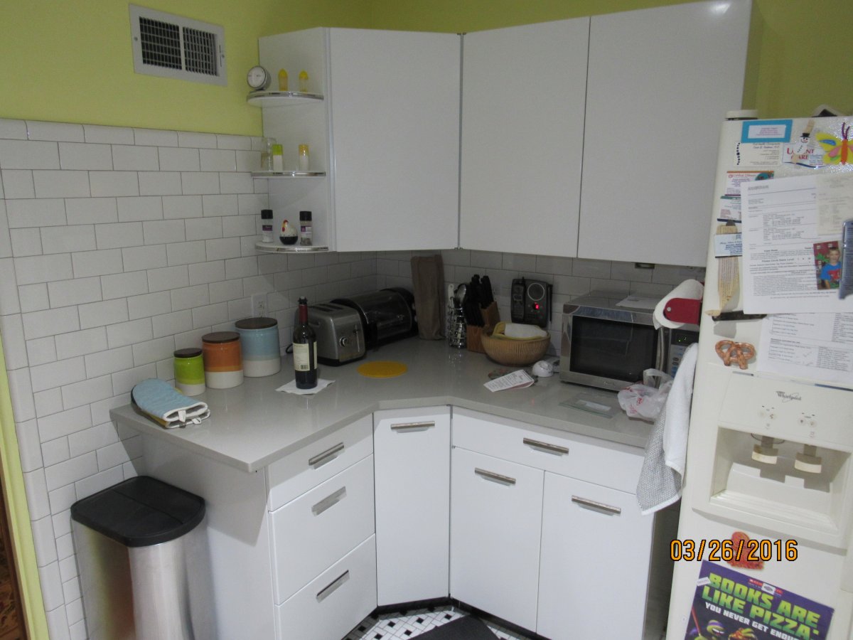

    I have a fuji 4 blade turbine that I bought to spray my 50's metal kitchen cabinets. I was spraying Sherman Williams enamel. To get it to lay flat with out to much orange peal I had to thin the paint a lot, 45%. Then many very light coats. To much it would run. To get more consistent mixes I bought a 4 cup glass measuring cup for the paint and a 5 oz measuring glass for the thinner. This helped a lot. I bought all the tips and played with them all. Ended up using 1.2 for paint and the 1.4 for the primer. A neighbor recommended Killz primer. It sprayed well and dried fast. Easy to sand. IMG_5306[1].JPG IMG_5307[1].JPG IMG_5308[1].JPG
