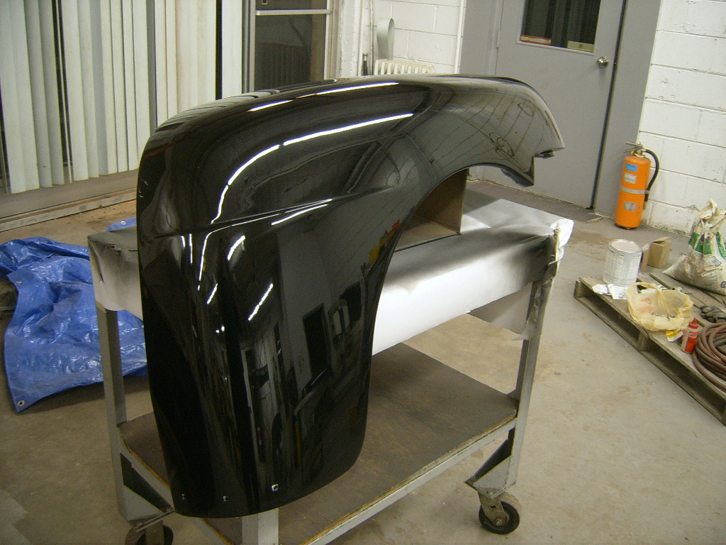

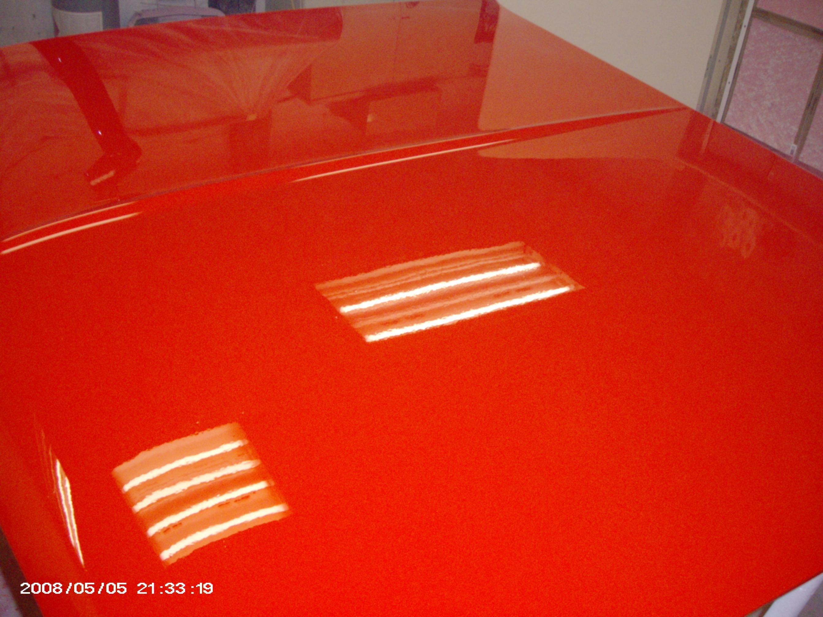

    The HVLP is a little different. I use a Devilbiss gravity feed with a 1.2 mm tip. It's as close to the good old JGA as I can get. Atomization was the problem I always had. The HVLP's always seem too heavy. I find I can spray with 20 - 22 lbs. of air pressure at the gun and it works great. I use a lot of light triggering to get the atomization I want. I remember a painter telling me that with a HVLP you put the paint on like using a brush. Slower and heavier!! You'll find once you get use to it, it works well. Here's some of my paint work with the HVLP. The Green Jag. is off the gun and the Black Ford P/U has been colour sanded and polished.
