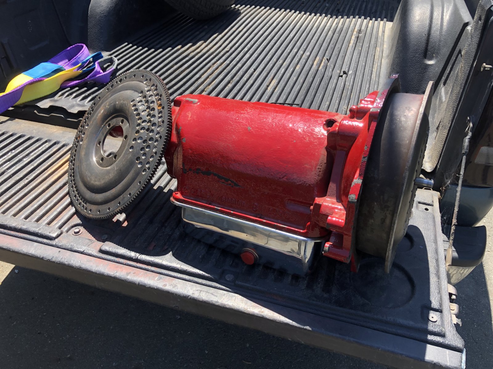

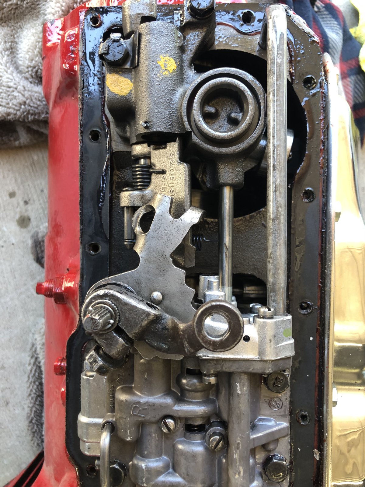

    Bought this on marketplace listed as a 56 hydrostatick. The gentleman that I bought it from bought it from iron trap garage as a hydrostatick. The story is that it was owned by a man named Donny Besley who had it attached to a supercharged olds but he upgraded to a beefier trans.(!)
    It’s very clean with chrome pans and I got it for a good price. Not hydrostatick price.

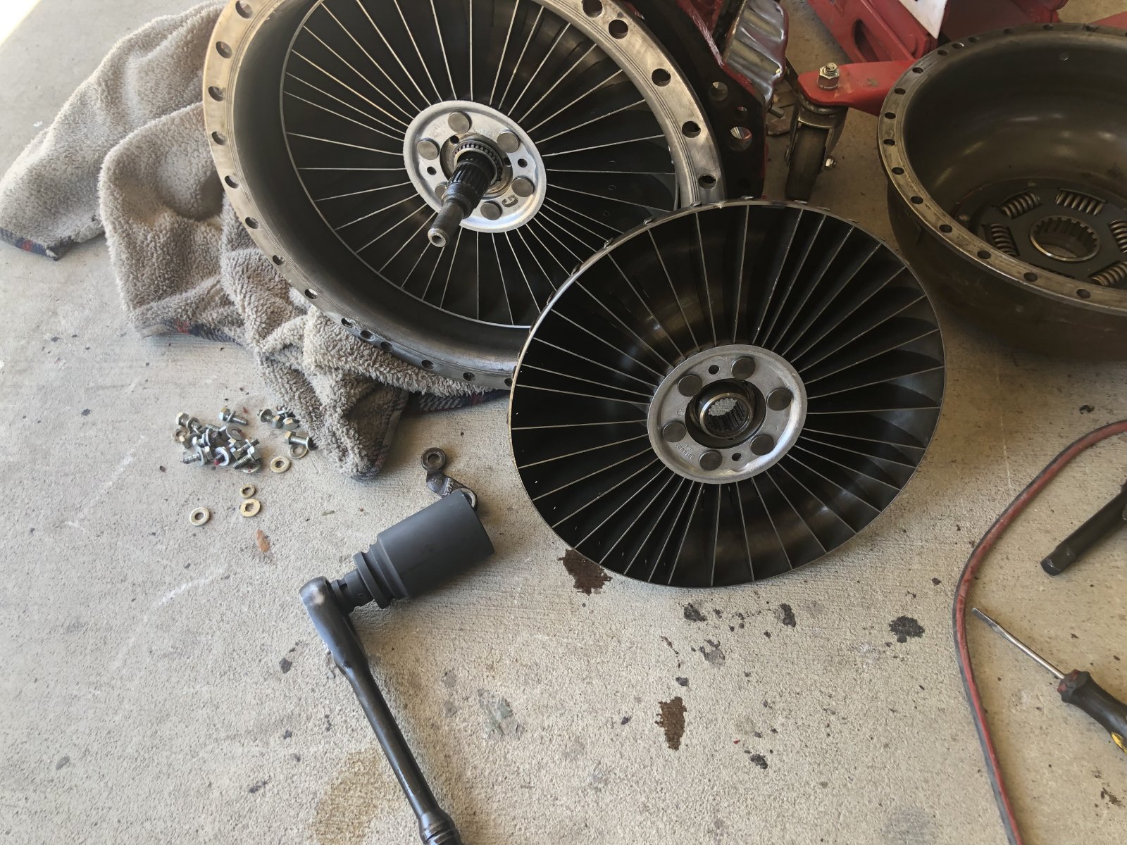

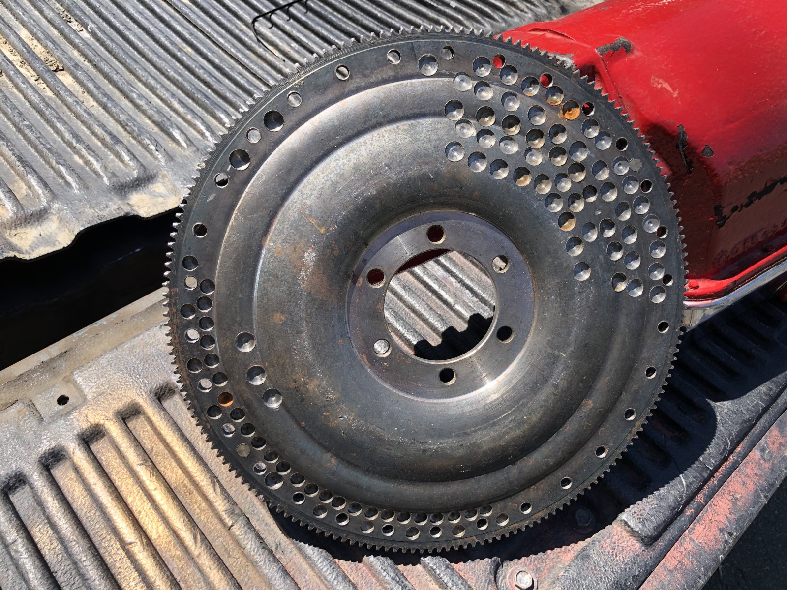

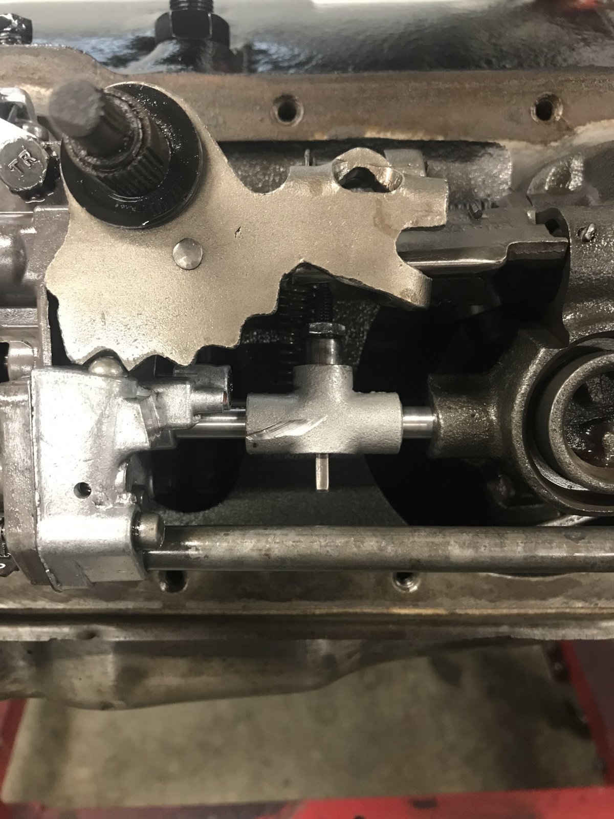

    It is a slant pan with mechanical reverse, no b&m markings and no b&m valve, the shift plate appears to have been modified,(?) the flywheel has been balanced and uses larger bolts than my 49 and the torus ***embly appears unmodified.

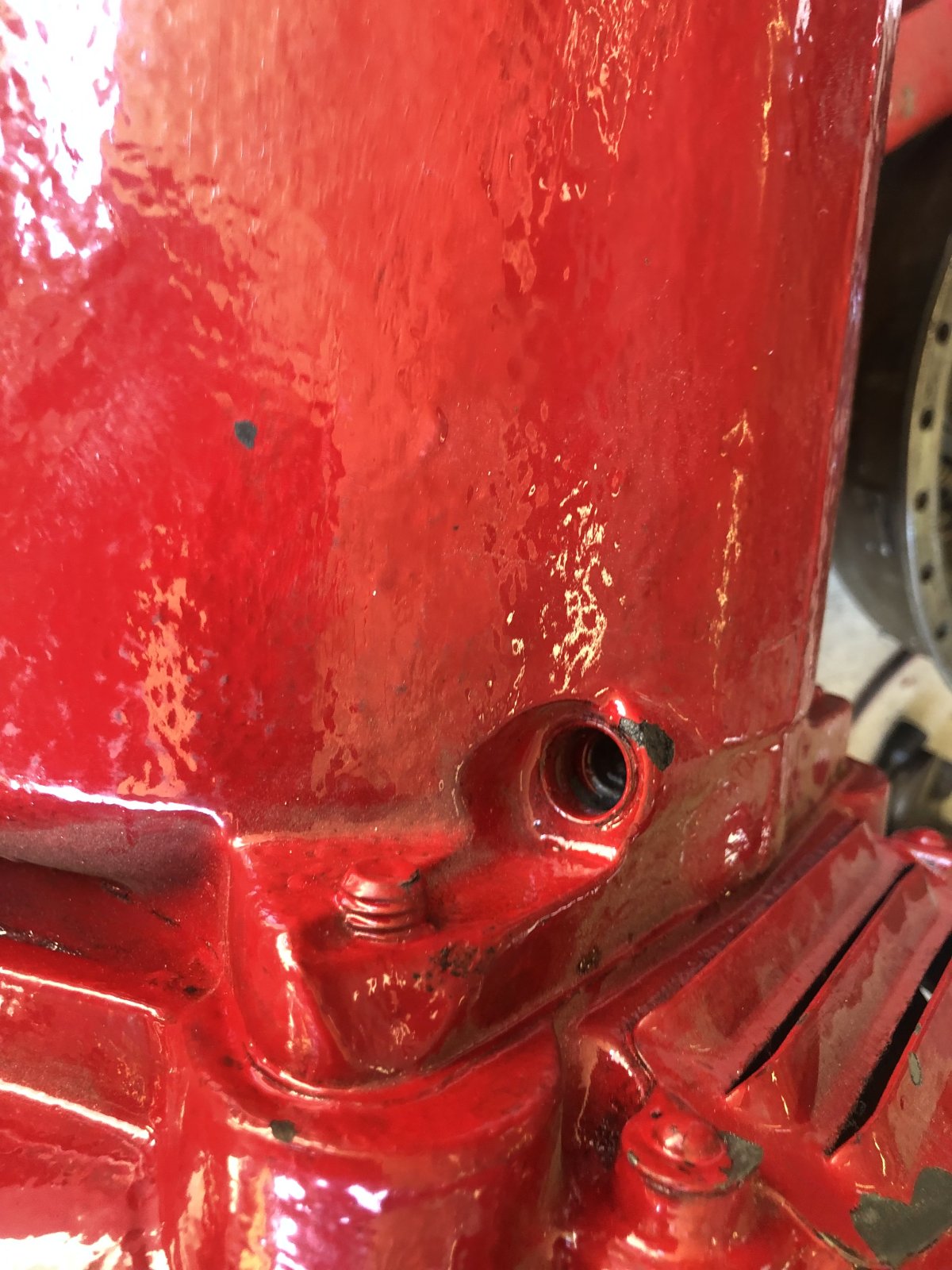

    IMG_0734.jpeg IMG_0733.jpeg IMG_0738.jpeg IMG_0741.jpeg Also, what is this hole on the top for?
    Thanks!

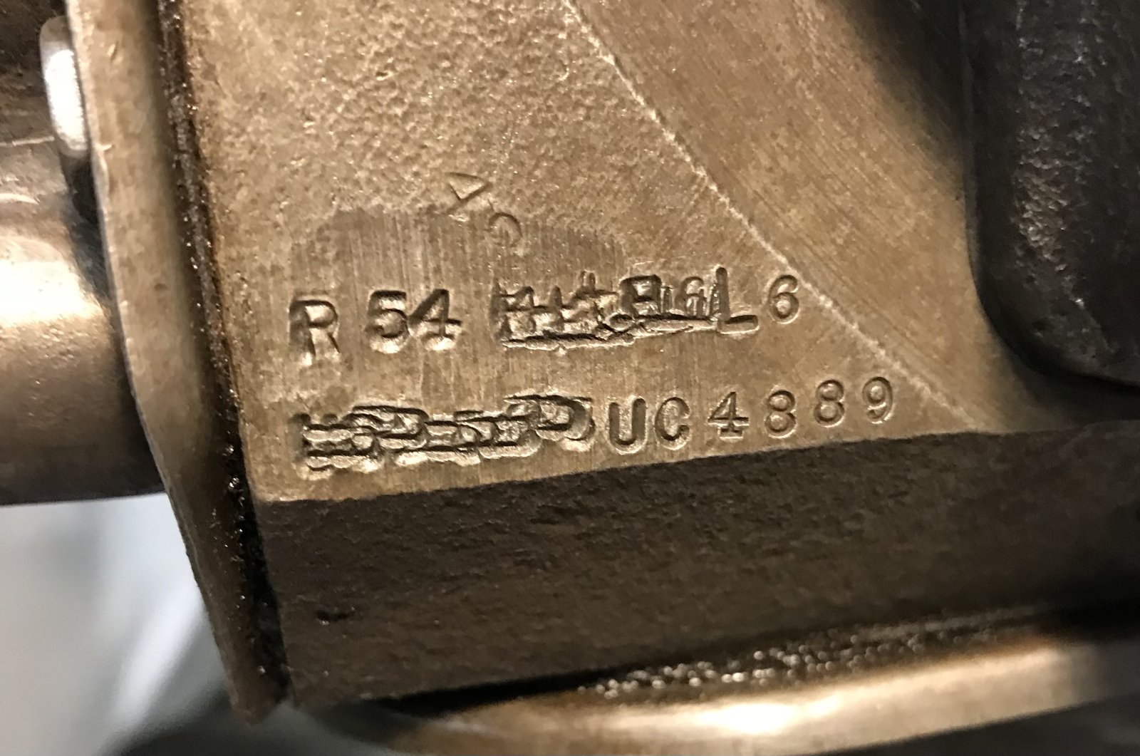

    On a few B&M hydros I've had they also stamped the info on a machined surface under the tailshaft extension. I think its maybe on the main case of the trans right below where the tailshaft extension bolts up. Check there for codes...

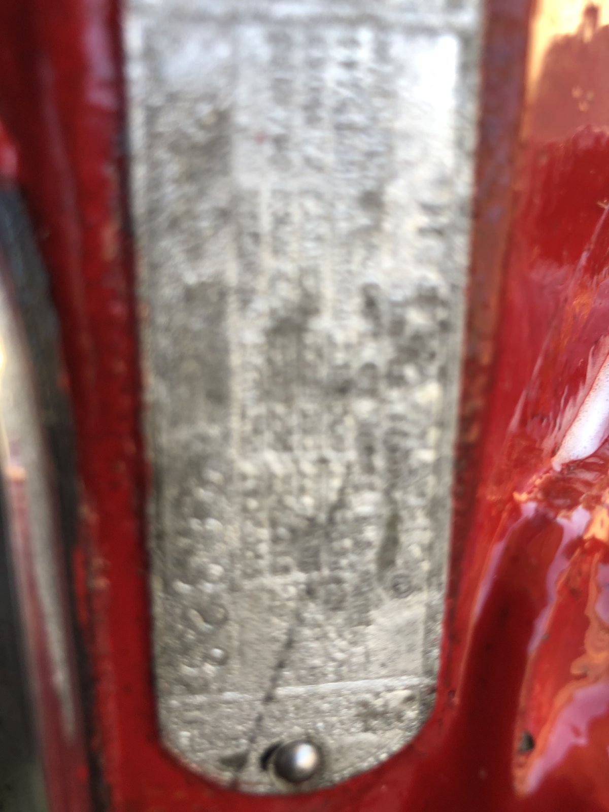

    Found the tag under the rear housing, time has taken its toll and I can’t read it. Also compared shift ***embly to my old trans and there is definitely a notch cut to hold in first gear. I couldn’t imagine using it.

    SR100
    It looks like you might get some information off of that data plate by holding a piece of paper over it and rubbing with a pencil.

    I tried this but all I saw was “ drink more ovaltine.”
    I ended up painting the tag black and lightly sanded it, turns out it’s just a factory tag.

    How many “detents” does the shift selector arm have. Five would be a stock hydro. N, 4, 3, 2-1, R ……Six N, 4, 3, 2, 1, R would be a Stick hydro.

    Thanks for asking, it has 5. I’ve been reading up on dual range hydramatics since I originally posted and they are a little different than the 49 that I currently have.
    Looks like I have a very nice stock transmission.

    Here’s what B&M stamped on the rear of the main case, adjacent to the tailshaft housing.
    And the B&M valve….
    A lot of companies modified Hydramatic transmissions back then, not all of them identified them and the modifications performed. Those do appear to be stock torus wheels though, if that’s any indication.
