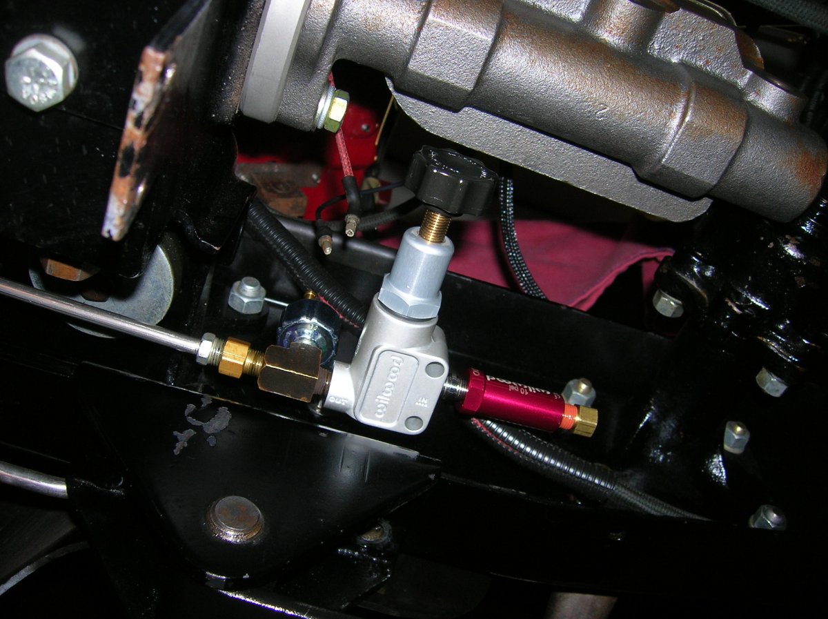

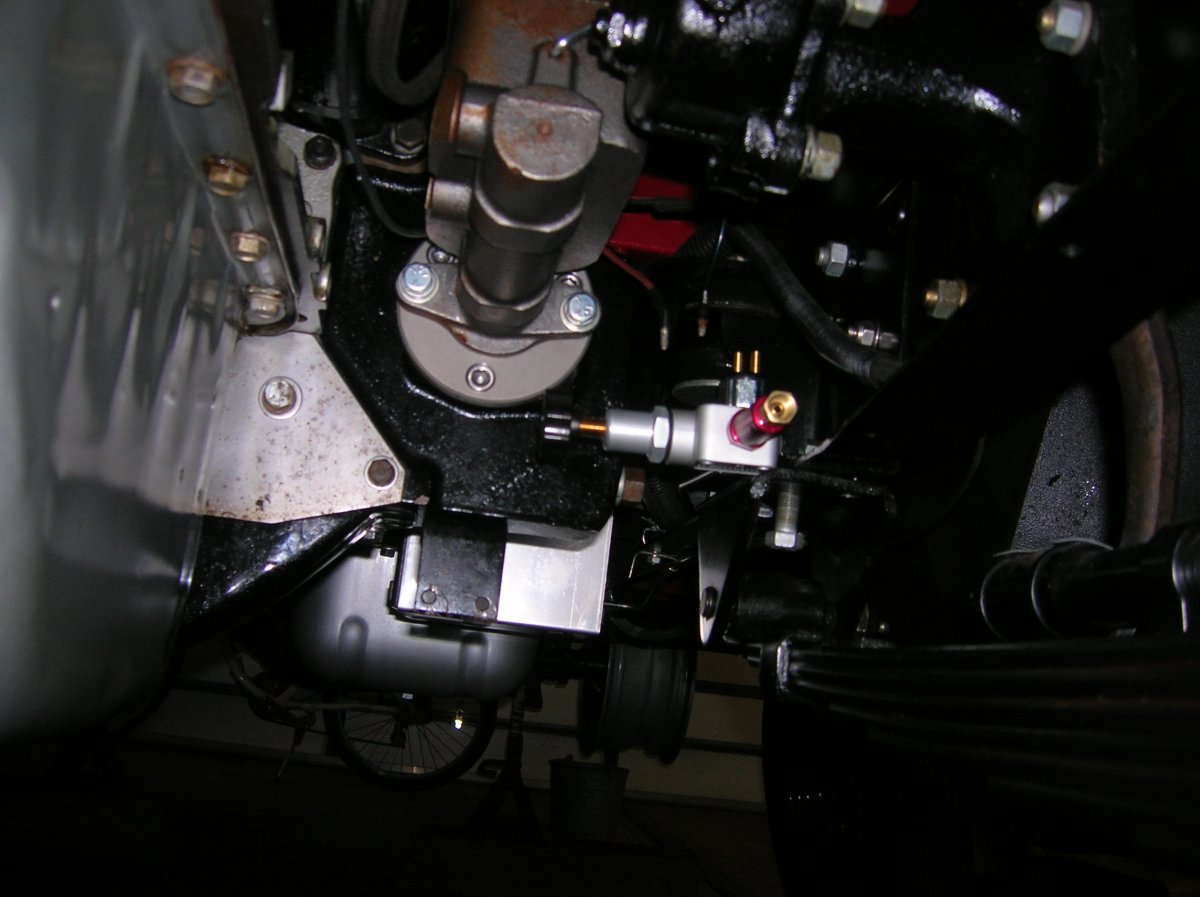

    Here's some pictures of how I would like to plumb. Not much room on this old Mopar and being a retro rod, I try to minimize altering things too much. Anyhow, it's the easiest way I could come up with and not have to mess with any wiring changes. My initial query was concerning pressure switch placement. I'm hoping it's OK to put the hydraulic pressure switch behind the prop. valve? I'm now thinking it should not matter where the hydraulic pressure switch goes due to it must have some minimum amount of pressure to activate? I'm just mocking it up now and will fabricate a mounting bracket for the prop. valve. The front port on this master cylinder will feed to the 10psi residual in the photo. Rear port will go to new front discs via a 2psi residual. See any mistakes? DSCN2459.JPG DSCN2460.JPG DSCN2462.JPG DSCN2463.JPG
  22. seb fontana
    Joined: Sep 1, 2005
    Posts: 9,299
    seb fontana
    from ct
    That will work fine, mine is just like that. I installed the proportioning valve vertical and have it come up through floor at front edge of seat..

    I am curious though as to the loops in your lines, is that to make bleeding easier or for vibration reasons or something entirely different ?
  28. Steve Lowe
    Joined: Nov 8, 2019
    Posts: 74
    Steve Lowe
    Yes, for vibration and flexing. The original line from the master cylinder had a loop to the tee on the frame. I figure the Mopar engineers knew what they were doing. The master cylinder is mounted to the bell housing which moves with the engine torque. Even though the motor mounts on my truck are "almost" rigid, there is a a little flex when the engine is revved. Over time I imagine the lines might fatigue and crack?

    You might have a problem bleeding air out of the system if you point the switch up at 12:00.
