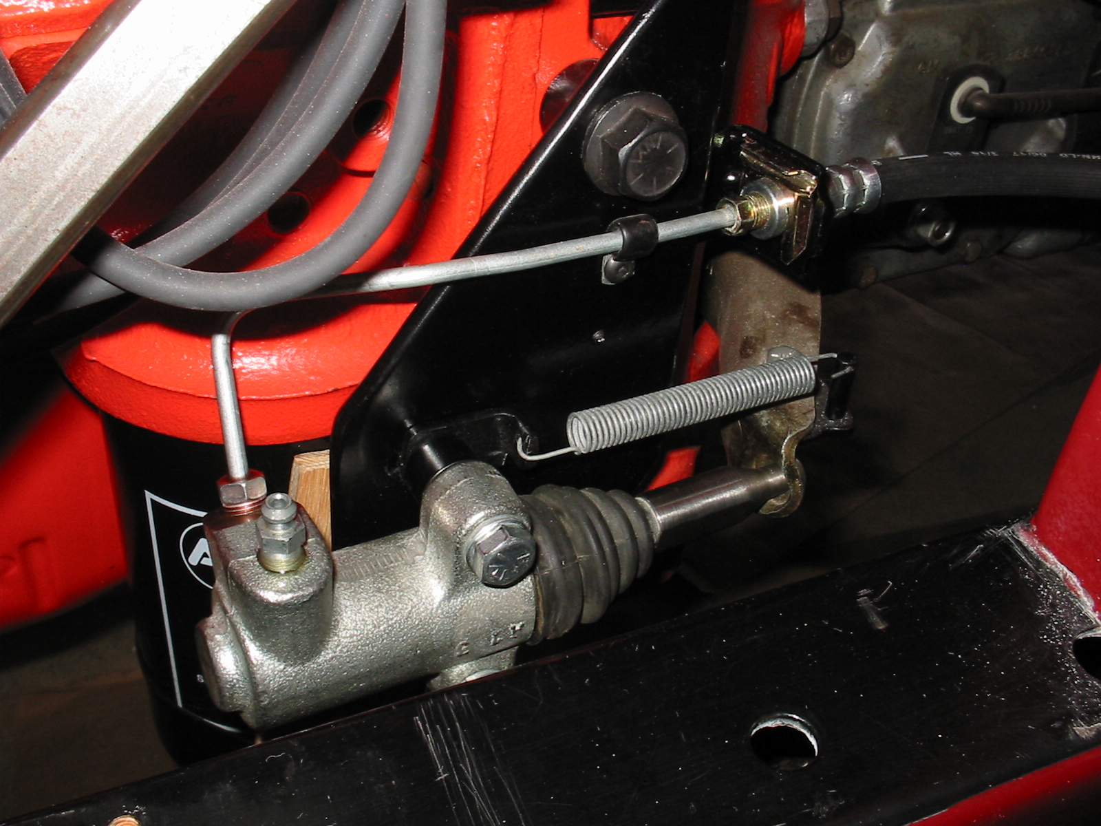

  2. These wouldn’t work with my old style bell housing. My bell housing mounts are staggered. If yours are not, something like this would work.
    so I made this. Crude but works
    the slave cyl is for an early 60s gm truck.
    modern style ones would probably take up less room
    If I had the factory hydraulic v8 bell from the early 60s I’d would have used that instead. Slave is mounted on the p***enger side

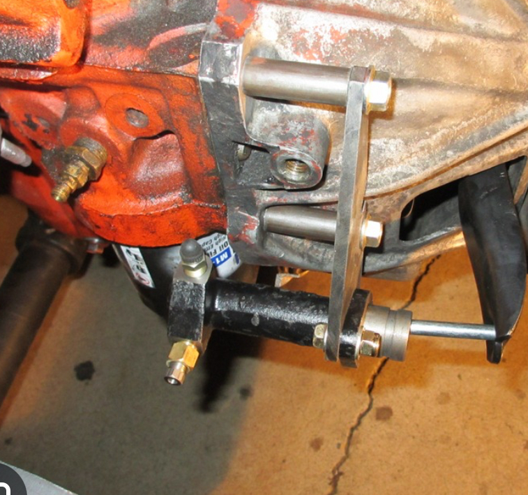

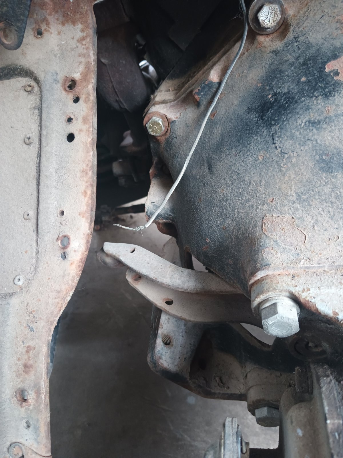

  7. Best term I could come up with
    Maybe this helps
    Mine are like this. Taller bosses on the bottom bolt
    Not like these
    squirrel likes this.

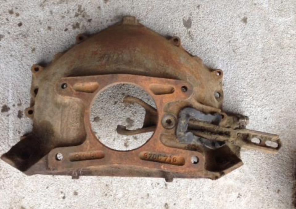

  8. Here’s the 60-62 c10-30 bell
    could possibly space your top bolt like this?
    No spacer on bottom and the top with one?
    wfo guy and Algoma56 like this.
