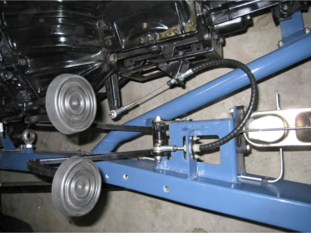

    An easy alternative.
  10. That cable linkage looks simple and easy. I'm using a Mazda pickup master and slave on my '38 Ford with a small block Chevy and T-5 using the same Chevy bellhousing shown in the picture above with the cable linkage. What I have works well now, but I could be tempted to change to the cable setup the next time the slave cylinder goes out.
  11. FordMercMan
    Joined: Jun 22, 2011
    Posts: 20
    FordMercMan
    Do you know the origin of the cable or part number or where to get one? Seems to be a nice solution.
    The brackets look like they can be easily fabricated.
  12. D-Russ
    Joined: Mar 15, 2006
    Posts: 1,749
    D-Russ
    It's a modified (shortened with different ends) 5.0 Foxbody Mustang part. I purchased it already modified from Roy Brizio Street Rods in San Francisco. When I bought it 10+ years ago it was between $60 and $80.
  13. Yeah now I'm pissed, because of all the hours I've wasted on clutch linkage lmao! That a great setup!
