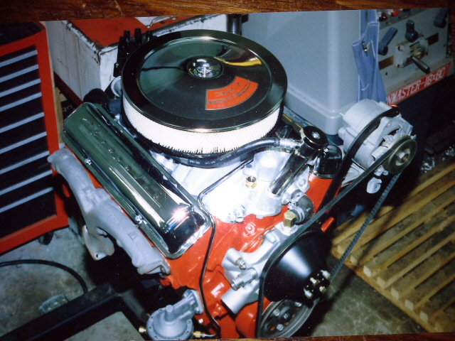

    Oil pan is the old Corvette 6 qt with trap door and windage tray. Stopped by the shop today and grabbed an '1182 forging that's getting offset ground to 3.562" stroke and mains turned to fit the '870 block. Mains on the block have already been strapped, studded and was getting line honed when I got there. Heads just went to Jerry Killian in Warner Robins Georgia for some love.
    My machinist/builder was one of the shops Comp Cams used for developing profiles WAY back and we are literally minutes from Darlington. I'm fairly competent but admit there may be some tricks I've not seen yet. I do fly my airplanes behind engines I built.
    The whole point of this engine is completely stock external appearance with no more rumble at idle than the old L-79 350hp cam. The combo may look humble but should make my little stripped down '65 'vette go pretty well. I just finished boring a set of side hung float bowls for my improved fuel transfer tube, turning a 3310 into a 1850 look alike. It will be sitting on a Winters Foundry special high performance intake that I'm doing some welding, milling and grinding on. All stock L-79 look on the outside, even the air cleaner.

    My machinist is convinced we should use a set of solid rollers on the hydraulic roller cam I have. The cam was made from a buggered Ultradyne billet roller so I'm not worried about hurting the cam. He says he builds lots of circle track engines that way. Anyone have experience running a combo like that on the street? Do I use springs like a hydraulic roller or a solid roller? I already have a set of freshly rebuilt Crower solids with pin oiling on the shelf. Have a rev kit for those lifters on the shelf as well.

    I didn't get to run it due to a slight warp in the cam, but I was going to run solid rollers on a hydraulic roller cam in my 505. Builder said we had to use more spring than the hydraulic cam called for when using solid rollers. When that cam turned out to be warped, I wound up calling Comp cams and their tech said the builder was right. I'll have a new hydraulic/solid roller cam in another week hopefully. Tech said this cam is billet and don't go under the minimum but run as much spring pressure as the builder wants for the RPM we'll be running.
    Just saw you mention the lash. Mine is a big block but we were told to run .008 cold for the solids up to a max of .015
