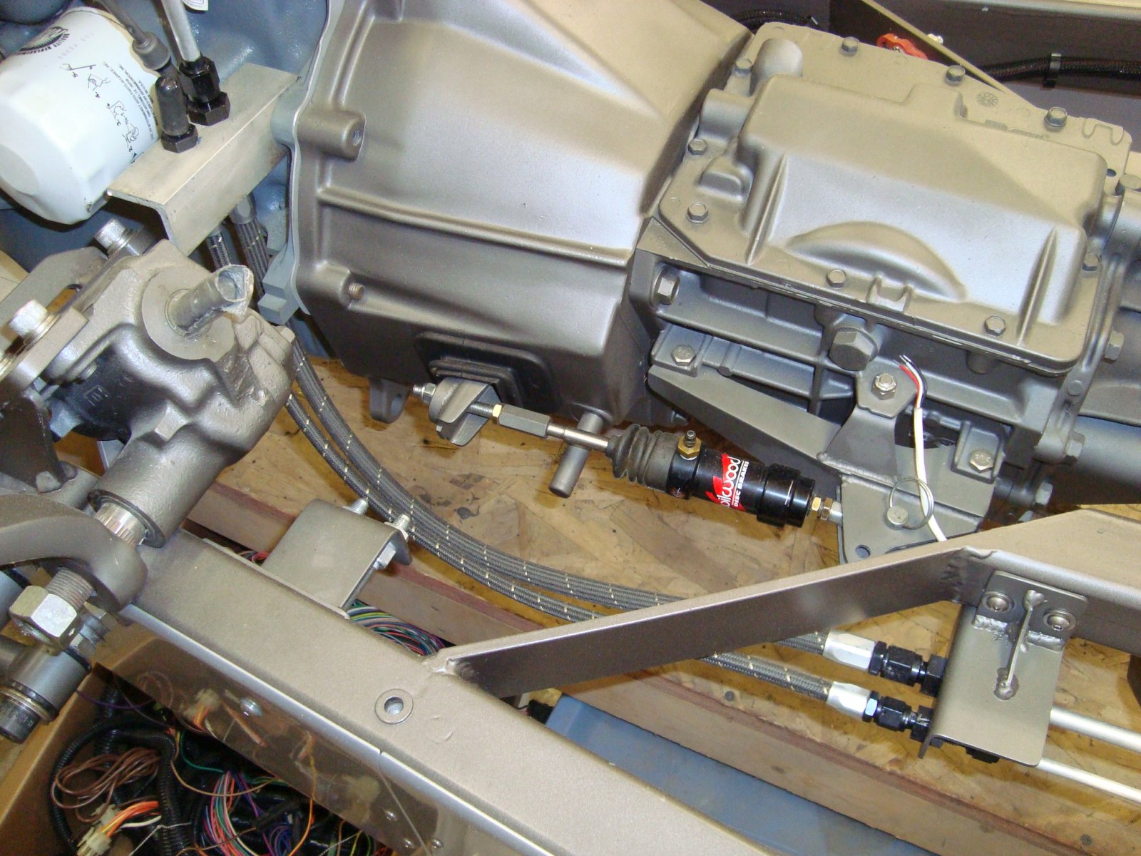

    The pull-style cylinder solves a lot of problems.

    Nicely done...........

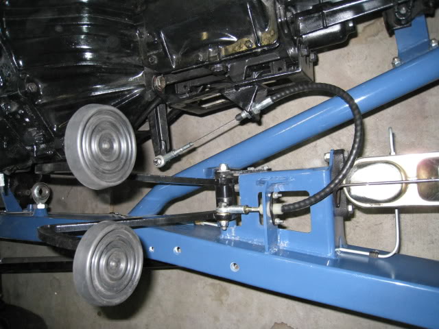

    A simple alternative:
