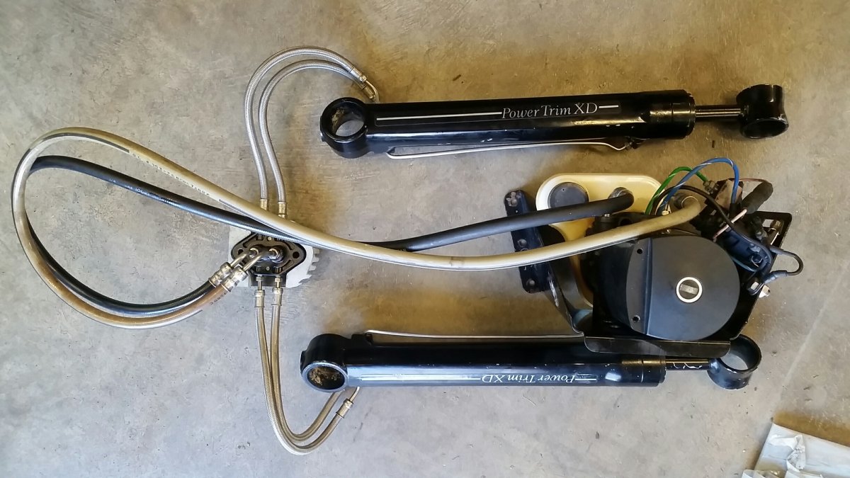

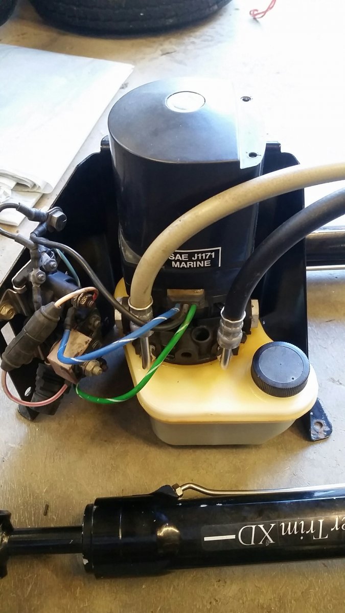

    I have an electric trim pump, a pair of cylinders, and a distribution block all from a 19' Wellfleet boat laying on my garage floor right now. It has everything you'd need as far as the hydraulic components are concerned. I suspect there are boat salvage places in your part of the county where you could find the same stuff. Or I'll sell you this setup. 20190201_134733_resized.jpg 20190201_134749_resized.jpg

    That trim tab setup may not be up to the load though. All they do is raise and lower a couple of aluminum or stainless plates at the back of the boat that probably don't weigh 10 lbs each or at least they don't on my Bayliner. Kind of like wheelie bars for a boat in that they keep the boat at the best angle in the water for the best performance.
  19. Ebbsspeed
    Joined: Nov 11, 2005
    Posts: 6,549
    Ebbsspeed
    This is a setup that does not move trim tabs. It actually moves the outdrive to change the angle respective to the boat centerline. Under full power it takes one hell of a lot of force to push the outdrive away from the transom. See image below...
    Here are the facts: It is a 2000PSI pump with a pair of 1.5 inch cylinders. A 1.5 inch cylinder has a piston area of 1.77 inches, times 2 cylinders is 3.54 square inches, times 2000PSI equals a lifting force of 7,080 lbs. That's plenty to lift the whole damn panel truck off the ground. You could glue two or three fat ladies to the tailgate and give them rides up and down if you were so inclined.
