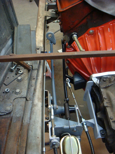

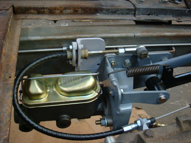

    Here is my cable set-up in my Model A sedan. T-5 and a SBC. Got the idea from member D-Russ who did it to his Model A Vicky. He did a thread on how he did it.
    I am still building the car so I have no real world experience with the set-up, but it operates pretty smoothly, with little effort..

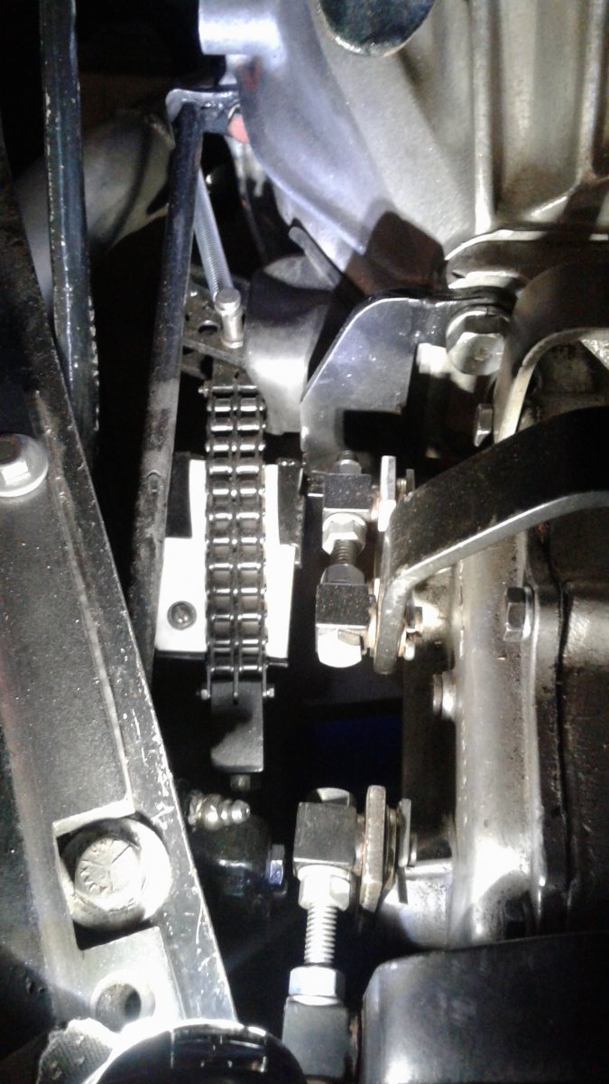

    20191119_184002[5942].jpg 20191119_184002[5942].jpg Hydraulic, mechanical, cable? How about a chain?
    This setup is in a 35 Ford coupe with original 39 pedals, Muncie, 327, Sachs clutch and T and F shifter.
    The 39 pedals are installed in the usual way, and clutch shaft is rotated 180 degrees (pull instead of push). The now down facing clutch lever is extended about 1 and 3/8 inch to get the required travel to the clutch fork, about 1 inch.
    The clutch lever is connected to the clutch fork lever (shortened to avoid the brake pedal) with a piece of used duplex timing chain (from the s**** bin) with clevises adapted to each end, which runs upwards over a Teflon lined ramp (bolted to the Muncie) to keep the clutch pull alignment straight. The clutch fork lever requires a spring to keep the throw out bearing clear of the clutch plate, and there are adjustment holes drilled in both levers.
    I have only driven this on test runs, however it feels great to drive, was cheap to build and I am very pleased with the result.

    That is thinking outside the box, please keep us up to date when you start driving the car regularly.

    That is a unique way of doing it but whatever works. HRP

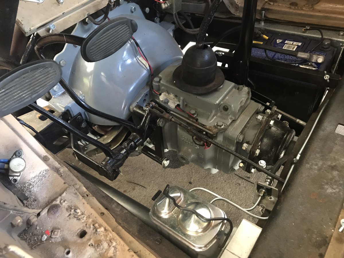

    Thanks @bjinx. A cable actuated clutch is super easy, very adjustable and can have a very light pedal depending on the return spring you choose. And they're great for tight spaces. I've got about 8,500 trouble free miles on it so far.
