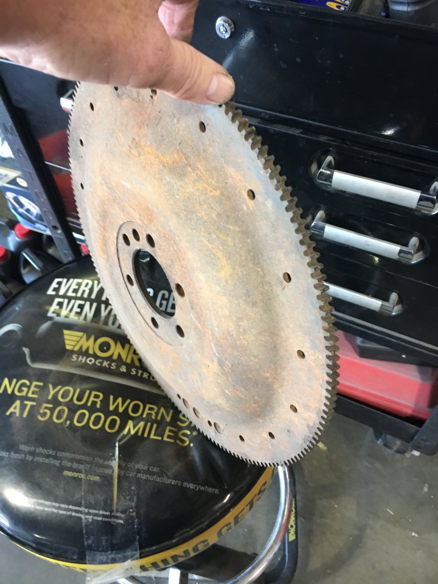

    Junior - that's the set up, glad you put the number up... I hope my situation can help the next guy with this conversion.

    If you punch the 323-92 part number from Junior 1957 into NAPA’s interchange search, it’ll spit out a couple other part numbers that are supposedly replacements. The photos don’t match what you’re looking for, but I’ve seen that happen before on their website. Might be worth looking into even if you already have something lined up with Ol’55. Doesn’t hurt to have a spare. My high compression 301 has a tendency to be hard on starters - busted a cast iron nose cone off one and ate a drive on another when I’ve gotten a little overzealous with the initial timing.
  5. randydupree
    Joined: May 19, 2005
    Posts: 667
    randydupree
    from archer fl
    The International 345 engine used an extended nose like that,it had a 2 bolt flange mount.
    the Mercruiser engines had one like it too.
    I would be looking for one and adapt it to fit.
    Both had delco starters.

  7. You use a 3 bolt starter for that. I got one here come get it. Oh and bring the big kid I like him.
