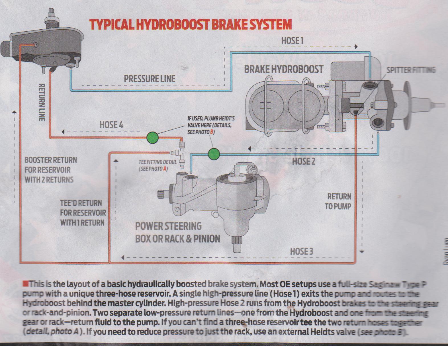

  12. Roothawg
    Joined: Mar 14, 2001
    Posts: 26,292
    Roothawg
    IMG_4652.png Here’s a basic schematic.
    bchctybob and porkshop like this.

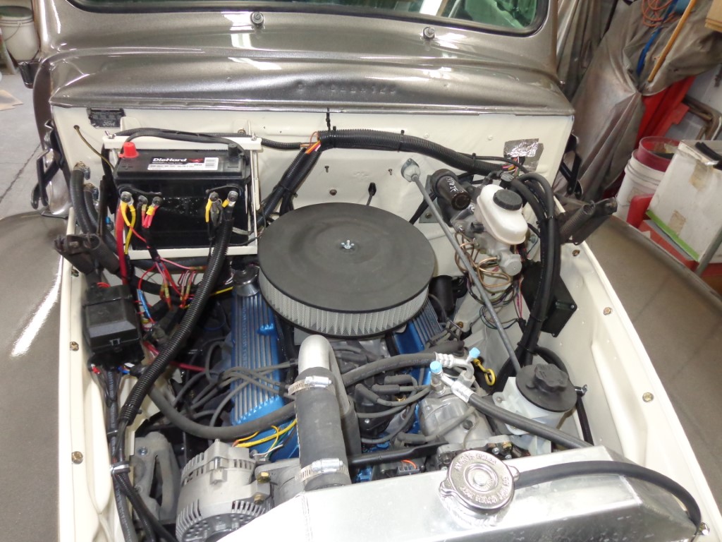

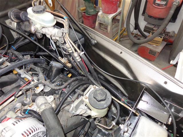

    This was the 1st install on the white 51. The truck had a 4.6 2 valve but the engine bay got full. I used factory lines on that one. The next unit I did had aftermarket plumbing and was way neater. More expensive but looked like it belonged on a rod. DSC02649.JPG
    Okie Pete, Dick Stevens and Roothawg like this.
