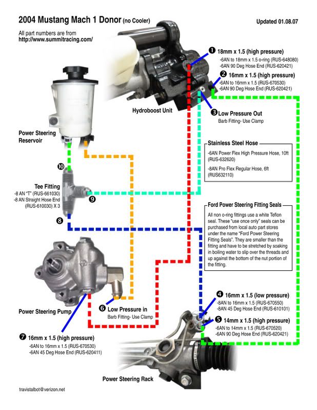

some models do use a cooler and some don't has to do with the rack and pump .. if you know what year and submodel ( gt .lx ect ) moosetang it came out of look it up to see if there was a cooler for it .

I'm running similar setup and adding a filter between the pump and hydroboost as well as an oil cooler to dissipate any additional heat.
