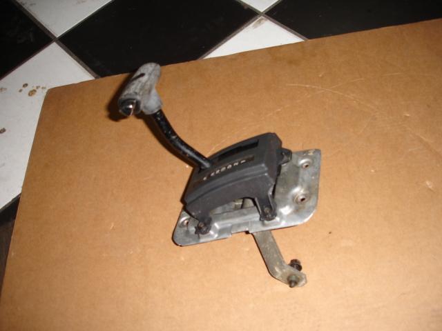

    Ok, working with a slant pan hydro and my experience with them is nearly nonexistent.
    1. Have you modified a shifter to work on a hydro? What kind and what did you have to do to get it to work?
    Could a cable shifter be made to work?
    2. What is this thing sticking out of the hydro? I’m talking about the rod with the universal joint in it. See pictures...

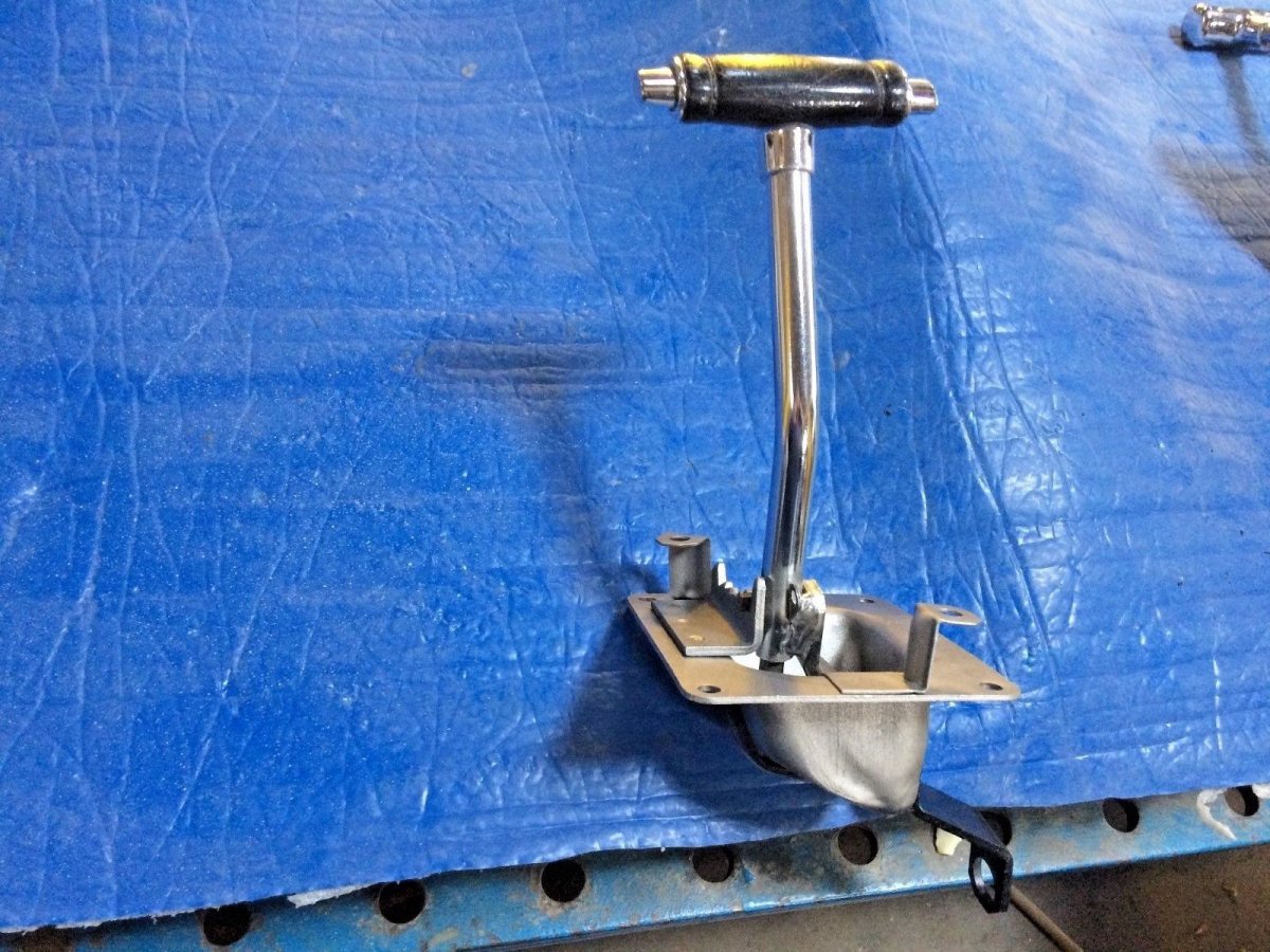

    That is a band release lever. I modified a Mustang II floor shifter for my hydro. Just welded and filed the MII detent to match the Hydro detents.
    Here is the shifter. Great self contained module.
    Just file the needed detents in this plate.
    I didn't like the hokey T-shifter so I converted it to a ball shifter that looks like a 4-speed. Saw this conversion in a rod mag years ago. Just lift up on the ball to disengage the detent and shift.

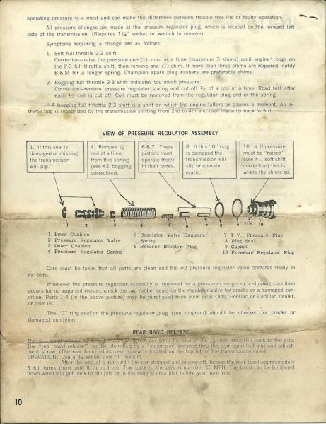

  8. warbird1
    Joined: Jan 3, 2015
    Posts: 1,355
    warbird1
    Kind of hard to read, but see the bottom of the B&M instruction sheet...

    Seems like it’s a towing thing. Some information from an old thread that I found. (I was curious as well)
    The rear band (3rd gear) is spring applied and hydrolicly released. Shut the engine off and the band is applied. Because the band is on while towing, it's the rear clutch pack that fries, not the pump. In the olden days, an aftermarket quick release handle was attached to the rear band adjuster on top of the hydro. The handle kept the band adjusment lock nut in the same position on the adjuster, and you could reach down from a sitting position and back-off on the adjusting screw without losing your initial adjustment. When you wanted to race, turn the adjuster down with the handle until the handle stops. You're in adjustment and ready to go. I don't remember what they called this handle but it worked great. It was used more for shutting down the engine so you could make a good plug reading after a hard p***. I don't have any pictures or drawings of the handle, I don't even have a handle. Anybody out there got one? I need one to take measurments off of for production. I will be offering band adjusting gauges. If I get a request for the ***orted rebuilding fixtures, I'll make those also. I'm a tool & die maker by trade and I've got a machine shop. A hydro that's out of adjustment is worse than a case of crabs.
