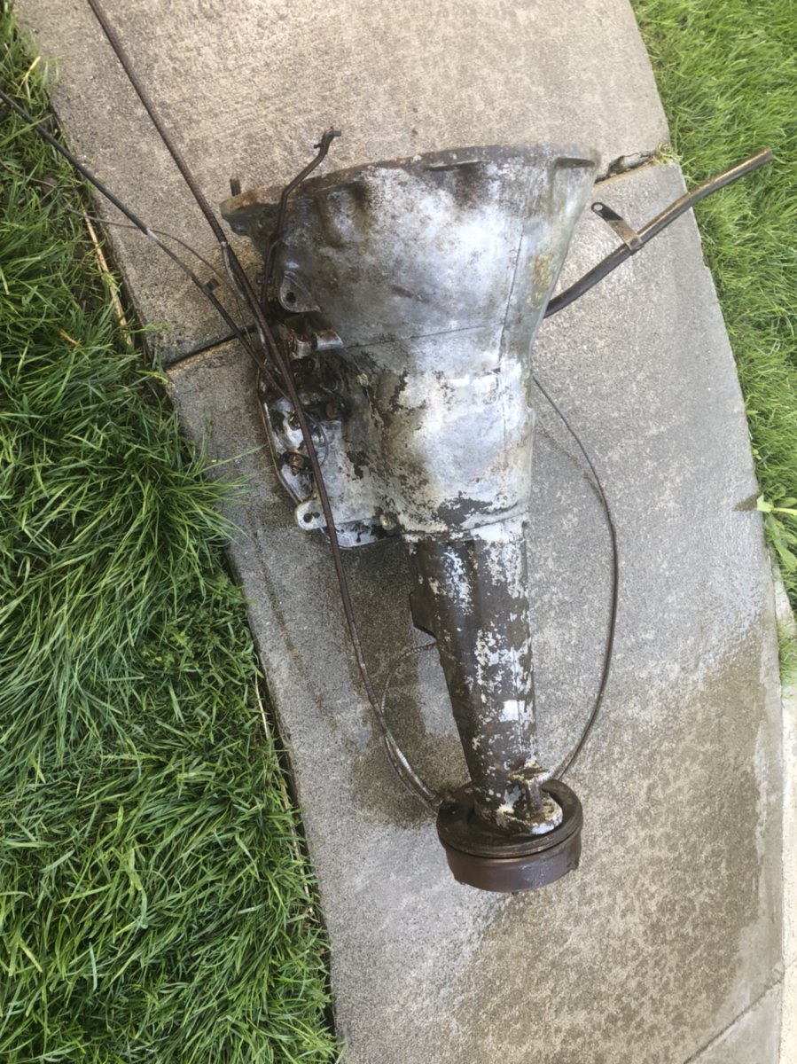

    There are lots of parts available for the 308, including some speed parts, but as somebody else said, it isn't a cheap engine to rebuild. That******* is nice in the sense that it has an overdrive, but a******* from a later Hudson would probably be easier to find parts for (also available with overdrive). The clutch is peculiar to Hudson, being a wet clutch, but it works well and parts and service are available. Either of the manual transmission are maybe just a bit weak but the Hydramatic is very tough indeed, and not cheap to rebuild either. It won't downshift like a modern automatic will, so you might not like it. The manual******* and Hydramatic have very different rear mounts (at least in a Hudson) so you would have to decide that pretty early. That's my worthless .02.

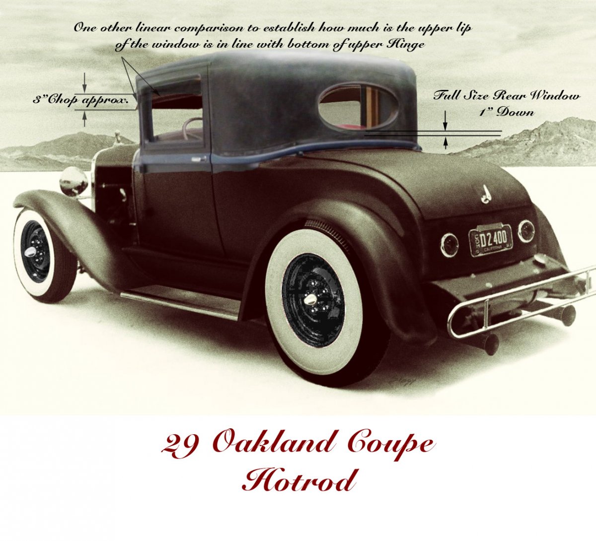

    Some inspiration for you @Wurger
    Mild Chop, No Hood Sides, Modded Tailights, Nerfed, Scavenger Pipes,
    Your Vintage Drivetrain with WW's, Solids and Spiders

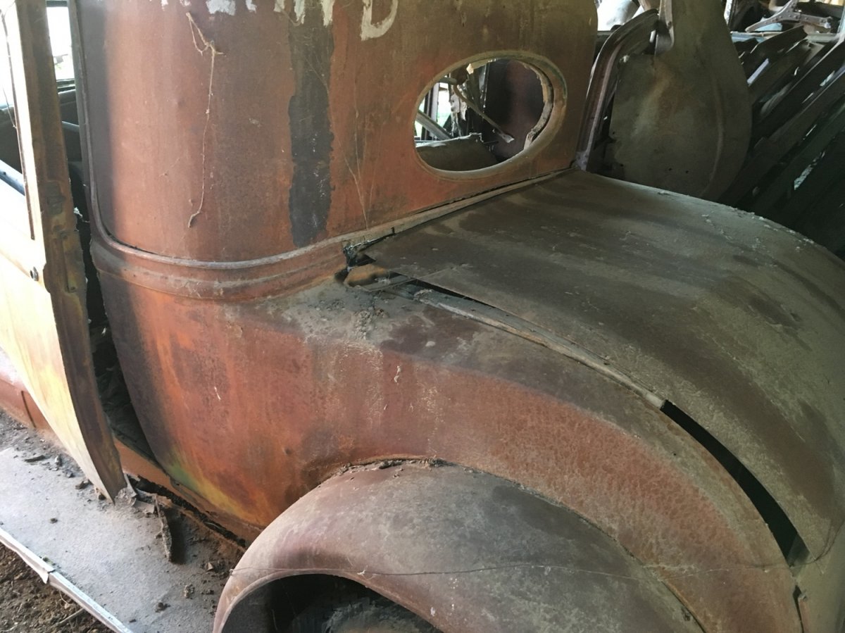

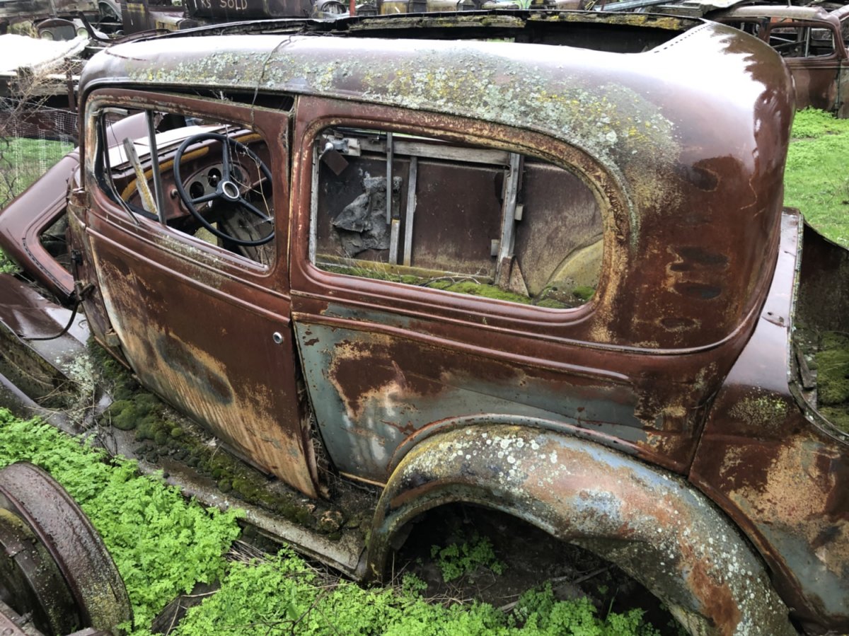

    Oakland is an [early], square, car, "most" of the wood will have only a slight "bow"...
    the newer car will have a little more bow and a lot more wood...
    doesn't matter if you are a cabinet maker...
    but if you are going to replace it with steel tube the less bow the easier to replicate...

    If you already have a Hudson 3 window with a rumble seat in the works, sell this stuff and put the money towards finishing up the Hudson 3 window.
    Both the other cars in question need the wood replaced, that in its self is a huge, expensive project. Then there is the motor & trans that both need to be rebuilt, another pretty expensive undertaking. I can't imagine what a "kit" would cost to replace the Hudson trans with the Mopar trans, and then you still need to rebuild the Mopar trans. You haven't even really started building the car yet.

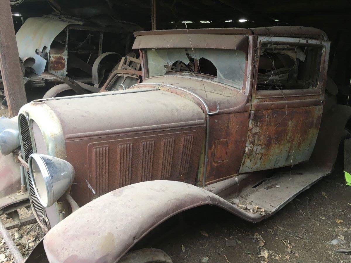

    Hey fellas, I’m still collecting parts for it, with stogy’s awesome art work it’s a keeper in my book, The fenders especially on the passenger side may be a little bit beyond saving so we shall see. I’m still figuring the best way to support the body, I enjoy restoring cars as well so the Oakland would be my go to during the long process of looking for parts for my other rigs. The three window Hudson btw has little to no wood, so no problem there mine is a true Hudson Murphy body made of thick steel, The only wood of note is for the roof covering.

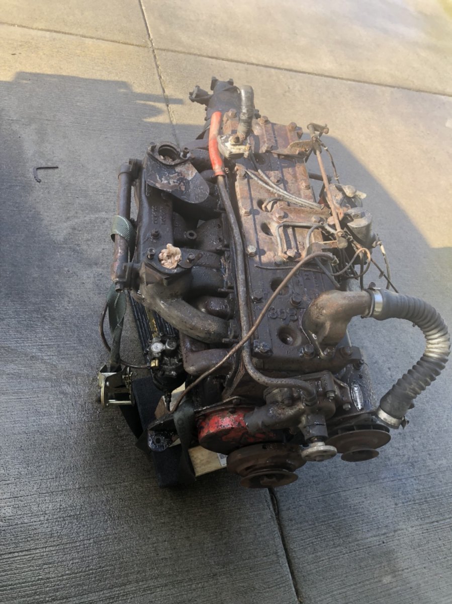

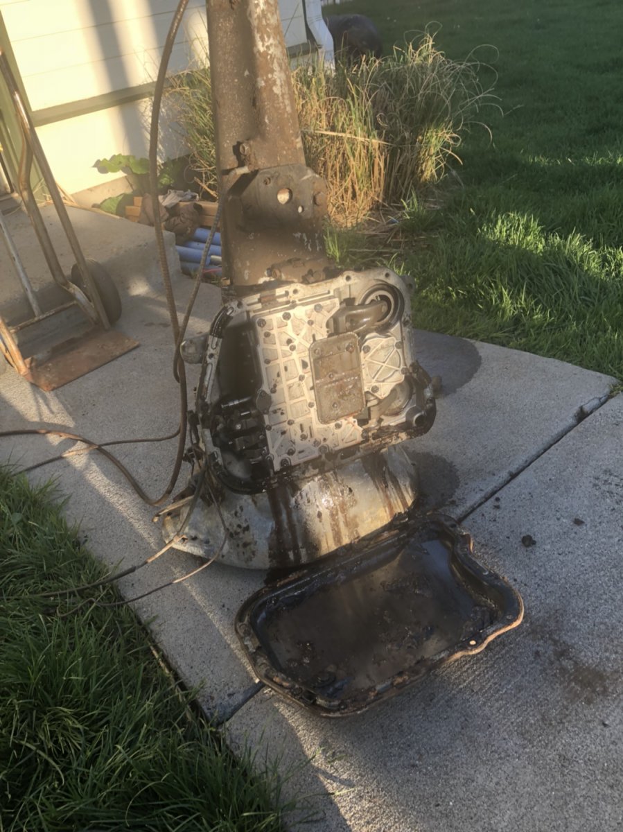

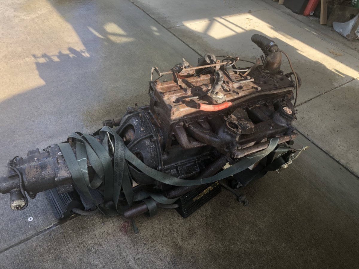

    Still planning or rockin’ the 1954 Hudson Hornet Twin-H 308, the Oakland has an “ All American Six” in it which is quite large so there will be no need for stretching out forward or recessing the firewall. The transmission attached to the 308 is a 49 Hudson Commodore three speed with overdrive, still wondering if I should rock that or get the Hydromatic transmission that would have been attached to the 54 originally, it’s the same bolt pattern so there is no issue at all as it is mechanically speaking and it will run perfectly fine as is, any thoughts?
    Stogy likes this.
  17. Dwardo
    Joined: Aug 1, 2017
    Posts: 71
    Dwardo
    Well, if you decide not to use the Hudson, remember that you have what looks like a complete Twin-H manifold with all the linkage and you can sell that anytime. If the engine turns over it's worth some too. If it were mine I'd keep the stickshift but get a later (52 and up) transmission, but that's just because I like a stick better than a Hydramatic, but that's just me. I'm guessing you could rebuild the later transmission cheaper than you can rebuild a Hydramatic. You need to make your mind up about this pretty soon because the stick and the Hydramatic have very different rear mounts. On the Hydramatic there are two mounts which are actually mounted to the bell housing so you would need that. The stick is a conventional single mount and may be easier to work with. I really like the idea of a Hudson powered Oakland, but I'd try to get a handle on the condition of the engine because as I've said. they are not cheap to rebuild. Don't let that manifold and linkage get away too cheap though.
