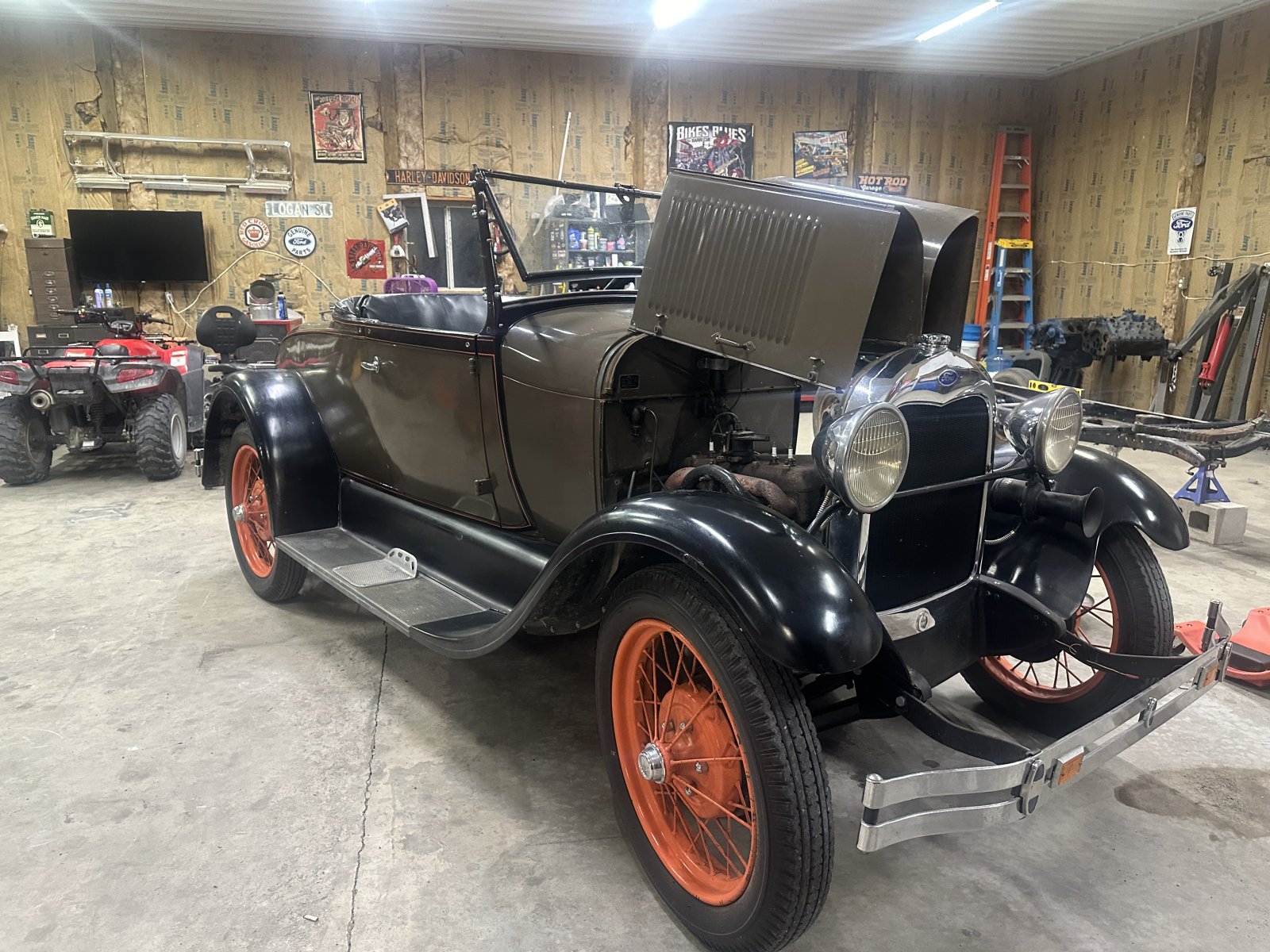

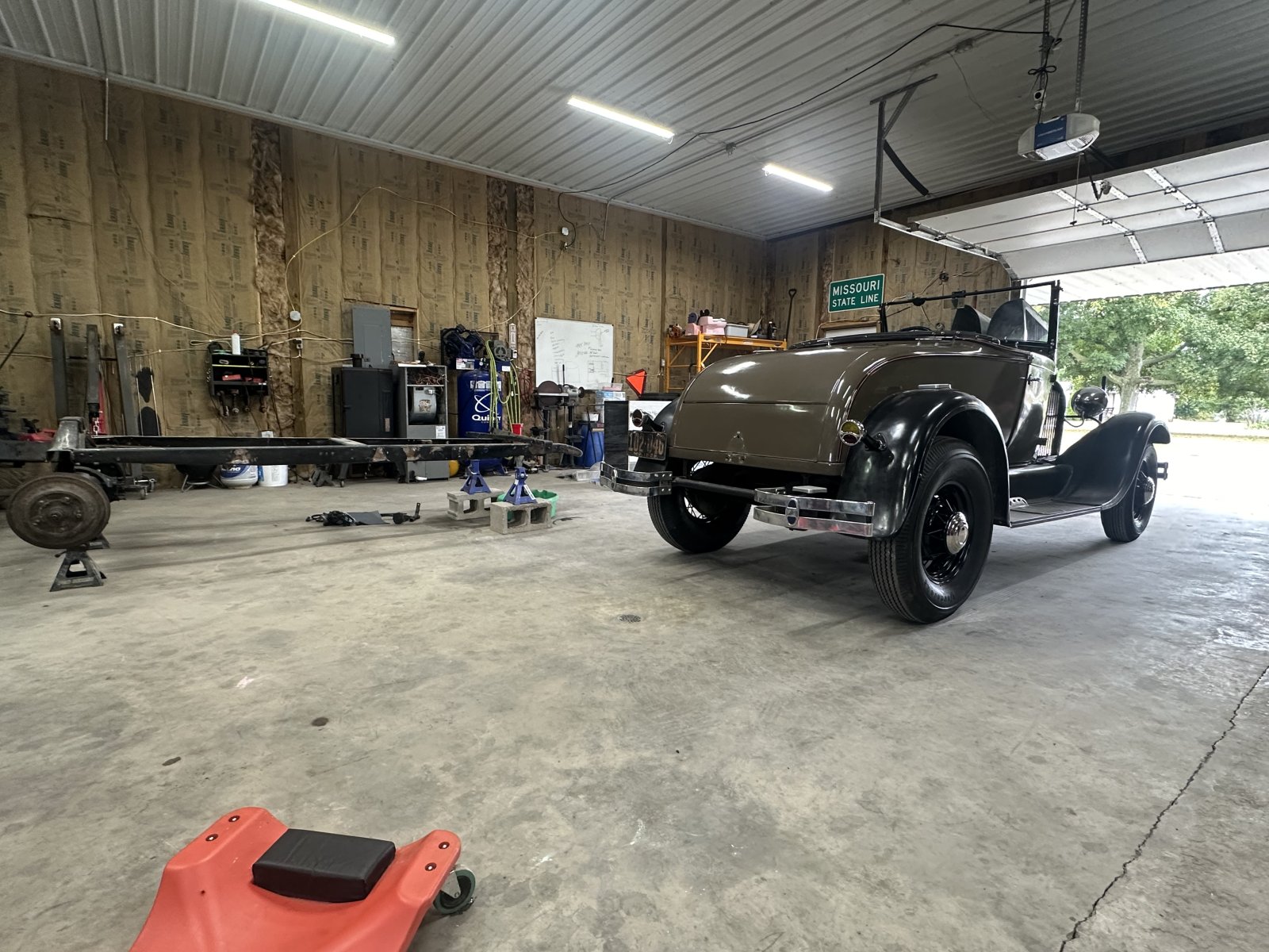

  1. My AV8 build has been dragging along. I decided that I should look for a decent roadster body for it. Something to give me a kick in the pants to keep moving on my build. Needless to say I brought this 29 roadster home,
    Having driven the car some over the last month it has become clear to me that I need two hot rods in my life!!! A banger powered roadster and it’s bigger brother an AV8 roadster lol.

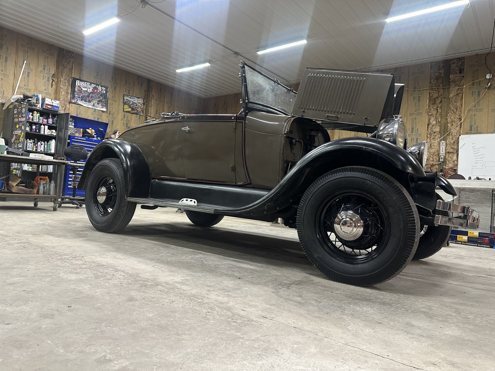

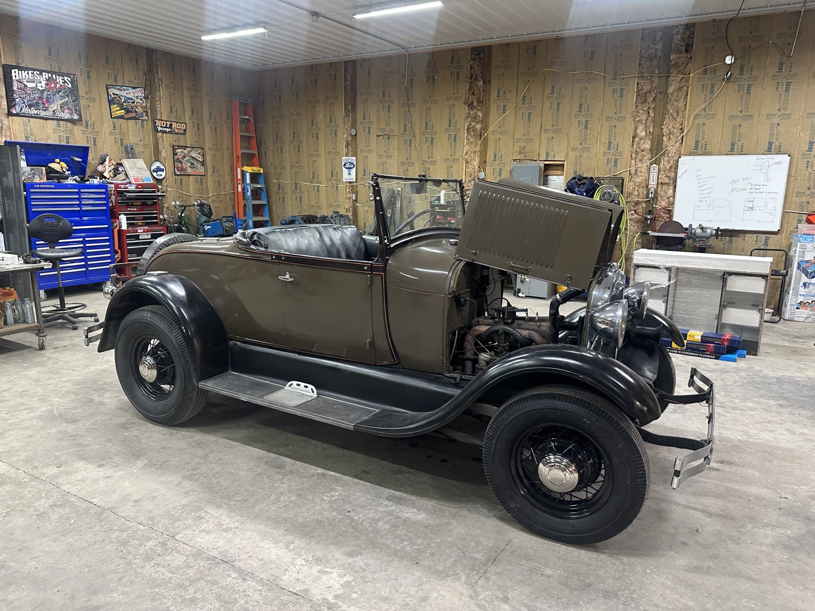

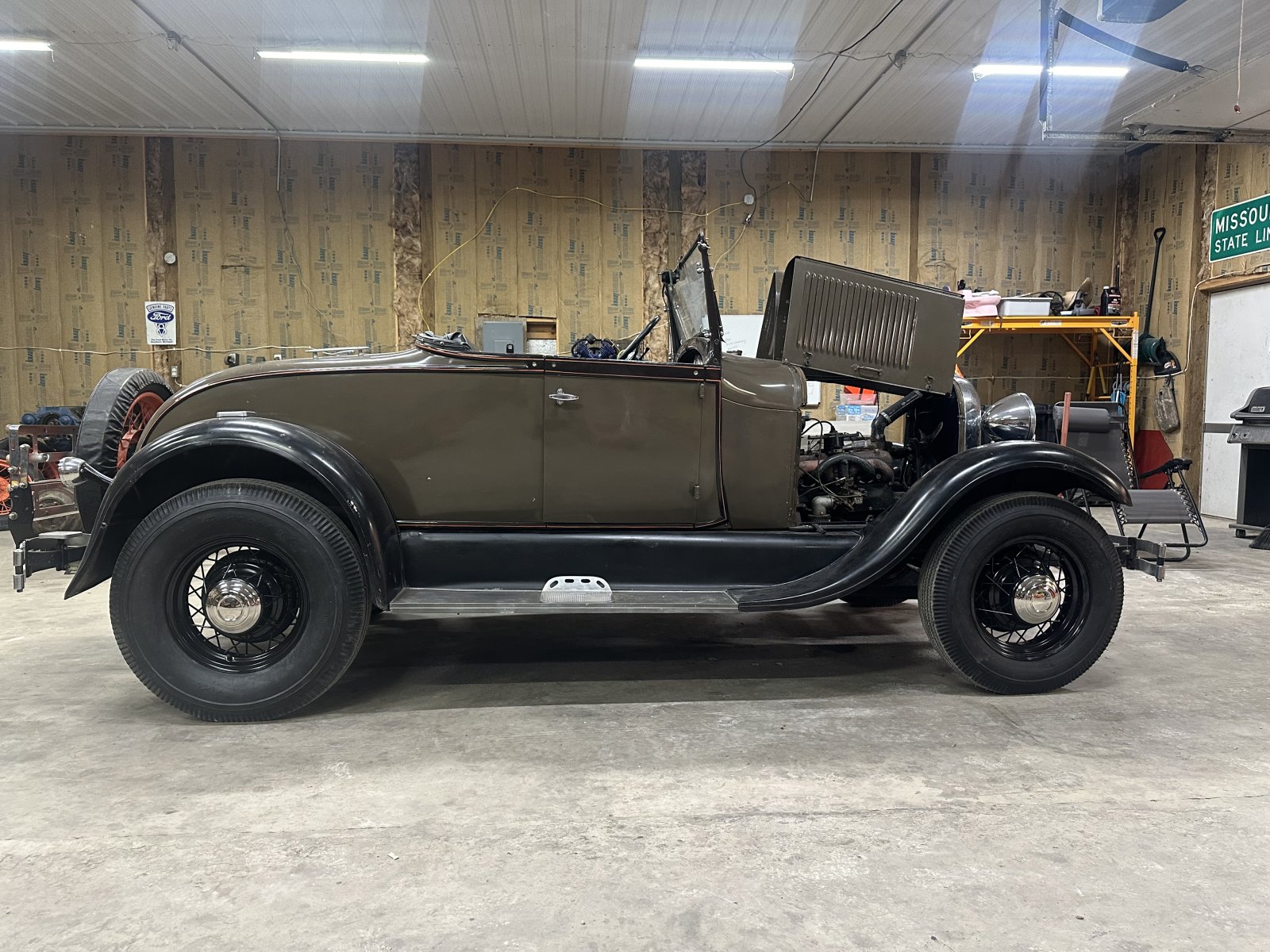

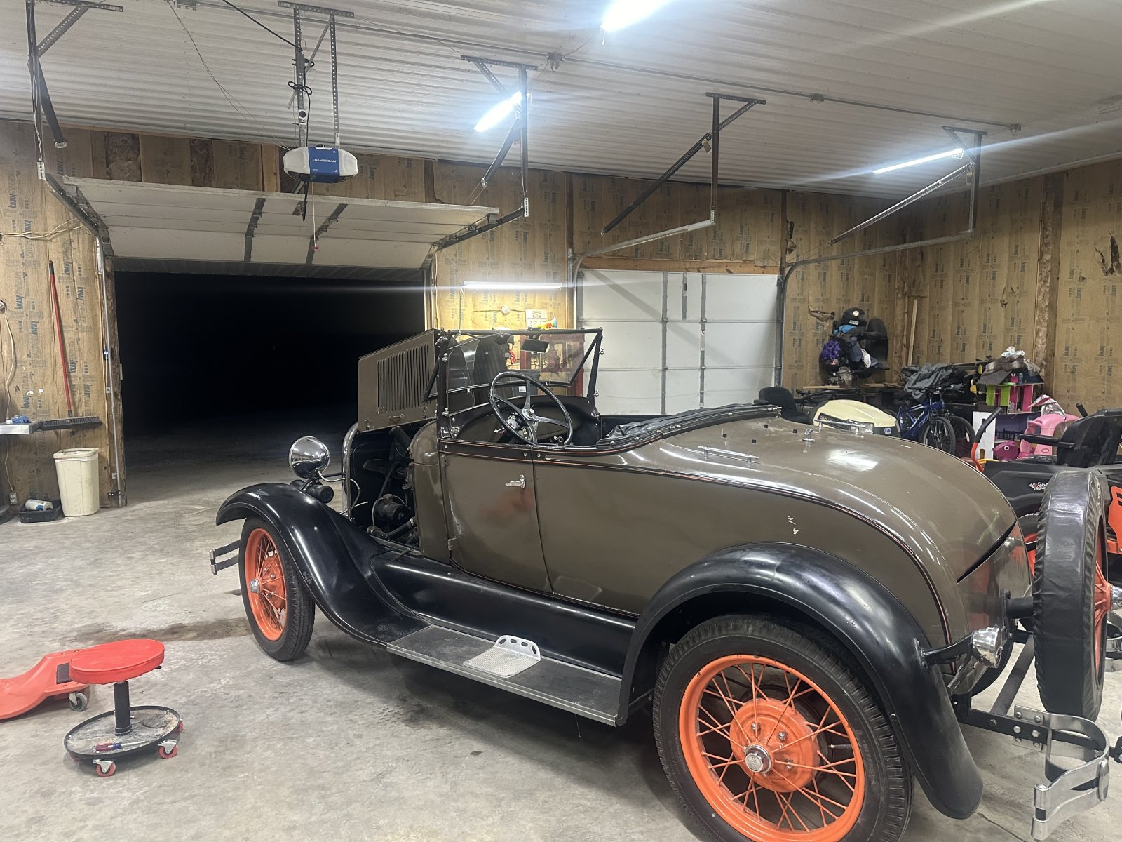

  2. Decided the 35 wires I had powder coated for my other project might be just what she needed. Now I got to get my other set done to replace the ones used.
    Really quite amazing how much wheels and tires can start bringing a car around! What to do next? For several years I’ve been collecting parts in hopes to build a nice traditional style hot rod. IMG_8887.jpeg IMG_8884.jpeg IMG_8885.jpeg

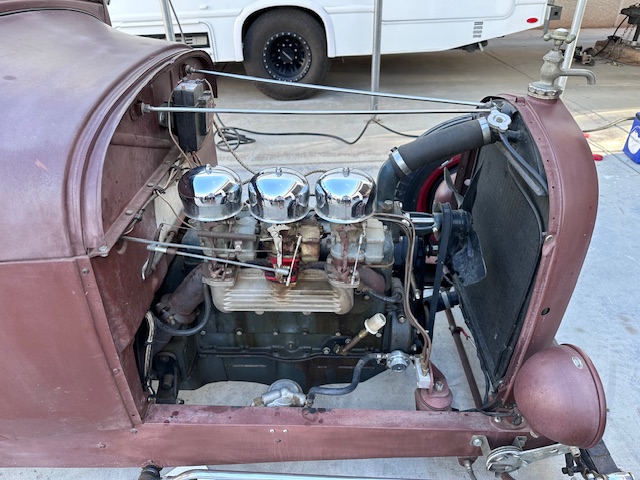

    I'll probley get flamed for this, but... carb, manifold , 7.0 head, headers, ... really wakes theses motors up to be plenty of power and they run with traffic with ease....you have to do the same thing to the flathead motor... bangher motors are cool ....keep in mind I don't know nothing about anything IMG_2900[8830].jpg IMG_2662[8761].jpg IMG_8808[8524].jpg

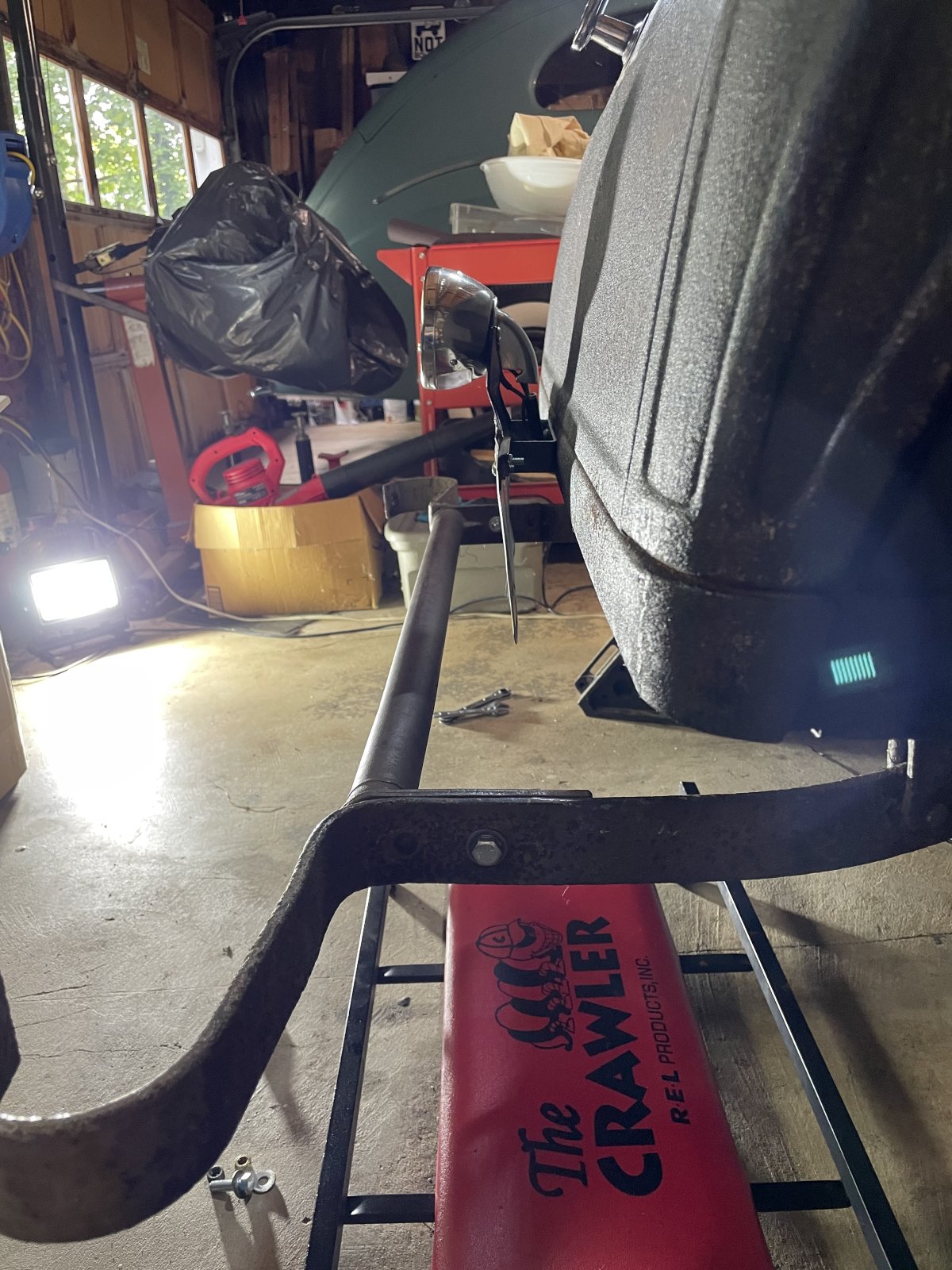

  10. Thanks man I really appreciate that! I can’t wait to get these two mated together! IMG_8904.jpeg IMG_8905.jpeg

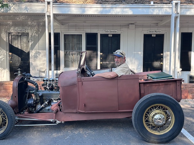

    I've had two flathead powered A's and one with a warmed up banger and I'm building another banger powered A. My avatar was powered by a V8 60, I built it in the early 90's and was never happy with the V8 60. I built a 30 pickup with a B motor with a Winfield head, Ansen intake, Holley 94 , header and a Mallory distributor, ran great and drove it for almost 20 years. Then I built a 30 Sport Coupe with an 8BA flathead, runs and drives good but starting on a 29 Roadster Pickup that will have a warmed up banger. Not a highway cruiser but I really enjoy the bangers.

    My vote for next step on the Roadster is reversing the eyes on the main springs and pulling a couple leaves to get it sitting more like a hot rod.
