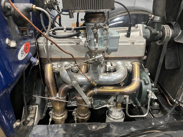

    Nice start! I like bangers too![​IMG][​IMG]

  3. Super cool man!! I need an intake like that! That's the look man!

    Thanks! Since those pics. I put some bent spoke Kelsey Hayes Wheels on it and reupholstered the seat. I also put a 39 trans in it with the Clings adapter, what a difference. More recent pic

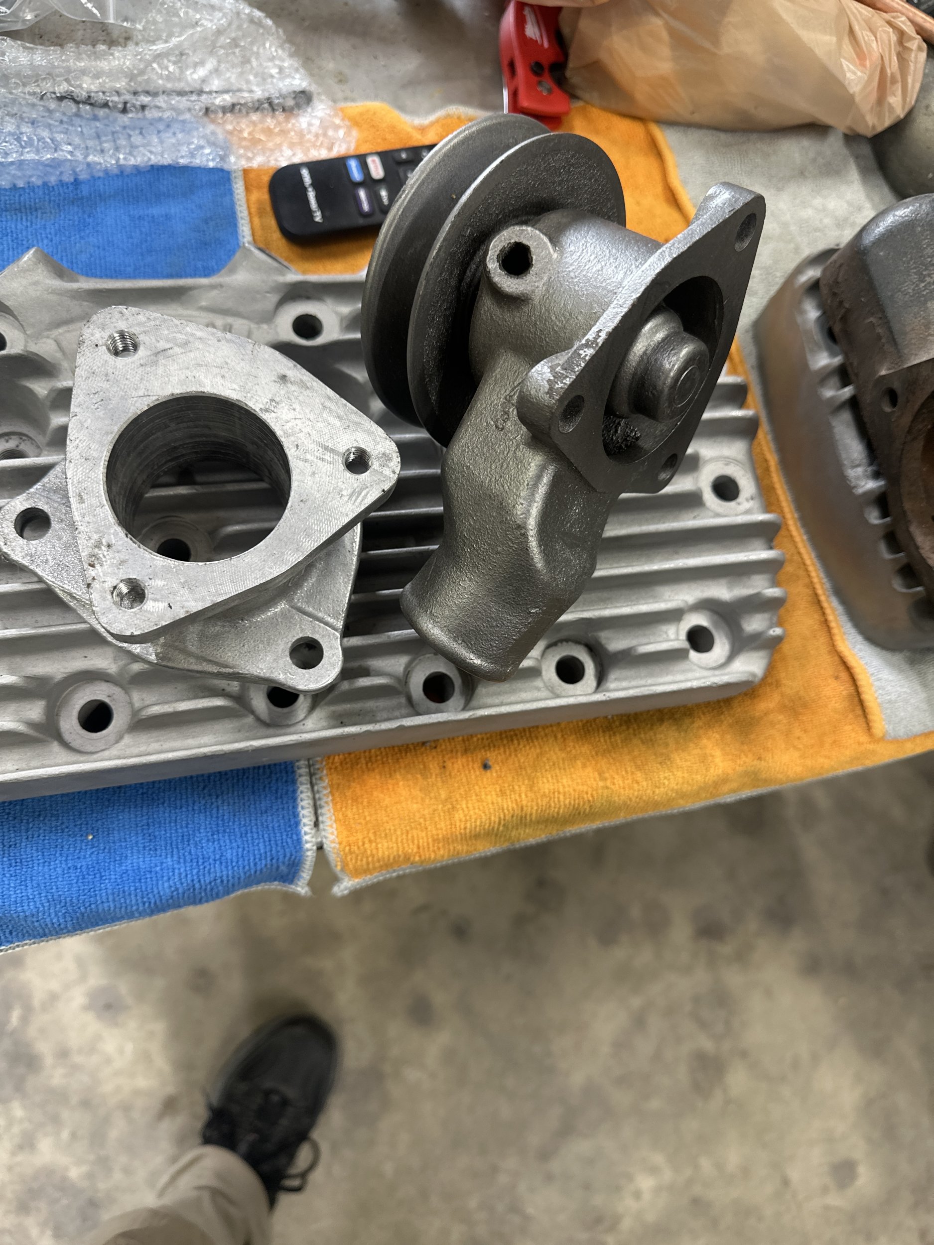

  8. Picked up this intake. Looks like it’s been modified a little but I still like it. IMG_8974.jpeg IMG_8973.jpeg

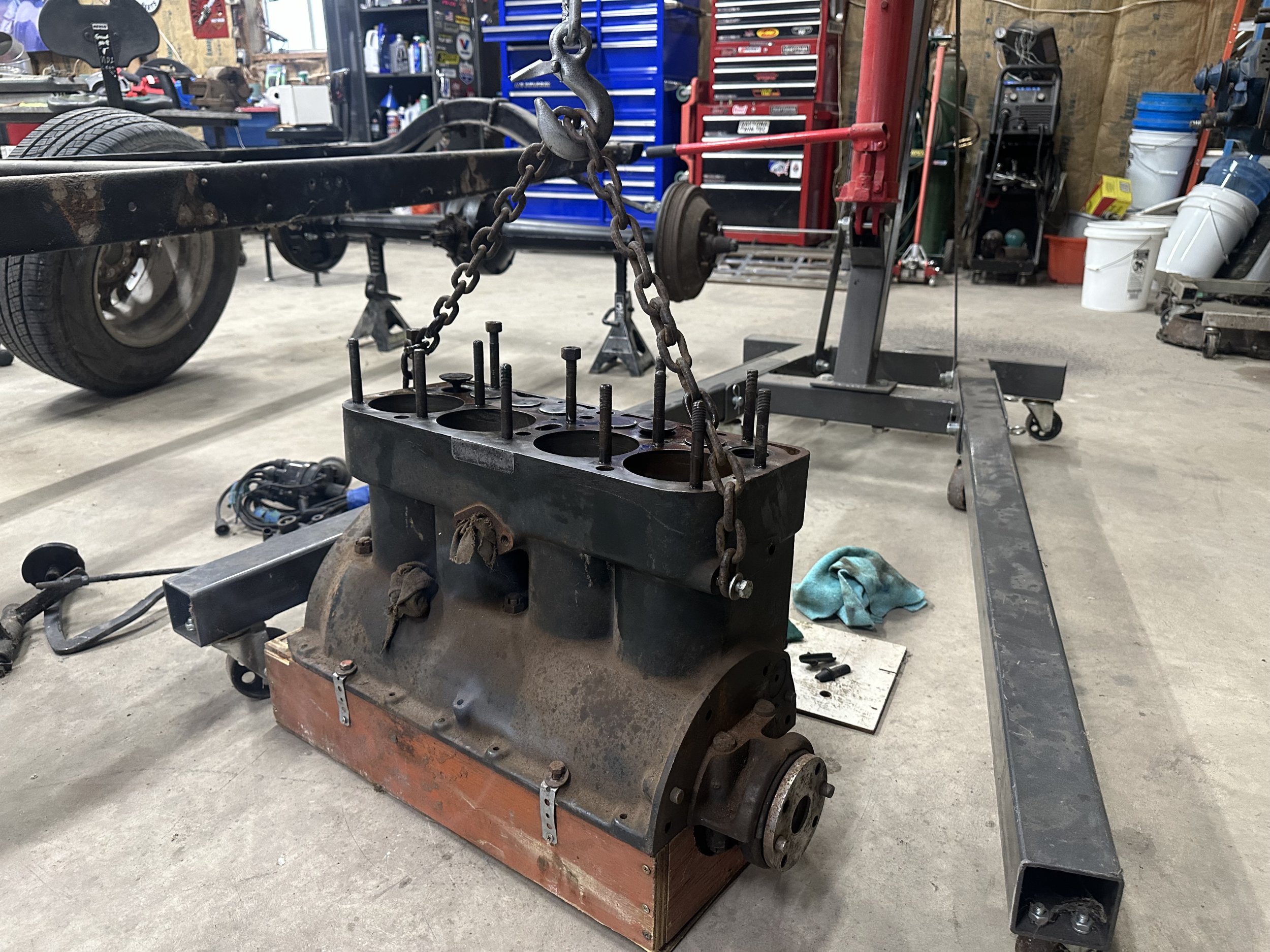

  13. Stumbled across this old thing this weekend. I’ve been wanting to try my hand at ***embling a motor so maybe this is the one! I hate everyone paying to get Babbitt work done in there area? IMG_9048.jpeg IMG_9042.jpeg

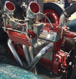

    I would run a Model head to get rid of that 3 bolt water pump. The 3 bolt water pumps are getting hard to find. Of course that includes speed heads built for the Model A. If you run a stock Model A head there are a couple of water p***ages that need to be plugged. Be careful there are two 3 bolt water pumps. The '32 is longer and is what you need in a Model A. The '33-34 is shorter due to the sloped radiator (see first attached picture). I have also attached a photo of a nice looking engine that I saw at a show.

  17. It came with this pump and adapter. Unsure on if I will use it or not. image.jpg
