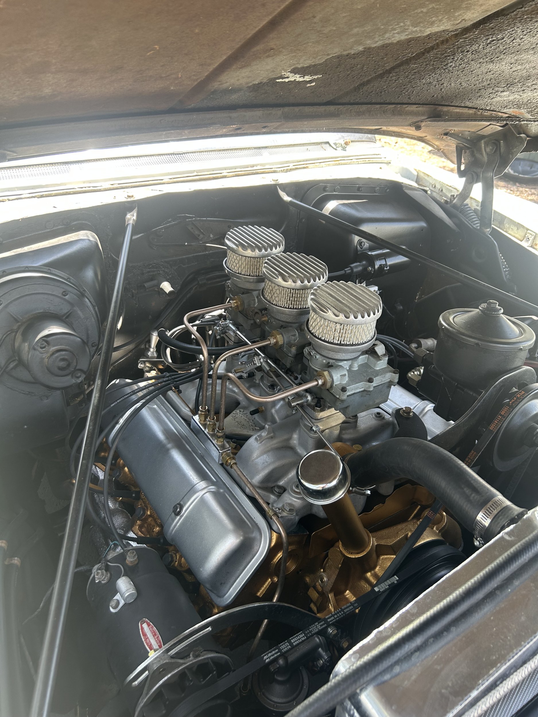

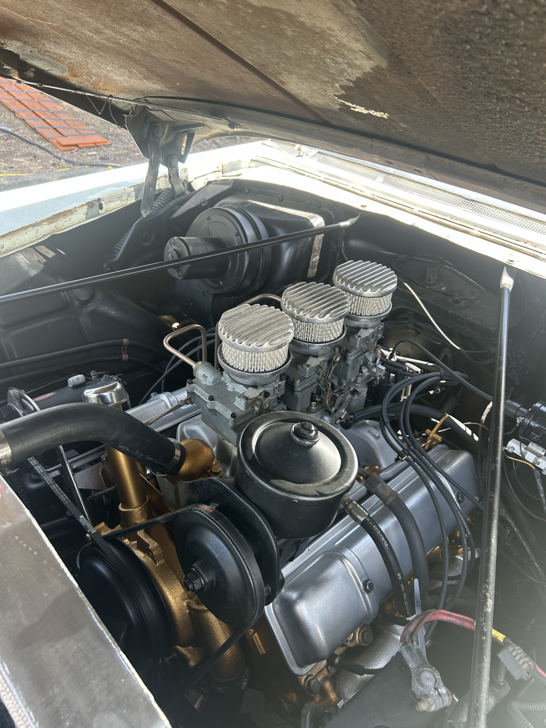

    I should start this with an apology; I put this car back together without a build thread, and I came across a lot of problems in the process that I was able to resolve and should have been do***ented. I get a lot of enjoyment from the build threads here and I did not contribute myself, and I apologize for that.
    The story goes, I bought this car in 2010 in my early 20’s, and drove it almost daily until 2012 when it broke down in Long Beach. The 4 speed hydro had snapped a band, and it came home on a flat bed. Even then guys who knew how to fix them were getting scarce, so I shelled out the cash to have the case on a spare th400 I had laying around adapted to early olds V8 by Ross Racing. I also took the engine apart, and found the block had been bored .030 over but the crank was not turned, nor were the heads reworked. I had that machine work done, partially ***embled the short block, and sent the heads to a very good but unreliable machine shop. After 9 months I got them back, but I had lost steam on the project and there it sat, for about 12 years.
    Fast forward last year- I got engaged and decided a few months later after a dream that I should use the car as the getaway vehicle from the wedding. The short block, heads, transmission, car… Everything had been sitting. Some things still needed purchasing, which still (of course) added up to thousands of dollars. To top all of that off, about this time I went into business for myself, so the budget was really tight.
    I worked on it almost entirely in the evenings after dark, sometimes staying up as late as 2 am. This is part of the reason I did not do a good job do***enting the process- it was full speed ahead whenever I had time for it. I used to travel extensively for work, and luckily I was only away for about 8 weeks total this year. Despite that, I got the car moving under its own power only about a week before the wedding day. The wedding was in my backyard which took a lot of my time preparing, and I was lucky enough to have a good neighbor who is a (very recently) retired fleet mechanic and was willing to help with some finishing touches like brakes, actually washing and vacuuming the car, etc… It was that close.
    Got married on Saturday, and the car took us to the hotel and back, just as planned. It thankfully waited until Tuesday to develop a sticky lifter, but that and this is where it is at currently. I will update with anecdotes and incidents along the way as I have time, as well as progress going forward.
