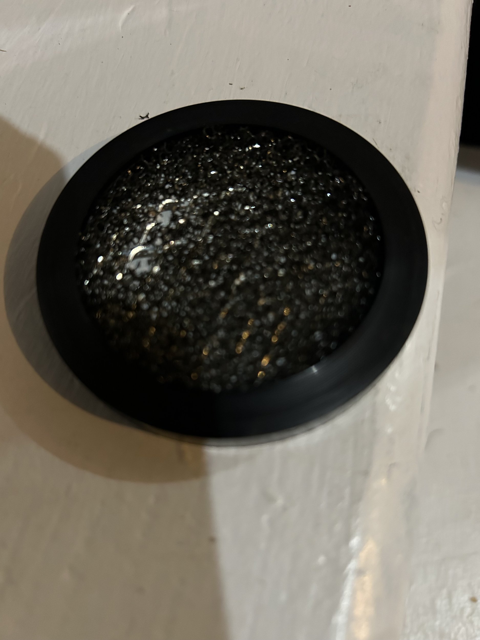

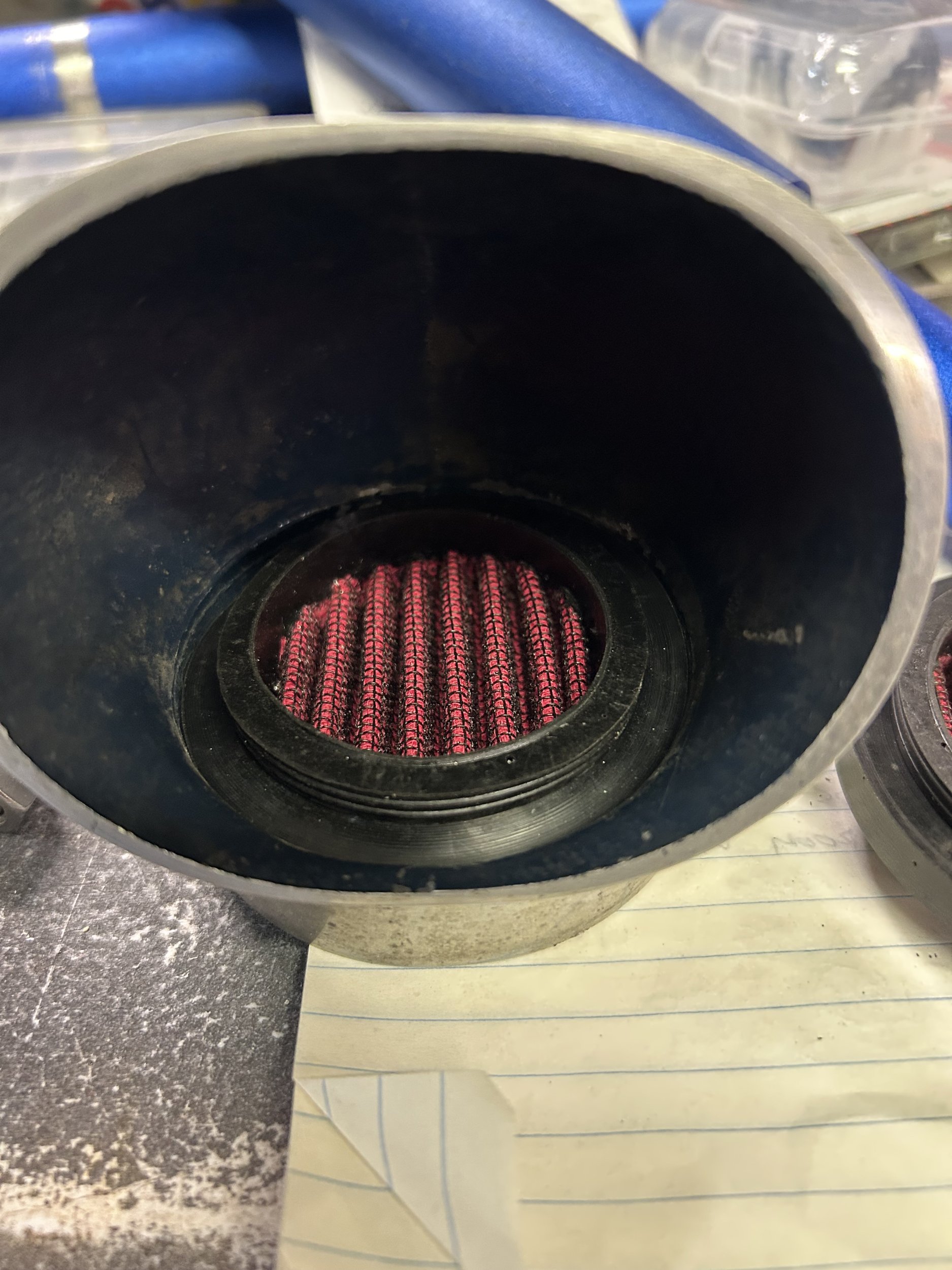

    I am looking for a vendor that sells these air cleaners. I run frog mouth air cleaners and this is an insert for them to keep debris out of my carbs. They last about a season snd I bought 4-5 pairs a few years ago but cannot remember where ….
    Any help would be appreciated ….. thanks!
    If you do not replace them soon enough the wiry black foamy stuff can get sucked in - aka, the two holes in the ac filter in the second pic …. ahem …..

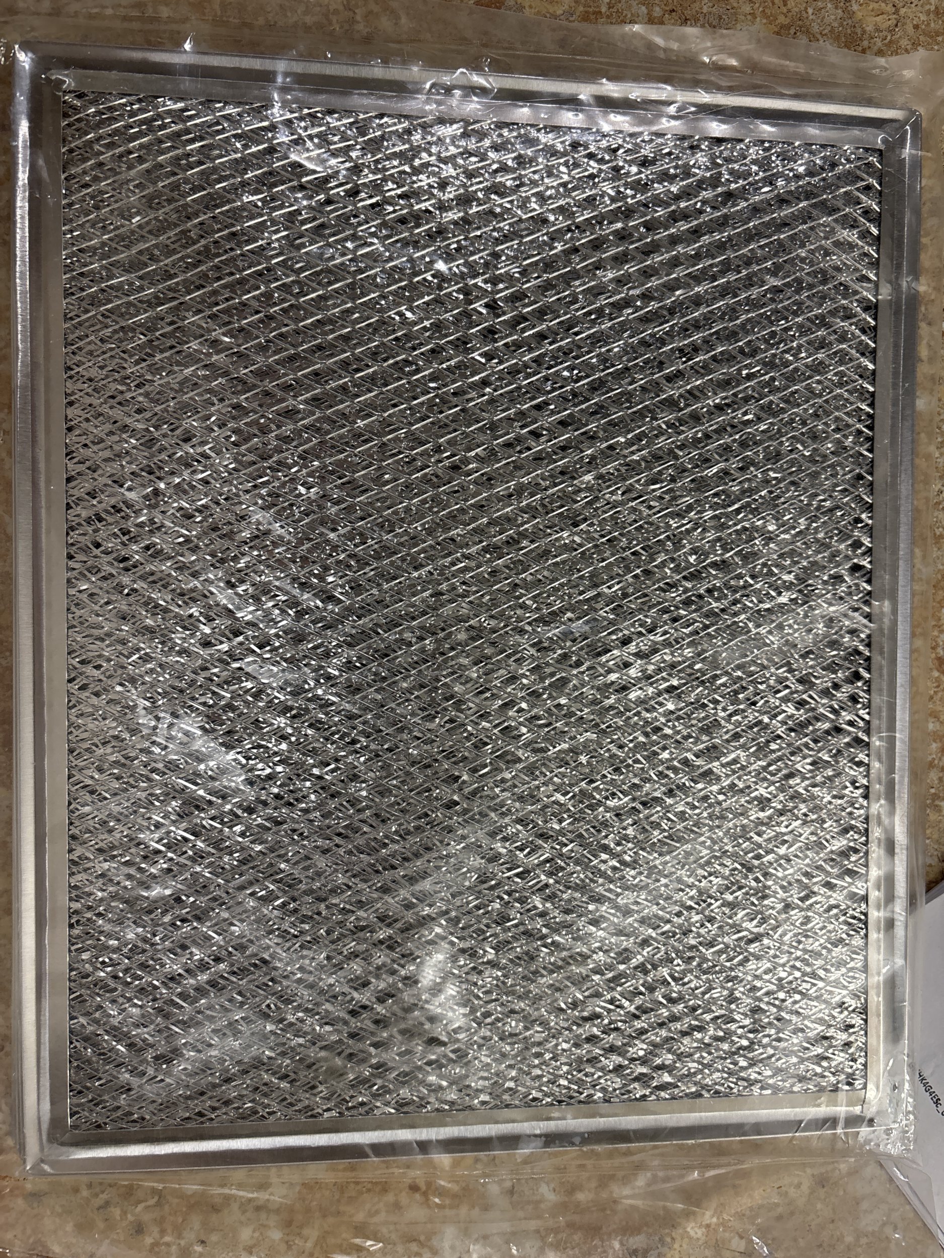

    image.jpg That almost looks like the filter material for my vent hood over my stove. You could go to a hardware store and buy a couple of them and cut them up to fit your housings
    lothiandon1940 and TomT like this.

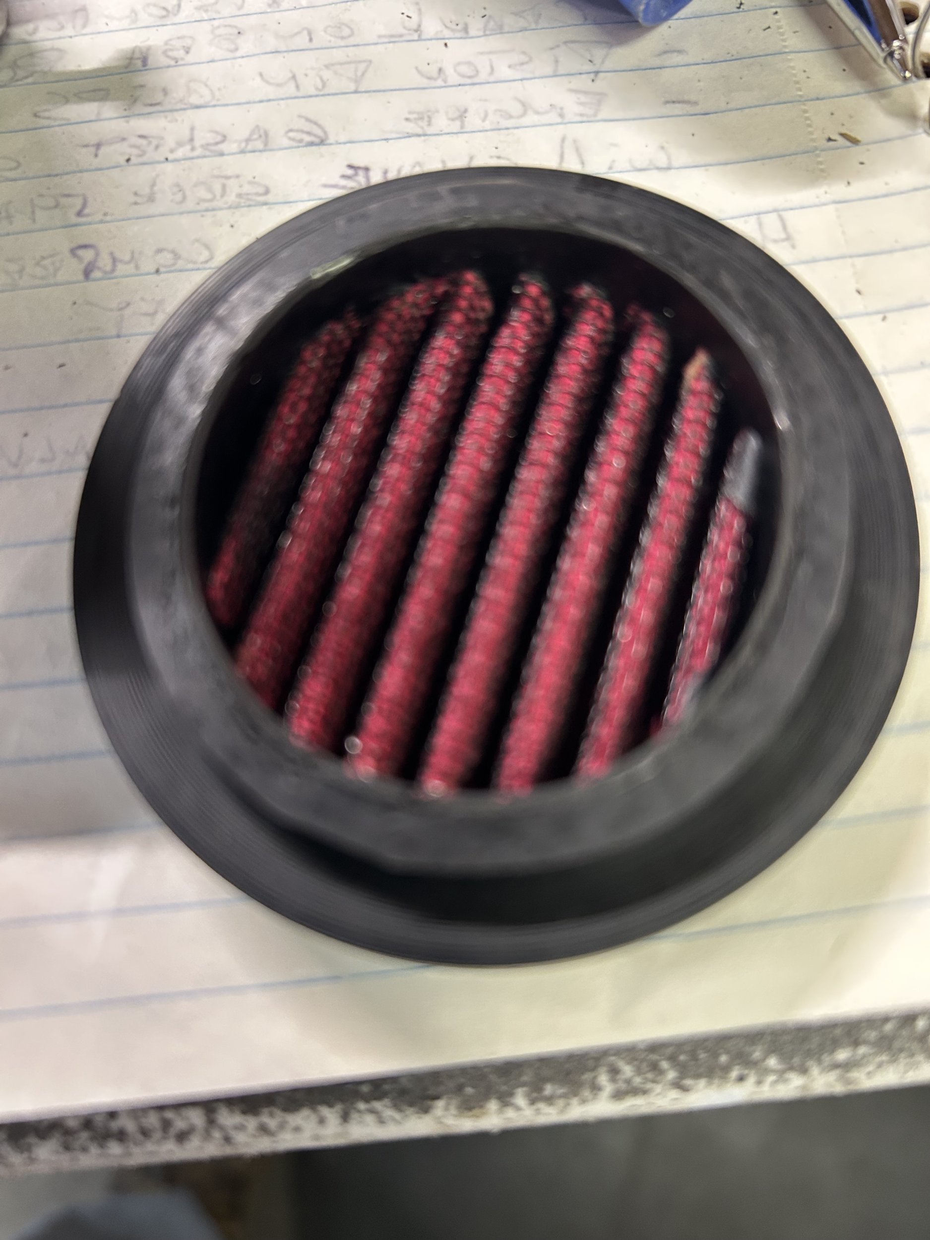

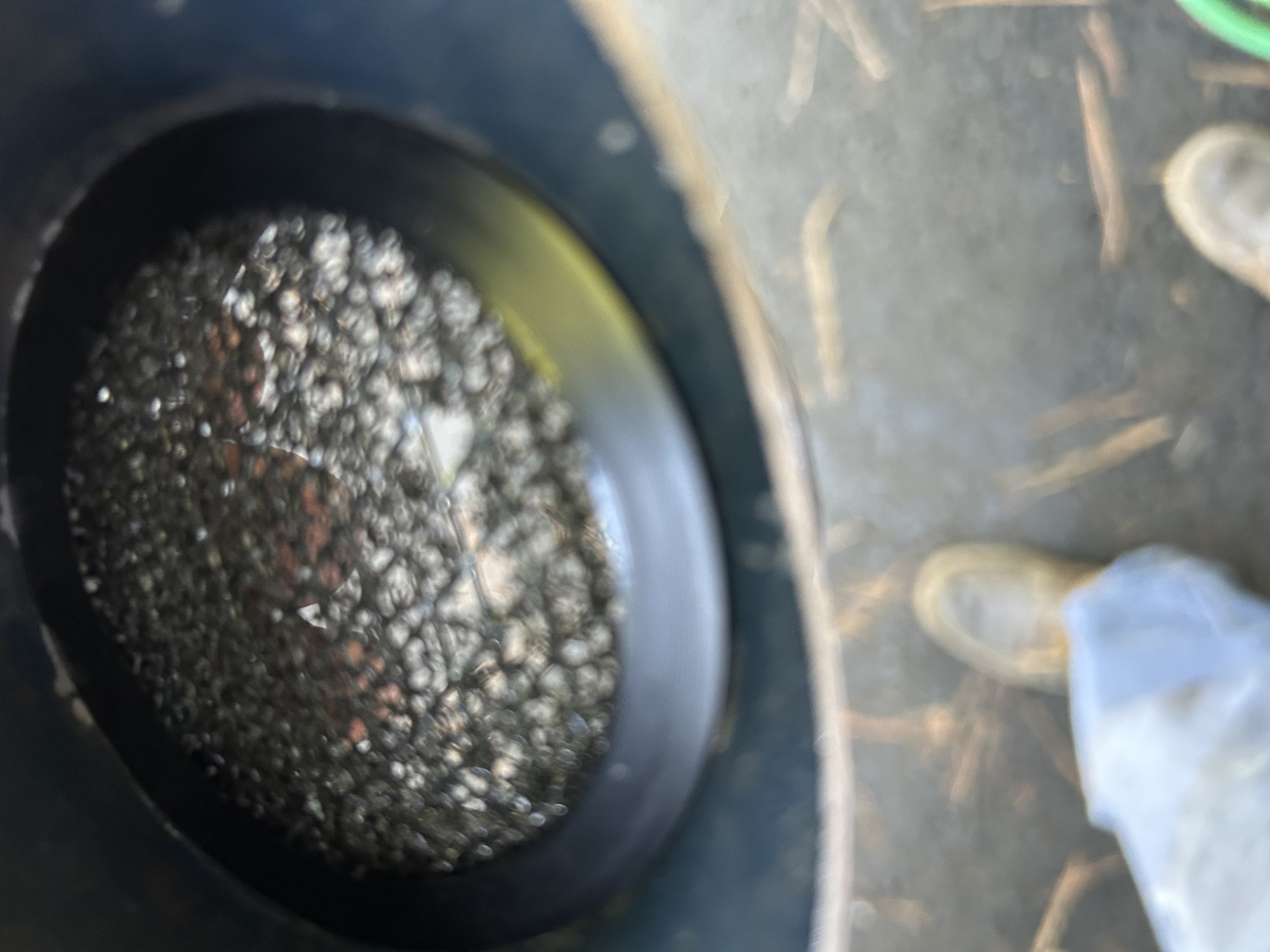

    Well, the gentlemen who was making the the air filters I am looking for has passed and no one is making them at the moment. Awhile back I bought some stack ac’s used in drag racing hoping they would fit the frog’s mouth units but they are too small. So in just fooling around I removed the wire mesh and gauze in the old units just leaving the rubber rim. The too small ac units actually fit into the rubber ring of the old unit:
    old unit
    and squeezed it into the frog mouth …
    It actually is quite a snug fit. What I am concerned about is that the cleanable filter is too restrictive. So, although I can drive it for now, I don’t believe it’s a permanent solution. So I am on the hunt fir a suitable replacement ….
  9. lostn51
    Joined: Jan 24, 2008
    Posts: 3,153
    lostn51
    from Tennessee
    I’m kinda digging the new filters! They should be able to flow as well as the others and the fact that they can be cleaned a reused is a huge bonus. Great job;)

    I have ordered some black 3/8” thick foam for air cleaners from a race car shop with the hopes of replacing the gauzy stuff with the foam retaining the metal mesh as a guard against sucking it in. I will prime and paint the mesh with high heat paint before installation to slow rust formation
