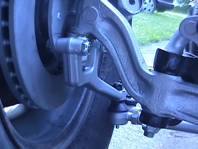

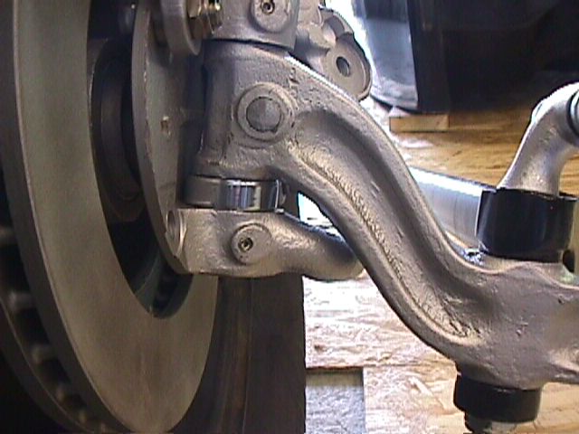

    Here are some pictures of the Superbell aluminum 4" drop under my '32.

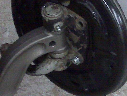

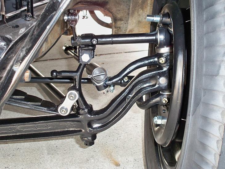

  11. Here's my 40 Ford dropped axle from Nostalgia Sid. I used the CE bolt-on steering arms because I thought the design was superior, and because they have the most clearance of any of the others I've seen. I didn't trust myself to heat/bend the arms. Actually, a 4" drop is measured from the bottom of the center of the axle, and is not actually "dropped" 4 inchs...

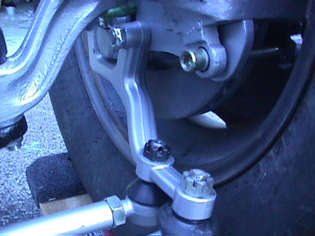

    A few phone pics.
