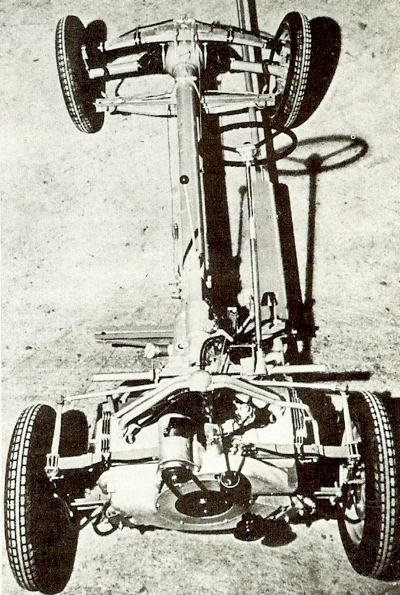

    Back bone style. IRS & IFS
    No transaxle though

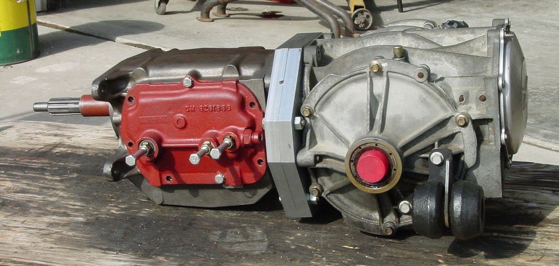

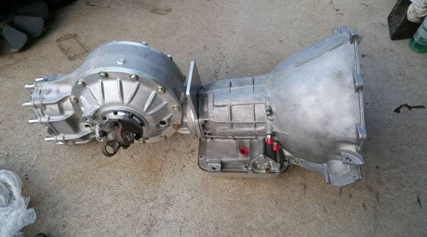

    That was one of the examples I came across in my research. I believe it's a winter's quick change with a shorty powerglide?
    I've also seen the one below in the Corvair v8 forums where they bolted a 4 speed gearbox to a c5 corvette differential. Just haven't seen one bolted to a banjo rear to keep it "period".

  19. That first pic is not a power slip looks like it may be a sag 4 speed.
    To bolt one to a quick change wouldn't be much different than to bolt one to a banjo. They are basically the same rear. I am guessing that there is a reason to spend all that time and money aside from wanting to be different? It won't change your unsprung weight. I suppose that it will change your weight distribution and I am guessing that is what you are after?

    Indeed, the picture I posted is a saginaw 4 speed bolted to a c5 differential as mentioned. The powerglide was the one mentioned in the quote. Yes, looking to lower unsprung rear weight and better weight distribution.

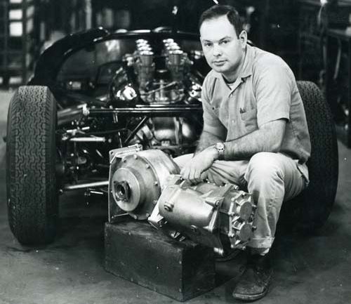

    In the early days of the Can Am series, Bob McKee mated a B-W t-10 to the rear of a QC to make a transaxle. Capture mckee.JPG

    Yup, I stumbled across that one as well. Seems that the t10 was rotated 180 degrees and flipped almost upside-down to get that to work. From what I read the reverse gear was in the tail of the t10's, thus when the transaxle was built and the tail removed, it no longer included a reverse gear
