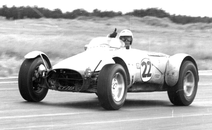

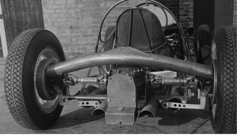

    Here are a couple of pics of my Mallock U2 Mk6.
    ( which was the last type with the swing axle front suspension, the Mk7 has double a arms,
    and BTW, was not as quick as a Mk6 )
    The IFS front suspension is built out of the I beam from a Ford Pop/Anglia, cut in the middle, and then both pieces were lengthened so the pivot point for the RHS is on the left, and the LHS is on the right.
    Kinda like a Ford Twin Ibeam, but with carefully developed geometry ( lengths of the swinaxles, height of the pivot points, and placement of the R & P so there is no bumpsteer, etc ), as well as the right spring rates & shocks.
    In the pics you can see there is absolutely no trace of the outside wheel trying to tuck under like early Allards and others with the same kind of suspension used to do.
    It handles like a typical single seater of the period ( mid '60s ), which is pretty damn good...

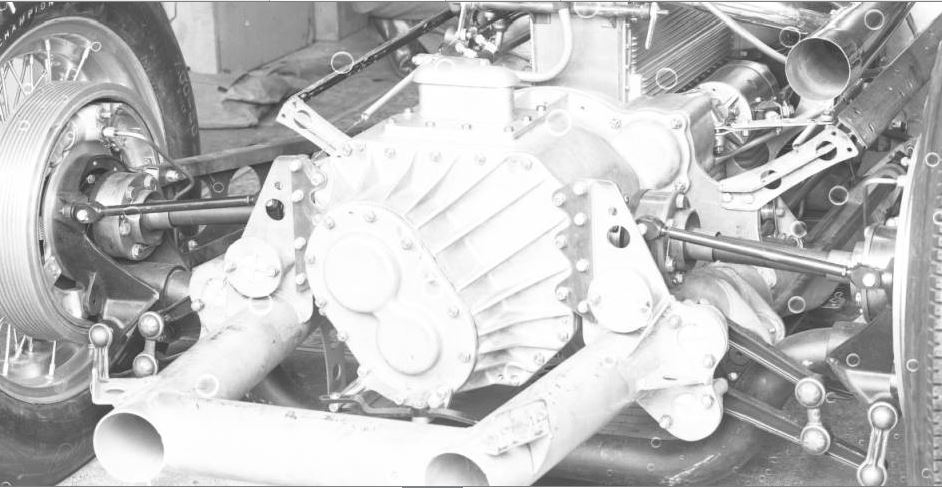

    Another car you should check out is the Lycoming Special from New Zealand.
    Because it has a lot of things you are talking about.
    It has a home built transaxle made out of a Studebaker gearbox and a early Ford V8 diff, and a DeDion using Jag parts.

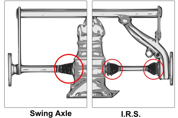

    Here is the later, single-CV Mercedes Benz low-pivot swing axle:
    The final drive tilts with the left-hand axle, so it's not much use with a transaxle.
    The great advantage of solid axles is that they maintain constant camber under all conditions except single-wheel bump. To a large extent the history of high-performance independent suspension has been that of attempts to get it to behave like an axle, without the shortcomings of an axle. You could say that a DeDion axle is the better part of the way there. And a lot of the early appeal was the ease with which ifs could be got to make the front end grip as badly as the rear, which isn't as crazy as it sounds.
    By the way, the 2CV's extreme roll angles come more from the famous umbrella-on-wheels/basket-of-eggs/ploughed-field brief than from the suspension's geometry. 2CV racers cut and thereby stiffen the springs drastically, resulting in much greater roll stiffness:
    The leading/trailing-arm suspension still gives camber gain equal to the roll angle, which isn't ideal.

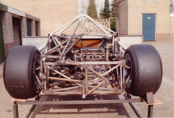

    I had one of those on a racecar I built out of what was left of an old Sports 2000 Lola.
    ( see pic.
    The DeDion was a separate spaceframe that wrapped around the engine & gearbox, and it was adjustable for camber, toe in/out, roll center, and the front pivot point was adjustable for height as well )

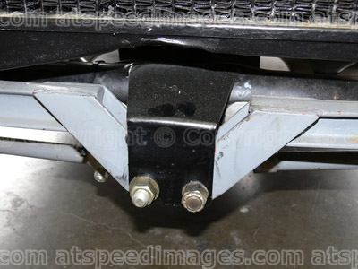

    Some of the inherent problems that the twin-I-beam Ford suspension design has is in the steering arrangement. The drag link is connected from the steering box to the right spindle and the connecting tie rod for the left wheel is attached to a point that is inline with the left axle pivot. A better way to go would be to use a center link with an idler arm and then attach the left tie rod to the right side inline with the left axle pivot and the right side inline with the right pivot. The hard part is getting them to cross without interfering with each other. This can be accomplished with careful bending of the tie rods.
    My dad and I used a 65 Ford truck with twin-I-beam to build his car on. We cut and dropped the frame in the middle so that essentially it would be the same as having the back of the frame on the ground. This gave it more king pin angle and it would corner quite well with the low CG and wide track along with the geometry change.
    For the rear design I have thought of using torque tube ends inboard and out board use the ball and knuckle from a Willys 4 wheel drive. To do this you would need to rotate the steering knuckles 90 degrees so that the trunion bearings are horizontal to the ground. You could then use the steering arm as an upper or lower link dependent on which way you wanted to go. To control the fore and aft movement and rotation of the outer knuckle you could use a rear bone off of an early Ford rear as it is not taking the torque of the rear but just the longitudinal force.
    This set up would give you a full floating design on the hub so that if an axle or half shaft broke you would not lose a wheel or suspension. The disadvantage is that it makes it hard to have inboard brakes. This can be overcome as well by using the brake design that a lot of tractors use and was used on Chrysler limos in the 50's.

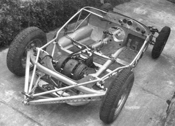

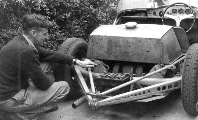

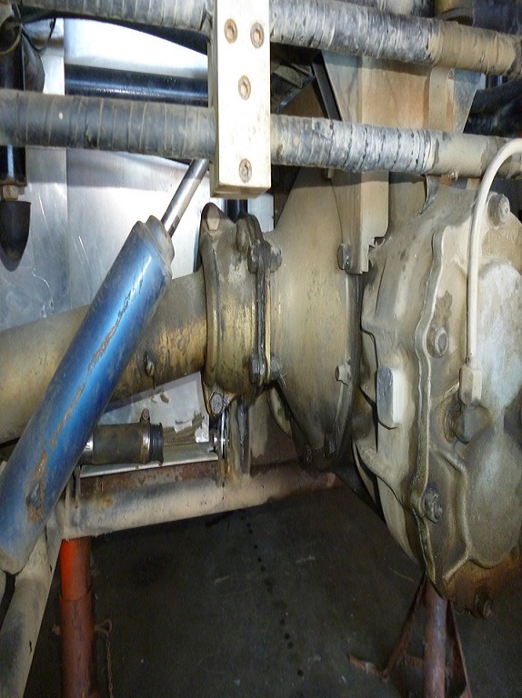

    I had the water tank out and thought you might like to see a picture of a rear end built 40 years ago to the Hop Up story. Note this car has seen plenty of p***es in the last 40 years and is not rusting into a heap like so many say P1010922.jpg
