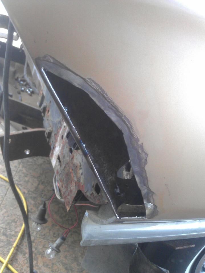

    Seeing as how I have the front end apart I decided I might as well fix the two small rusted ares in the front fender tips, I'm just going to blend the paint it shouldn't be very noticeable repair because of where it is.
    Cody Walls came over and we spent all day talking cars, what a swell guy he is.
