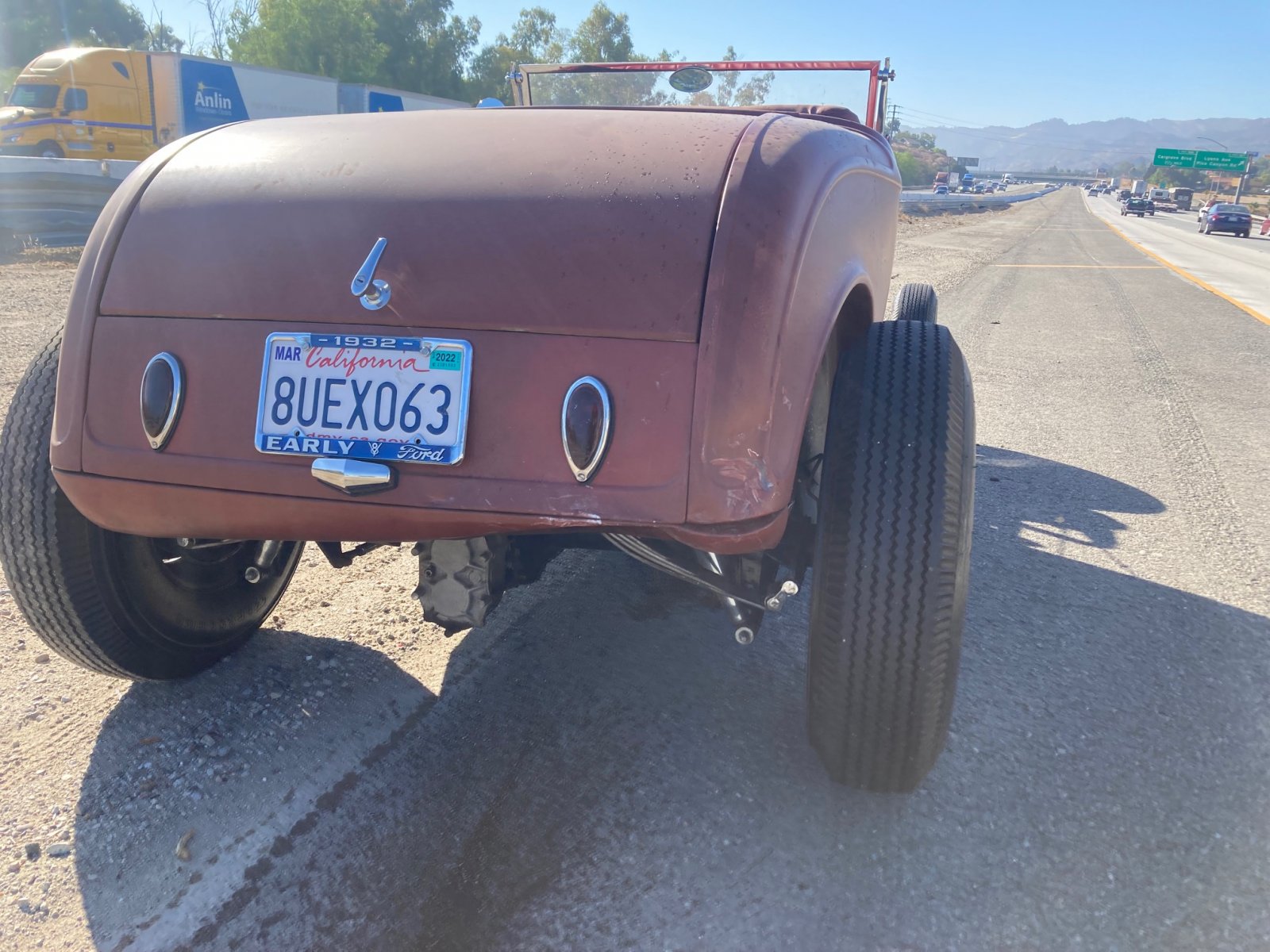

    I had made a few small changes, and was about to make a couple more on Friday, then was going to drive the car to the Ventura Nationals on Saturday. The universe had other plans.
    I was cruising at about 70 mph on the freeway when suddenly a rod decided to leave my engine. There was no warning, no weird sounds. The car was running great till in an instant, it wasn't. The engine immediately locked up and sent me sideways. As I went sideways my p***enger side frame horn took out the hubcap and tire of the car next to me, and peeled back said frame horn. I continued spinning to do a full 360 and ended up facing the correct direction in the number 1 lane. When I was straight enough in the right direction I had pushed in the clutch to try to get to the shoulder, but couldn’t get there fast enough and the car behind me couldn’t stop fast enough, and rear ended me.
    I saw the car that hit me before I saw the back of my car, so I thought the damage was going to be much worse. The car looks pretty fixable, and most importantly everyone is ok. It could have been much worse, so I'm glad it wasn't. But, at the same time, this roadster was my getaway/therapy for dealing with the garage burning down, so it's kind of another punch to the gut. However, just like the garage, it is what it is, so I've got to just push ahead.
    So, the plan is to go through the insurance process and start repairs as soon as I can. Hopefully the garage building process will be happening soon and I'll have a good place to work on it.
    As for the engine, due to how things are going in normal life, and the garage process, money is a little tight, so I can't afford to build another flathead. I do have a Cadillac 331 that is apart, but was free, and I have made a deal on a Cadillac 390 before this happened that came out of a running car. So the next version will almost certainly be running one of those.
    That's it for now in my saga. Hopefully it won't be terribly long before I can update this thread with something positive.
    Here are some photos of the aftermath. The last photo is the car that rear ended me.

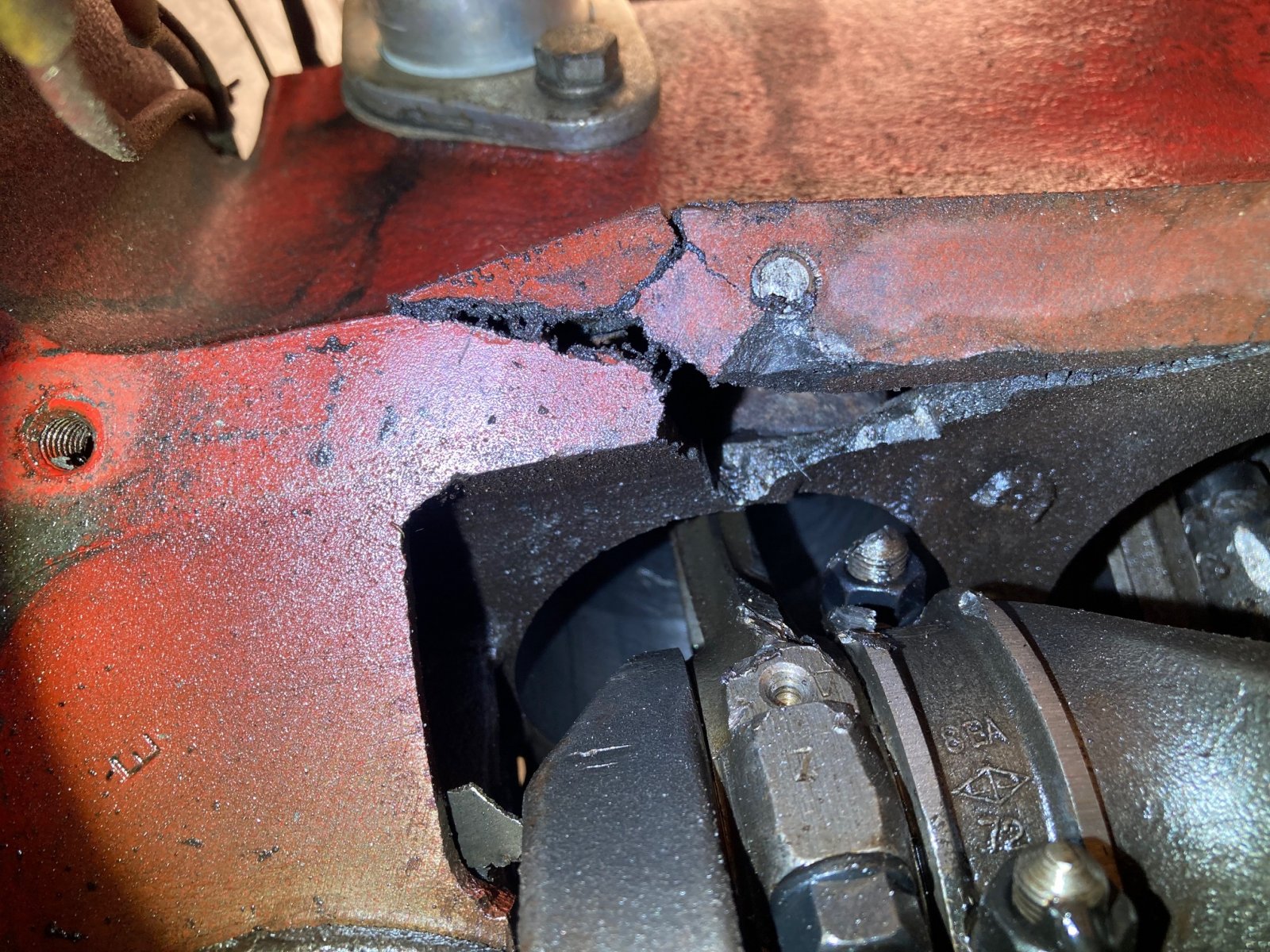

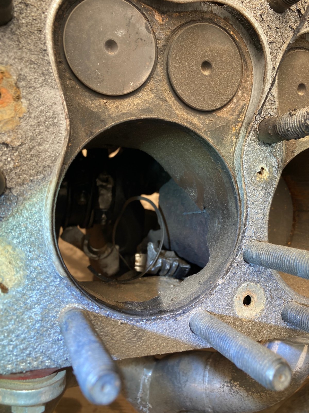

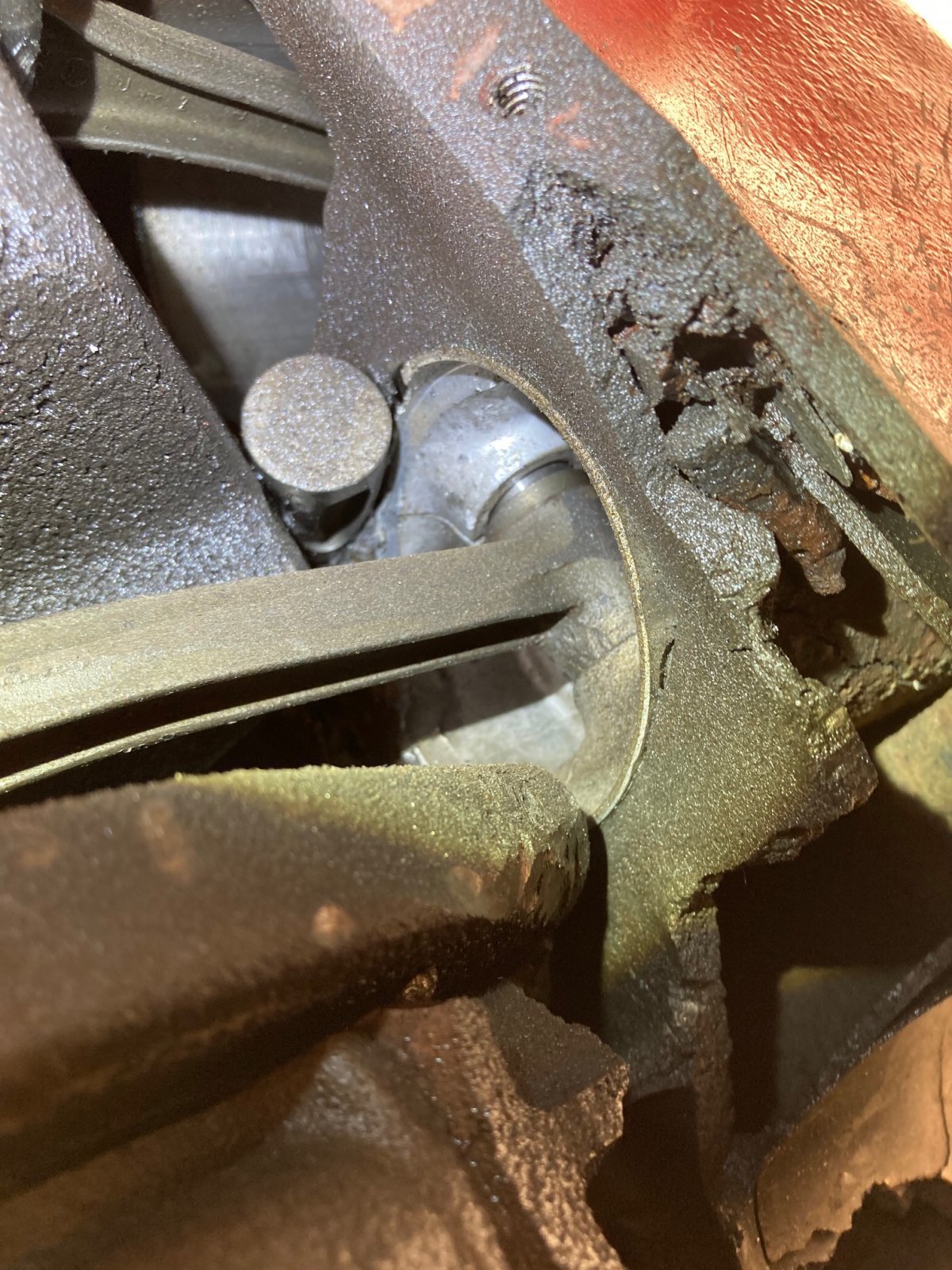

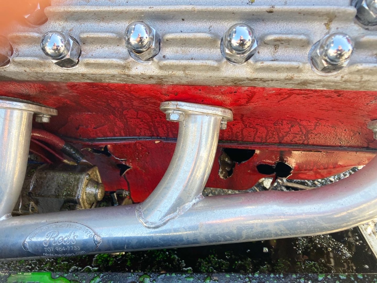

    I finally had the chance to dig into the flathead a little bit to try to see what went wrong. I pulled the pan, and there was just about everything that you would not want to see in an oil pan in there. Then I pulled the intake and heads. Cylinder #7 was almost completely gone. Next, I pulled all the shrapnel out of the pan to look it all over. My best guess is that there was a cylinder wall failure.
    The engine had a significant bore at .125" over. I also realized that cylinders #7 & #8 were both sleeved. There is also a crack on the inside of the block side on cylinder #8, but I'm not sure if that happened after #7 let go.
    It would seem to me that the wall failed, let the piston loose, and things just came apart. The piston is obliterated, but the rod is still there, and moved over to cylinder #3. The cam broke into at least 5 pieces, so some lifters fell, and one got jammed up on the piston on cylinder #2.
    A bunch of the block is busted up, and the center of the center main cap busted out too.
    So, it was quite the event.
    Unfortunately, the fact that I still don't have a garage back makes the possibility of getting the car repaired quite difficult. I wanted to try to get it into a friends shop, or to work, but both of them are too packed for me to fit right now. Hopefully I can get it and my garage situation figured out soon.
    Here are some photos of the carnage.

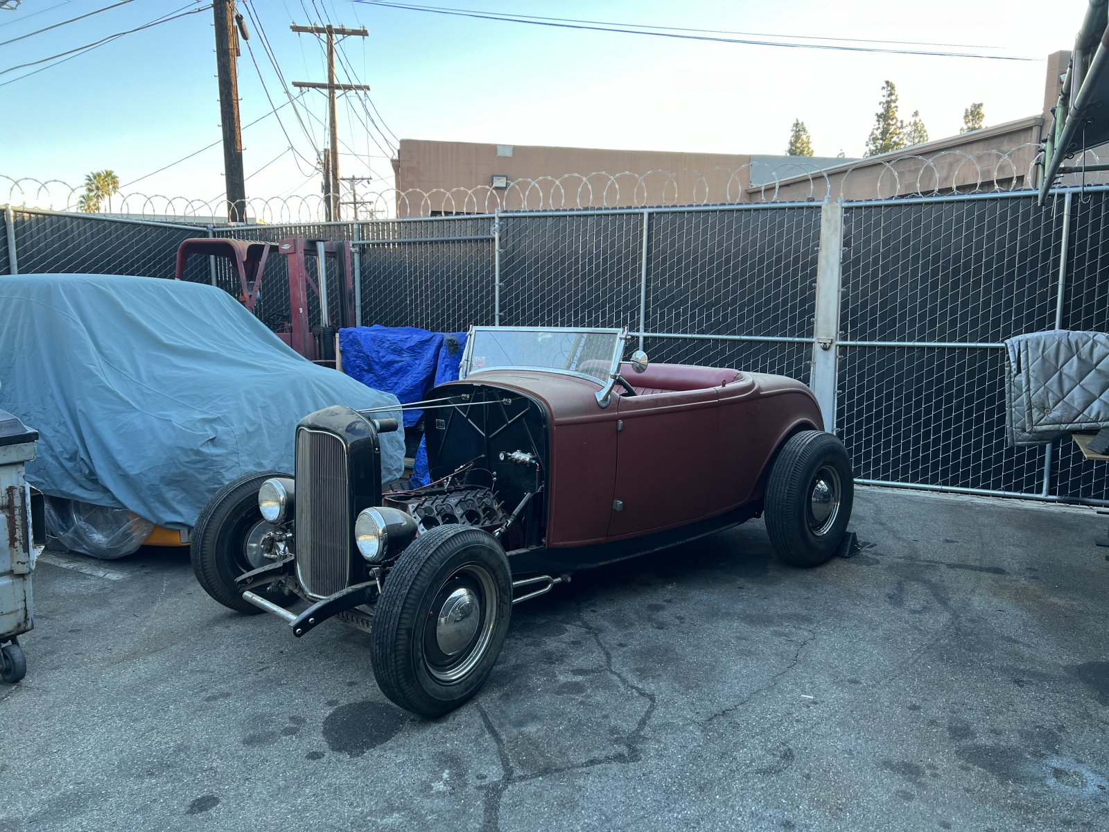

    Sadly, I don't have any progress to report. Since I am in the permit process for my garage, obviously, no construction has started. No garage has made repairs a bit challenging.
    However, Troy was kind enough to clear a spot at the shop for me so I can work on repairing it there in the meantime.
    So, on Sunday, I was finally able to get the roadster over there. I'm sure I won't be able to get anything done on it till after GNRS, but at least it's there, and will be ready to work on in February.
    I'm looking forward to getting started on version 2 of this car. Hopefully, I'll be able to get it back on the road for spring. And hopefully, it won't be too much longer before the car has a new home back on my property.
