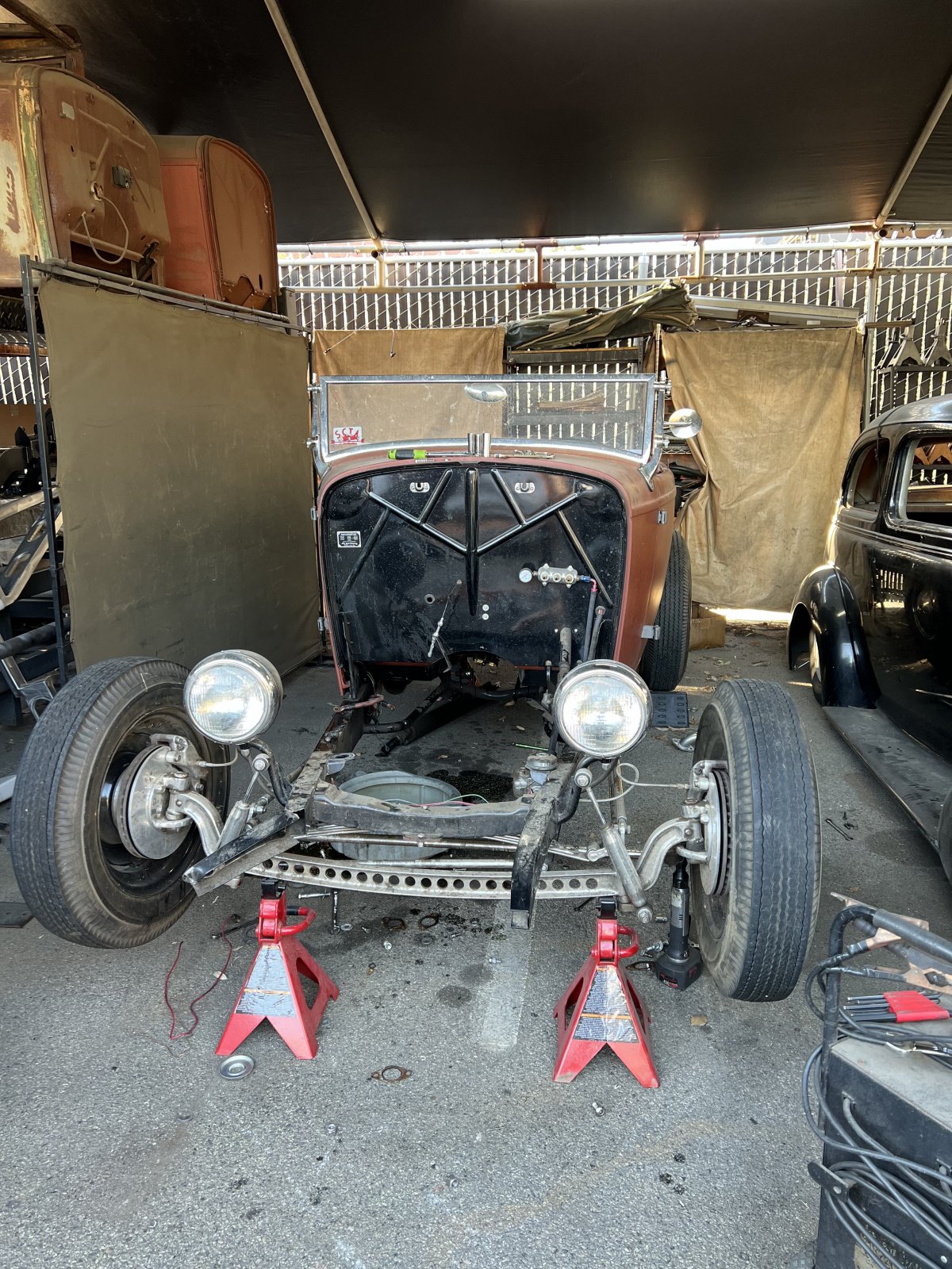

    I've made some more progress on the roadster this weekend.
    I hadn't planned on working on it this weekend because my trans adapter doesn't come in till Monday, but the insurance adjuster wants to look at the frame on Wednesday. So I went in today to get the body off the frame, which went smoother and quicker than I expected, so that was nice.
    While I was at it I also pulled apart the old engine to keep the parts that were still good, and to grab a couple souvenirs. With everything out of the way, you can really see how damaged this block really is.
    IMG_3868.jpg F11065DD-1DE8-420A-9EDA-181ABB280452.JPG FD326C20-2CD5-4365-83B6-7AA526166E42.JPG
    Since I was removing the body, I had to remove the roll pan as well, I'm going to keep it as a wall hanger. It somehow looks more damaged when it's off of the car.
    So, I'll bring my new block to the shop on Tuesday, and hopefully this weekend, get it bolted to the trans and get the new engine mounted in the ch***is.

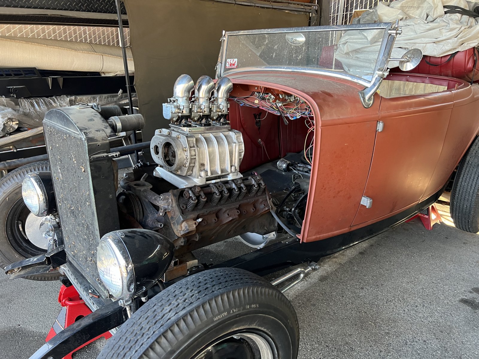

    So, I have started mocking up the new engine to the car, so that I can start on new engine mounts.
    But, then I mocked this up and started thinking about this. This complicates things, but would be awesome! What are the HAMB's opinions? Blow or not to blow? I'm doing some serious contemplating. IMG_3982.jpg

  13. Stogy
    Joined: Feb 10, 2007
    Posts: 27,213
    Stogy
    Either way is awesome...the bay is sure utilized fully and then some with plan B...honestly, a tough decision...

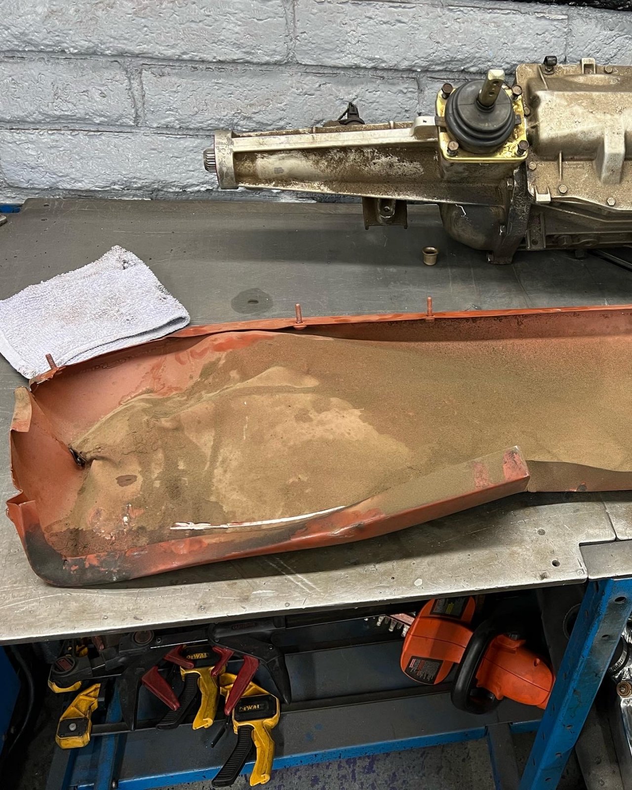

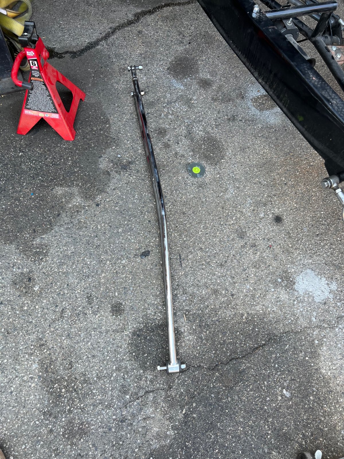

    Well, I haven't made as much progress on the car as I would like due to reasons I won't bore you with.
    I decided against the blower because it would have introduced alot of work in order to get things the way I wanted. Since this car was never intended to be a project, I decided it wasn't the right decision. I do still dream about it though.
    However, I have made some progress. I got the motor mount parts made and tacked together (unfortunately, they got a little wet and rusted a little already). Got the trans mount made and tacked in.
    Luckily just around the time of the accident, we were building a '32 roadster for a customer with pinched rails, and bobbed frame horns, so I saved the frame horns, and used one to repair my frame.
    I removed the bent ladder bar, and shackles. I had some of the So Cal ladder bars with the forged gussets, but they were shorter than the ones on the car. So, I lengthened them and got them installed. I sill need to do some sanding on the ladder bars, so I didn't take a photo of how I lengthened them yet. I'm going to finish the sanding once I blow the frame back apart for re-powdercoating.
    Then got the body set back on the frame. The next things on the agenda are to make a new trans tunnel for the raised up engine and trans, remount and maybe adjust steering column position, and fab headers and exhaust. Then I will blow apart the frame, and get it out to powdercoating.
    While it's at powdercoating, I'll work on the sheetmetal repair, and some slight changes.
    The engine that is in the car is an extra one I'm borrowing for mock-up. The real engine is at the machine shop, so hopefully I won't have to wait on it and when they are done I can ***emble it, paint it, and drop it in. Also, that injection that's on there isn't going on this car. Just there for fun, but there are big future plans for it.
    Hopefully it won't be long till there is another update!
    (I have my front wheels bolted on the back so I could fit under the stand the body was on)

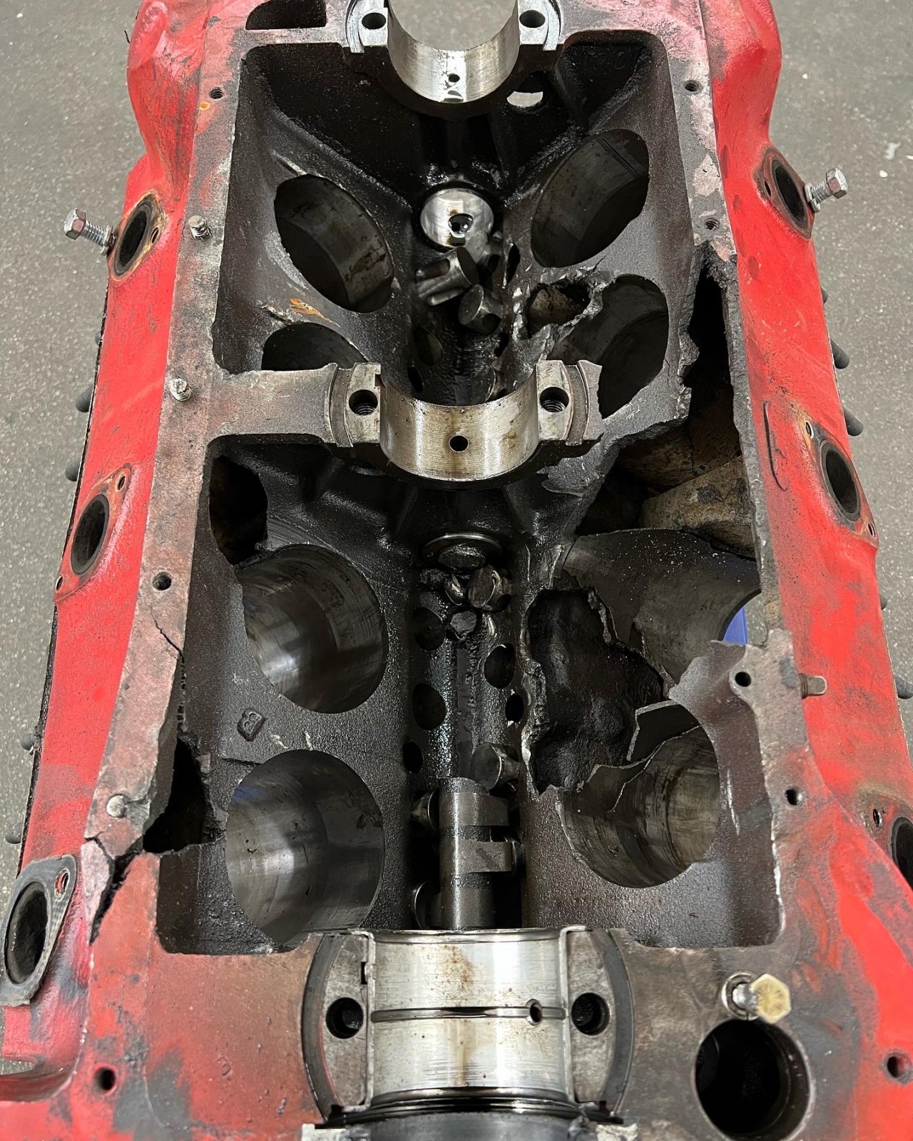

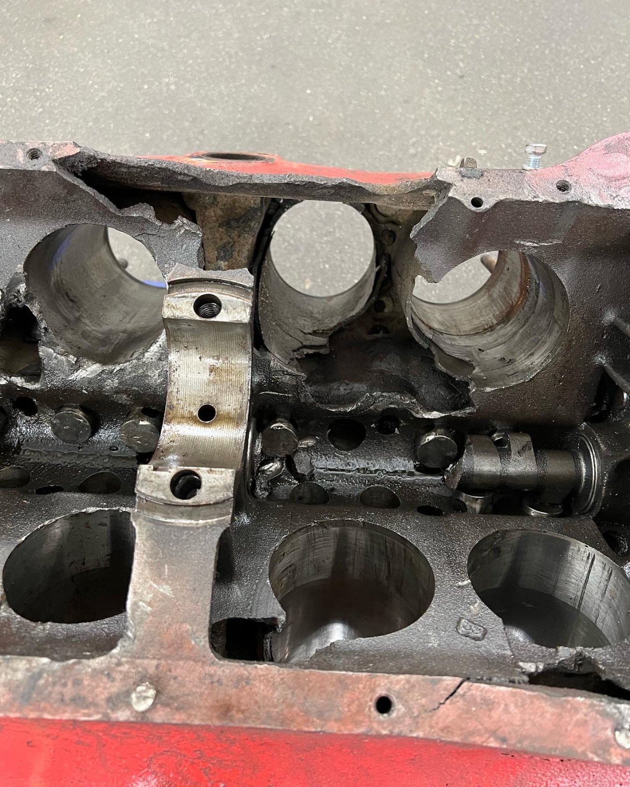

    Sorry to see your bad run of luck, can you ascertain what started all of that engine carnage?
    Did I see a couple of very thin cylinder sleeves ...... what did the crankshaft look like.
    Stogy and cretin like this.
  20. cretin
    Joined: Oct 10, 2006
    Posts: 3,059
    cretin
    I'm looking forward to that day!
    Thank you.
    I'm not real sure, as it was just flathead soup in there.
    Yes, you did see a couple og thin sleeves. The engine was bored .125 over, and the cylinder that let go was one of the 2 sleeved cylinders. The thin sleeves did lead to a theory that a cylinder wall let go, but I'm not sure.
    The crankshaft looked fine, although I did not save it. One main cap broke free from its bolts, and another one was cracked, so I thought there was a good chance it got bent.

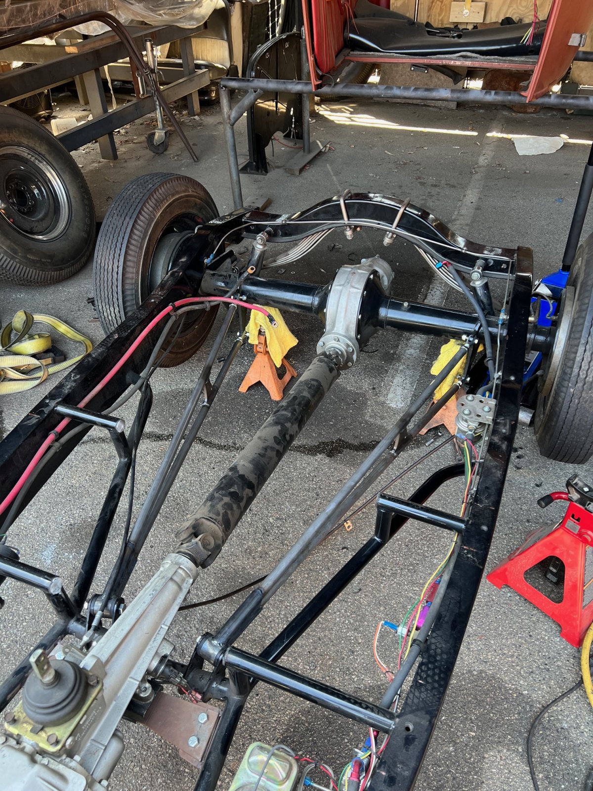

  21. cretin
    Posts: 3,059
    cretin

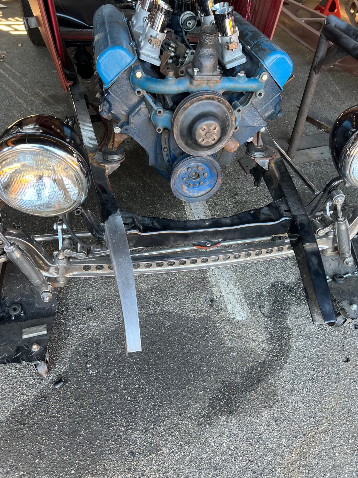

    I got a little more roadster time in after work last night. The photos aren't that exciting because there really is no visual change. When I initially placed the engine, I bolted the engine and trans together, and put the trans mount back in the original location.
    After moving forward, and considering a few other things, I decided it would be beneficial to move my engine forward an inch.
    It's not that fun of a job to do when you already have a fully ***embled engine and trans sitting in place, but it helped me out a bit in multiple ways, so I bit the bullet and pulled out the cherry picker.
    I just had the mounts tacked on, so it wasn't a huge deal to do, just felt a bit like going backwards.
    Anyway, I got the mounts cut off the frame, and tacked in their new location, and then placed the engine in its new location. I then got the body situated back into place. With the engine swap, I had to raise the engine and trans a bit from where the flathead sat, so now the trans output shaft housing hits the floor a little bit. Trimmed around that, and got the body sitting properly. Then I mocked up the radiator and checked that I was happy with the engine position, which I am.
    At about this time I had been in a 95 degree shop for 12 and a half hours and was getting a little tired of it. So, I decided to call it a day, but I had to do one more thing.
    For some reason this car has always wanted a hood to me, I'm not sure why, I just always felt that way about it. Plus, I got a hood for free. I don't want to run a hood all the time, but I want the option. So I decided I would mock up the hood and see what clearance from the front exhaust ports to the head looked like. It's a little close, but I think I can fit a header in there.
    And, don't worry, the hood sides will get louvered. It looks pretty street roddy with the smooth sides.
    I also dropped by the machine shop, and they have started on my engine machine work. Heads have been surfaced, and they are about to put in hardened valve seats.
    Here are a couple photos after moving the engine and mocking up the hood. These photos also show the actual intake I will be using, Edlebrock 4x2.
