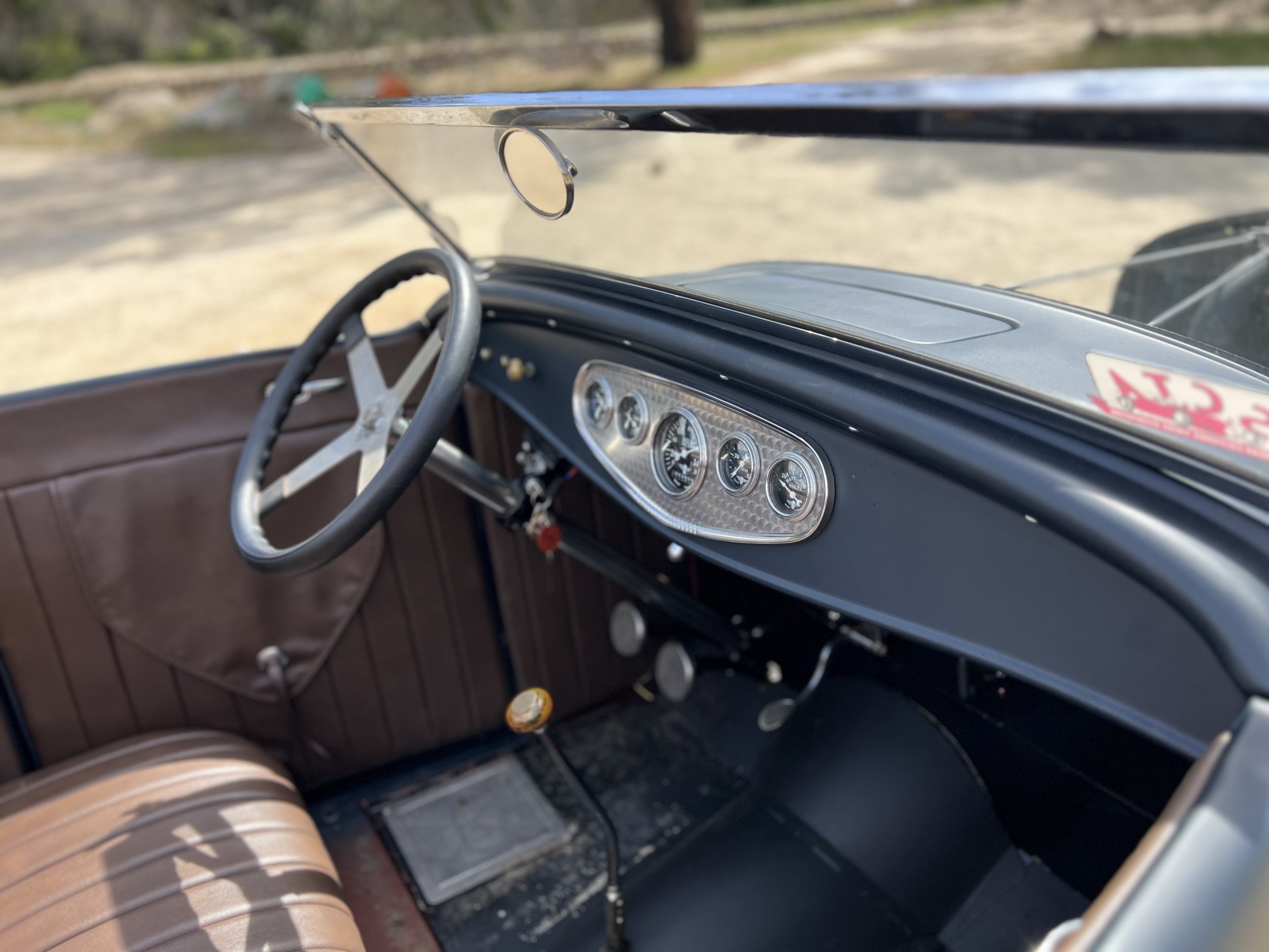

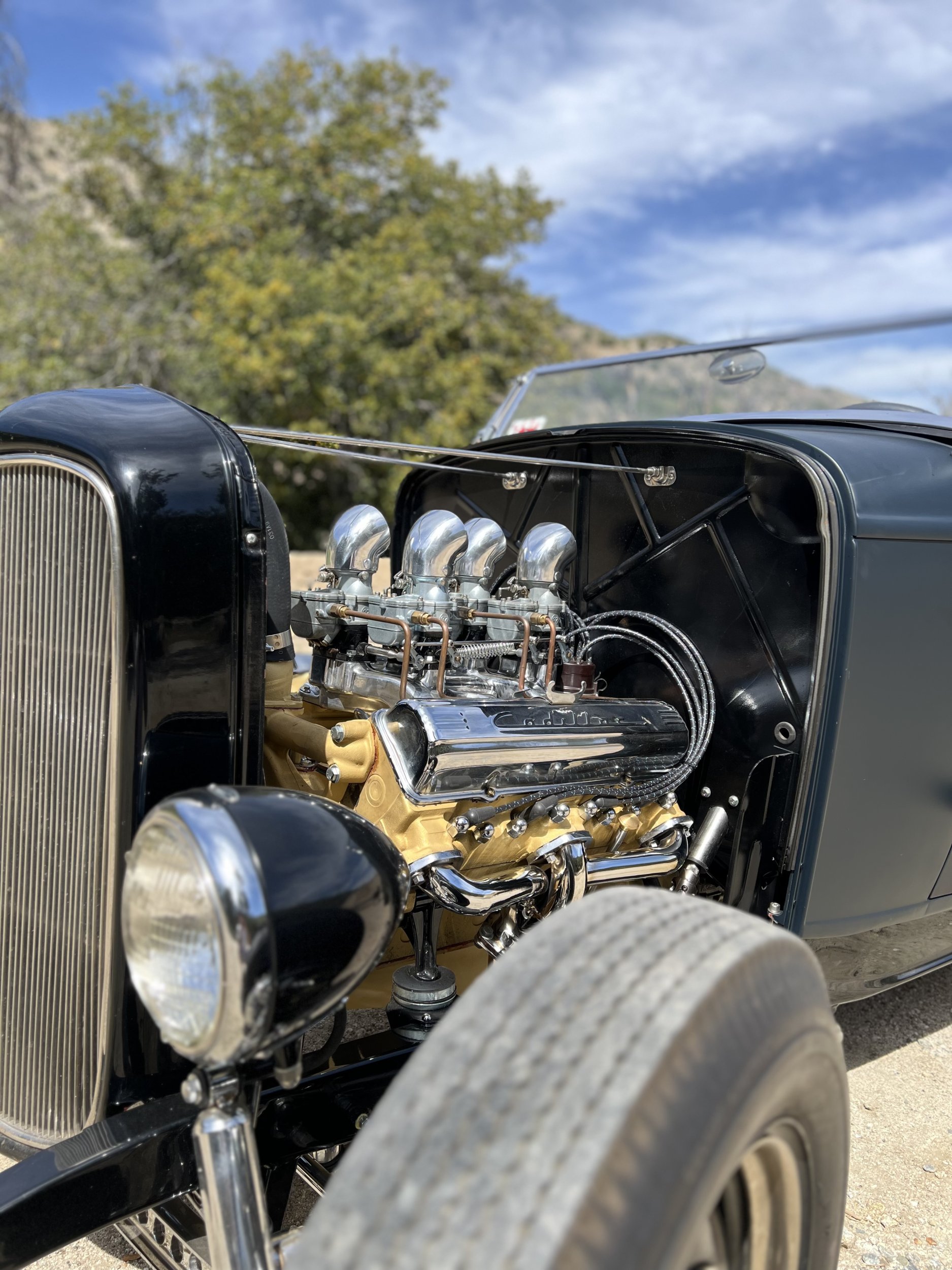

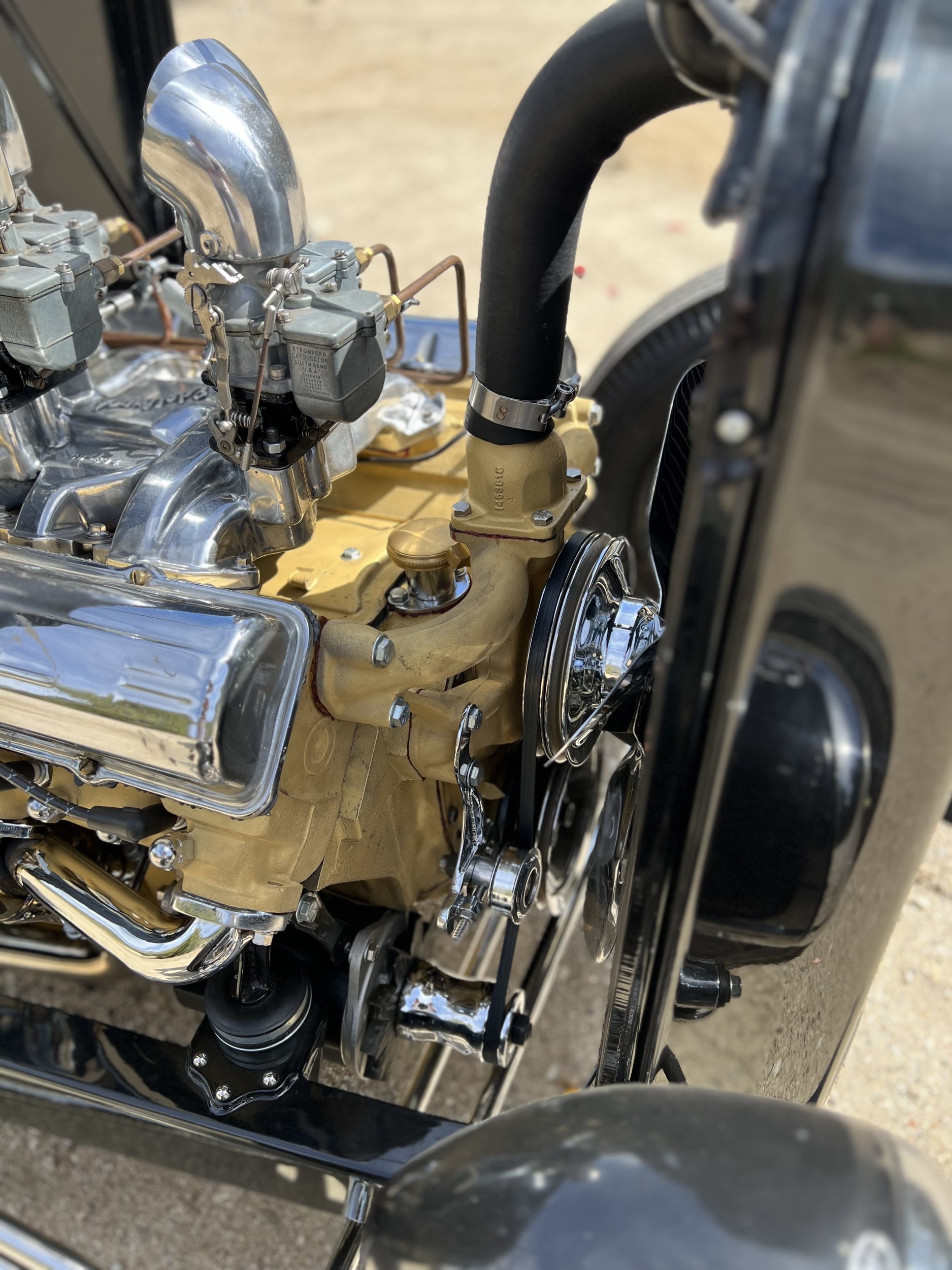

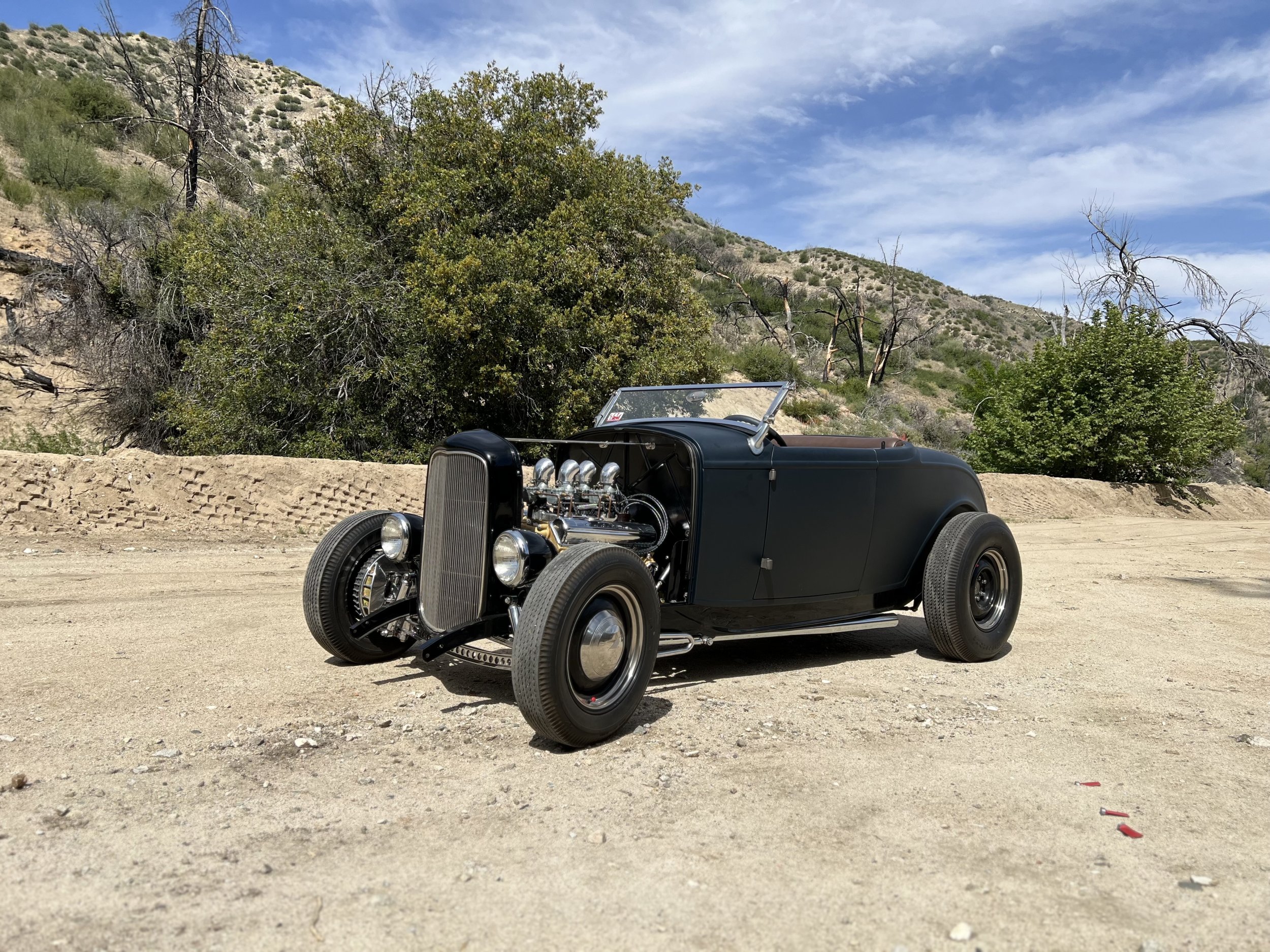

    Hey guys, It's been a while since I've been here, but I finally have a reason to post something.
    I finally started hitting the car hard, and I got it running.
    I took it to our local show on Saturday, but it still needs a few things to be road ready (and road legal)
    but it was really nice to get the car out again. Been way too long.
    Anyway, here are some photos of the new version.
    IMG_8217.jpg IMG_8218.jpg IMG_8219.jpg IMG_8228.jpg IMG_8223.jpg IMG_8220.jpg IMG_8222.jpg IMG_8225.jpg IMG_8226.jpg IMG_8227.jpg IMG_8221.jpg IMG_8230.jpg IMG_8206.jpg IMG_8201.jpg
    brEad, teach'm, lurker mick and 11 others like this.
