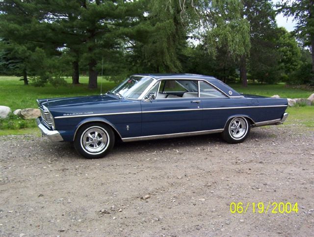

    Here's a pic of my '65. Also equipped with 352, 4 barrel and duals.
    I believe the stainless beltline trim was a dealer installed option, it doesn't appear in any picture in the '65 sales brochure. Mine came with fender skirts in the trunk too, I don't like the look and have never used them.
    I don't think there are any inherent front end problems. In fact Nascar has run the same basic design for years. Mine has 97K miles, I did replace the upper control arm bushings, a couple ball joints and the sway bar links. With a good alignment it drives straight and true.
    Do check the frame for rust, I had to have one small area of mine repaired.
    A worthwhile upgrade is to a dual reservoir master cylinder. Order a master for a '67 Galaxie with the same brake system (power or manual). I just did mine and it was pretty simple with a little replumbing.

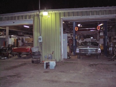

  7. Yeah, that is a 65.
    I have three...well two, sold the white ragtop at Jefferson last weekend.
    Here is a photo of when I pulled all into the shop to avoid some hail a few weeks ago.
    Two converts, both 352 auto 500's and one XL hardtop 4 speed car.
    All nice.
    I have a super nice 64 hardtop also and a few parts cars in the 64/66 vintage.
    Love the 63-66 Galaxie!!!
