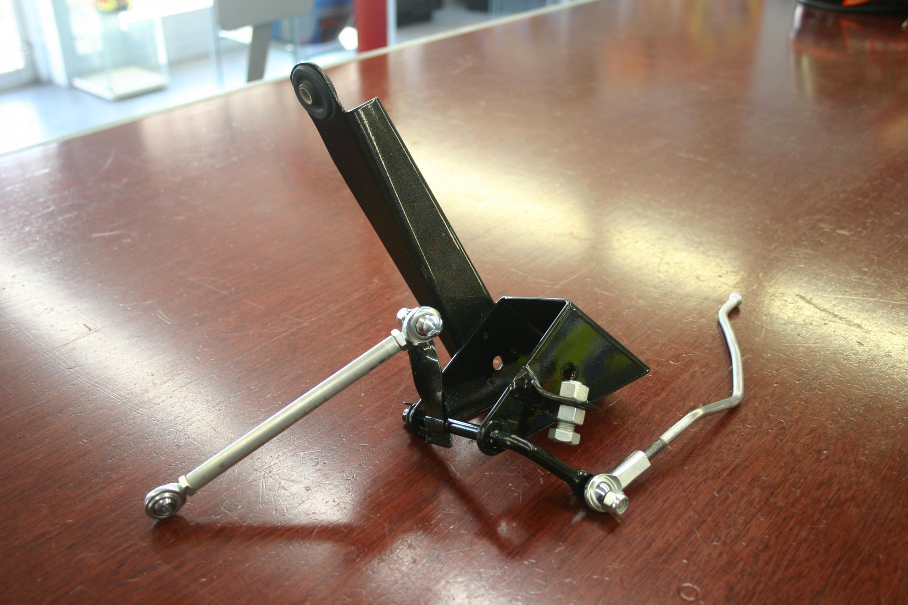

    Car drives OK stops on a dime. (really good brakes, Someone spent some money here) The throttle linkage was shot. The holes for the bent rods were wallowed out and one of the sections would go too far so the pedal would be hard to press for the first 1/4 of travel with no carburetor response until it passed a certain point where it freed up and you would give it too much gas. It was very hard to drive smooth with the strait drive. I was going to weld the holes and re drill them until I thought about remaking the linkage with rod ends. I also put a positive throttle stop so when you give it gas the carburetor responds as soon as the pedal moves with no wasted motion. It keeps one lever from passing the fulcrum point. ( I thinks thats what it is called) So a day or so I have the assembly rebuilt and base coated and cleared. Cool thing was I was able to paint it on the company's dime the bad thing is its my company. HA

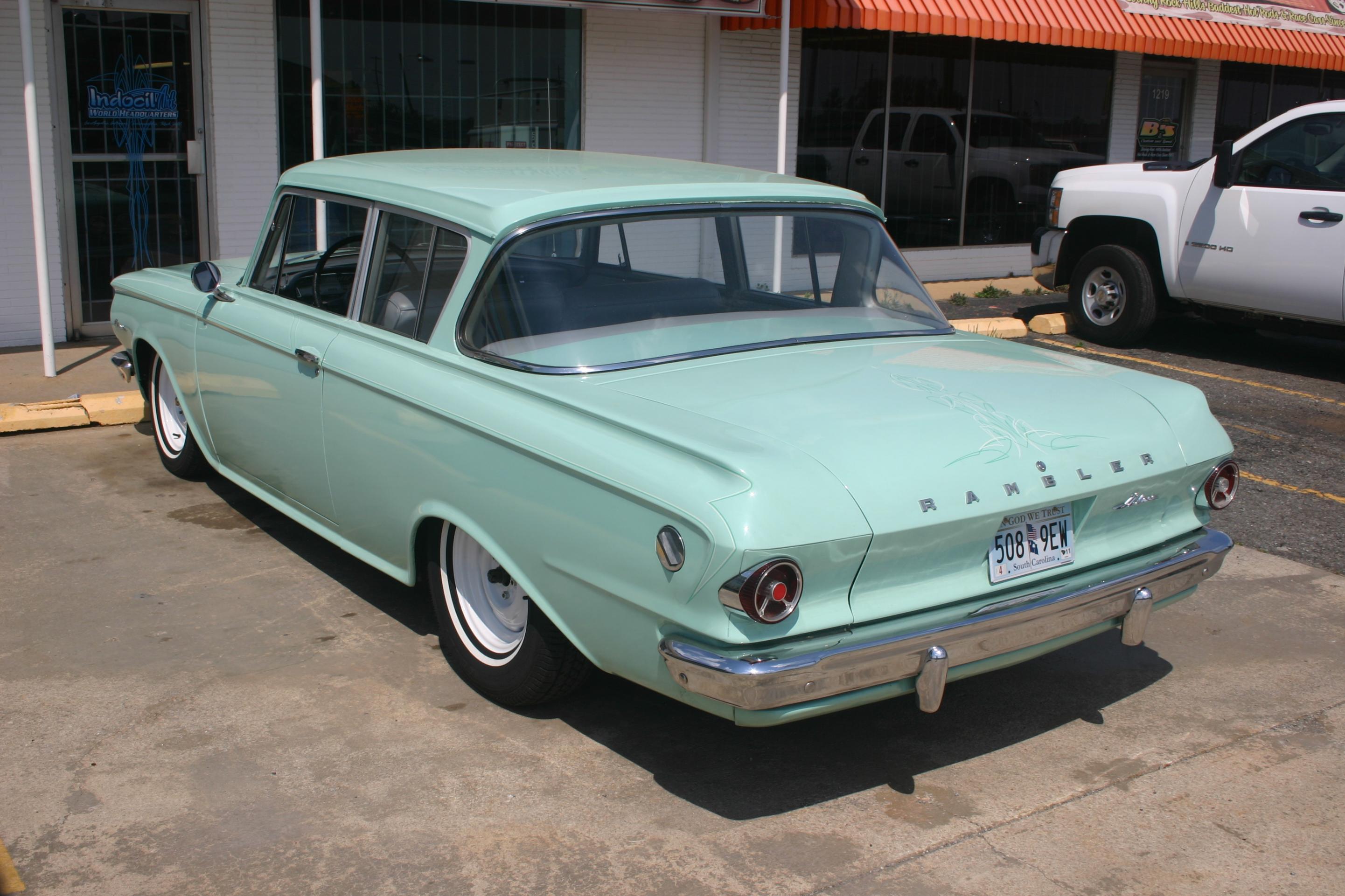

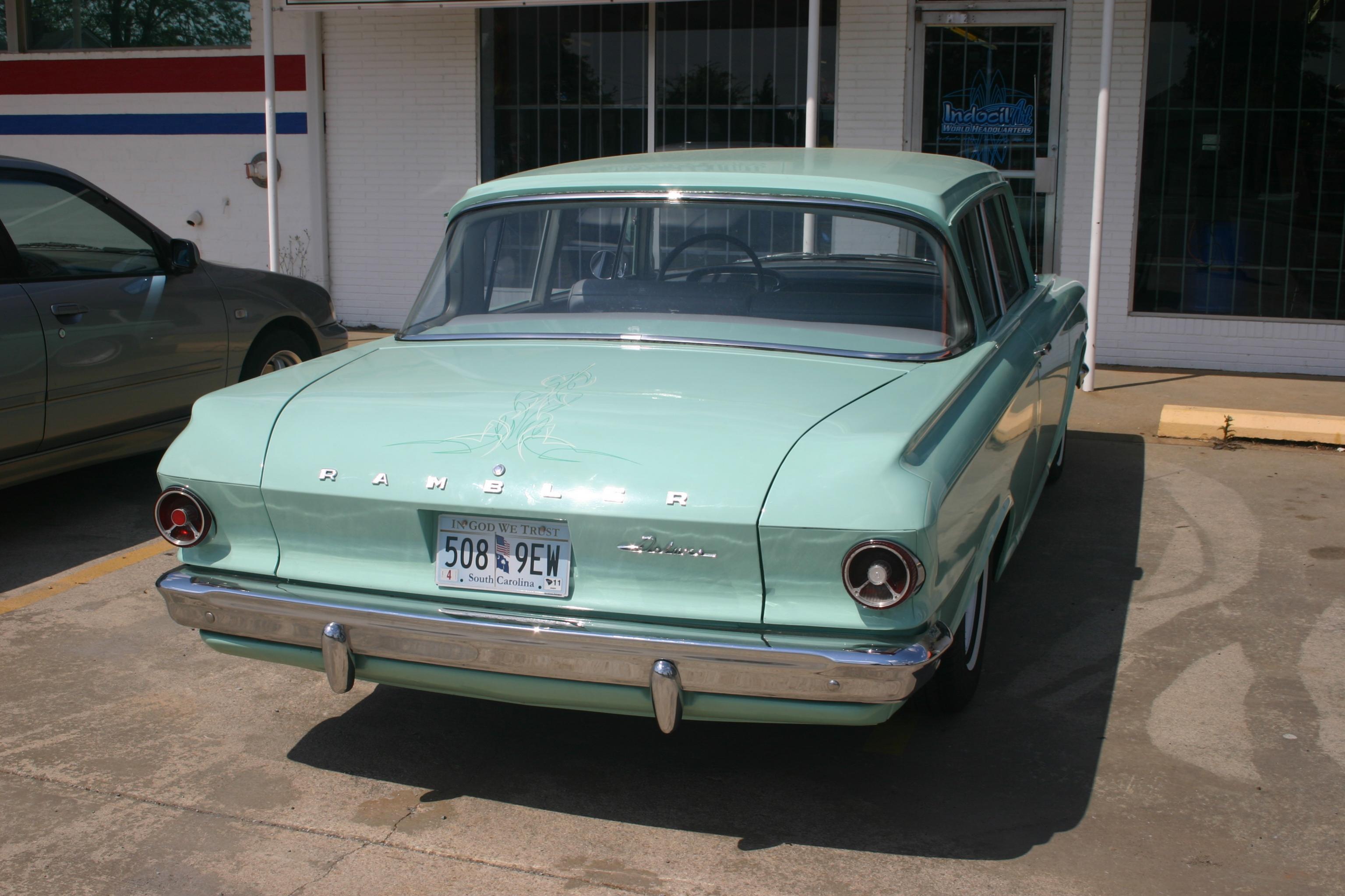

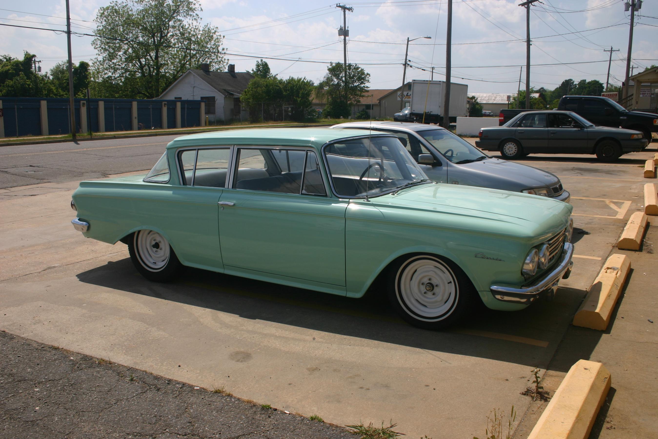

    OK, Took the car out for the first ride! I only have pictures of it at driving ride height because I don't have a compressor or valving done. I am just using shrader valves until I can do the rest. Drove very well. I am thinking of painting the wheels silver to match the interior and add a cool trim ring. I may go with a small white stripe instead of wide whites. I will keep you posted. Kids love it by the way

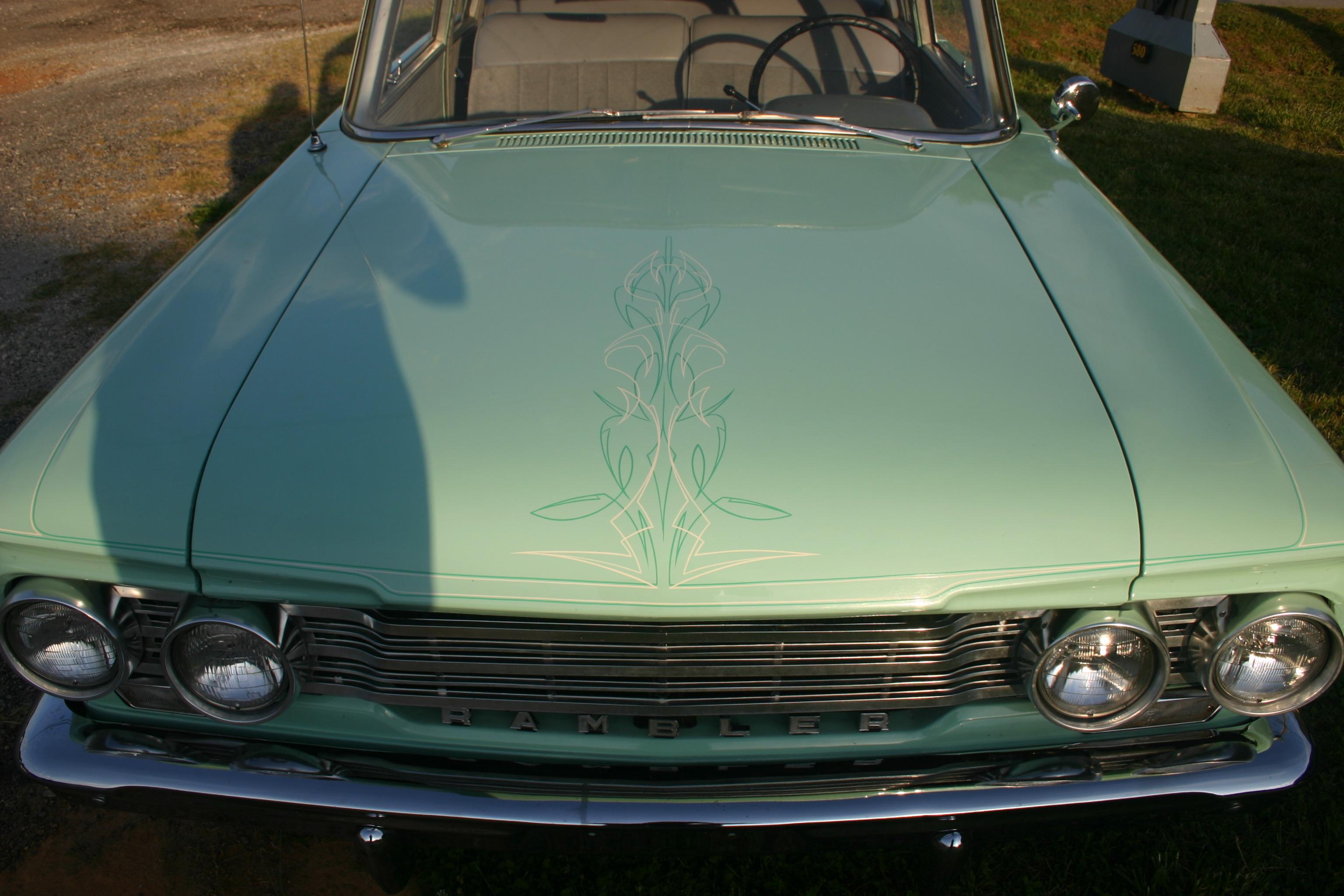

    One of my good friends Paul Quinn helped me stripe it this weekend at a panel jam in SC. He did the sides and I did the hood and trunk. I think it is getting its own unique look. Slowly but surely.

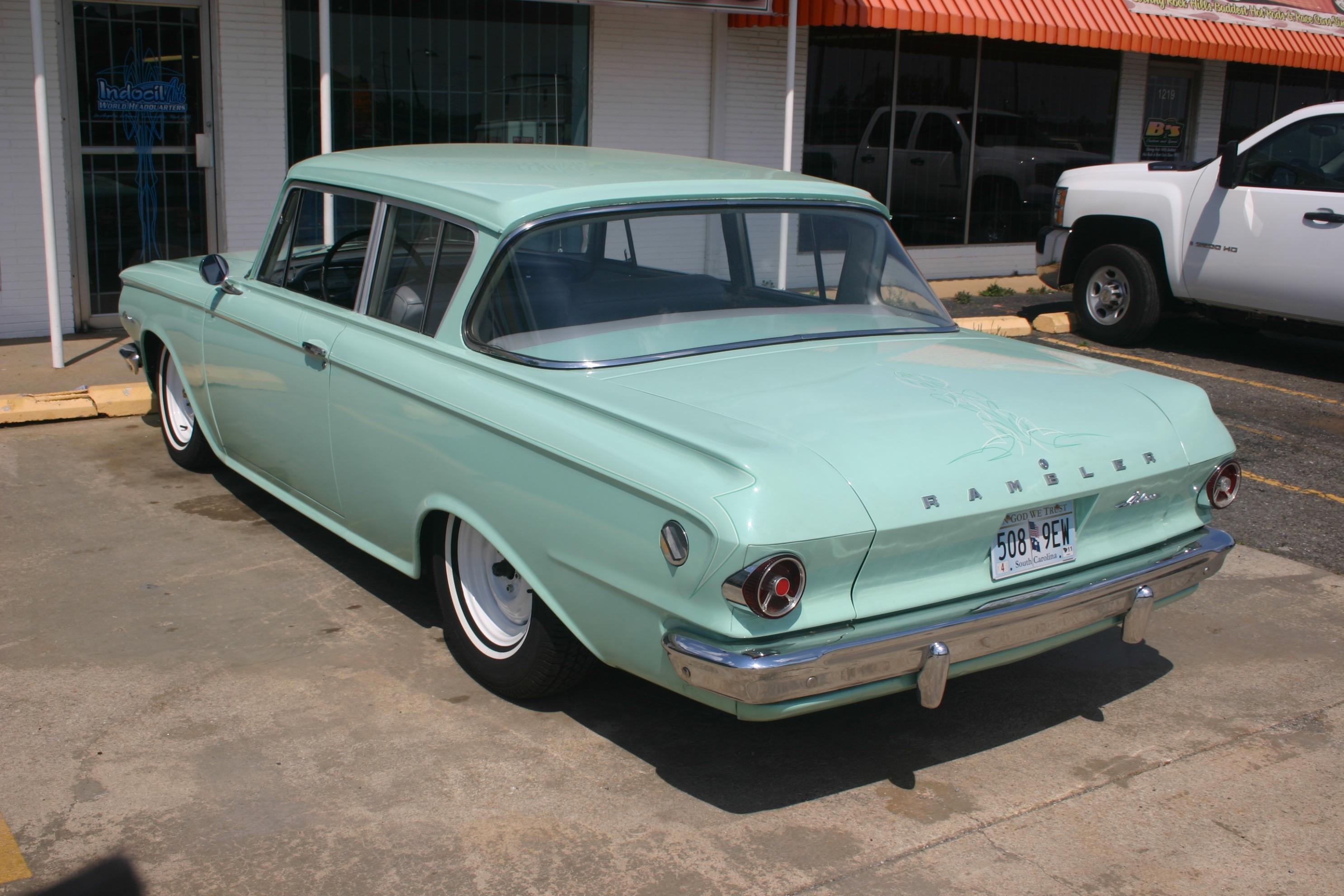

    New Shoes! New Shoes! Powder coated the wheels white and put new new tires on them.
